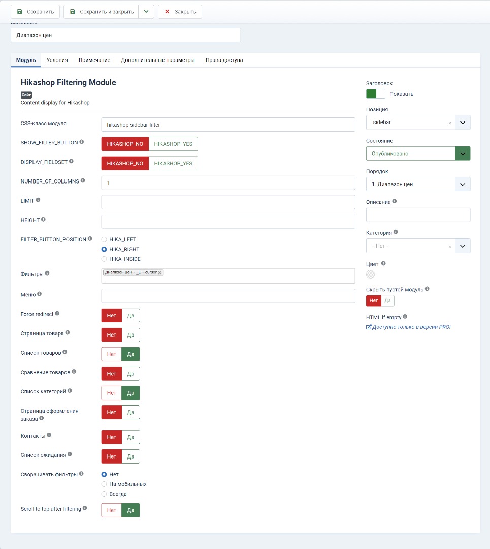

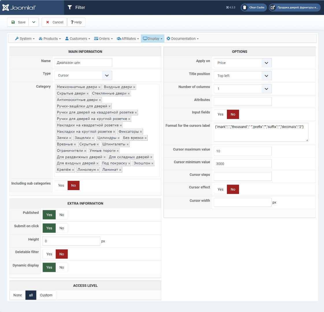

Hello, there was a problem with the price filter, it does not work correctly. Could you point out what I've set up wrong? How to make it so that it is filtered directly in the category where I am?
Here are the settings:

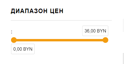

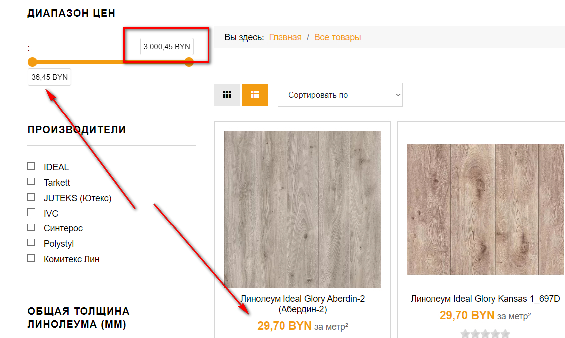

The price filter does not work. If you filter by price, it uses only one price for the filter. Try changing the values. ilsanmarket.by/katalog/linoleum.html
It doesn't even display correctly:

Ok, on that page I do see a problem indeed. The filtering is working, but the min and max values of the filter are wonky for some reason.

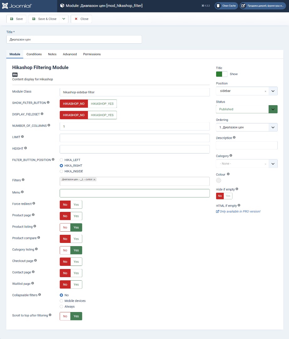

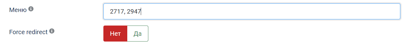

Hello, is it possible to display menu items in the module settings separated by commas?
I tried to enter one menu item and several separated by commas, it still does not work

Regarding the "menu" setting of the filter module, you can only enter the id of one menu item.
Also, it will only be used when the current page is not a products listing, or, if you have the "force redirect" setting below activated, it will also redirect to that menu item if the current menu item is not the one with that id.

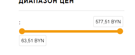

Hello. I noticed this problem in the section: ilsanmarket.by/katalog/mezhkomnatnye-dveri.html
Having moved to another section, for some reason the countdown of ideas is already from “0”

I'm sorry but I don't see any problem on your links. Could you explain what problem you're seeing there ?
And what is the link with the new screenshot of the filter module settings ?

Hello. I wanted to clarify why in this category the filter starts with the minimum price of the product, and in another category it starts with “0”?

Doesn't that mean that you have a product without a price set in it ?
The system will load the price of each product on the listing to calculate the minimum and maximum.
It could be that the product doesn't have prices (for example, if you only set the price of that product in the different variants).
