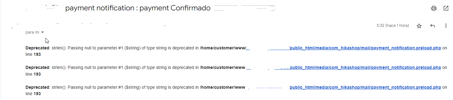

-- Error-message(debug-mod must be tuned on) -- : Deprecated: strlen(): Passing null to parameter #1 ($string) of type string is deprecated in /home/customer/www/domain.es/public_html/media/com_hikashop/mail/payment_notification.preload.php on line 193
Hi.
A few days ago I updated my site's PHP to version 8.1.22.
Since then I have detected errors in the customer address fields, as well as in the payment confirmation emails.

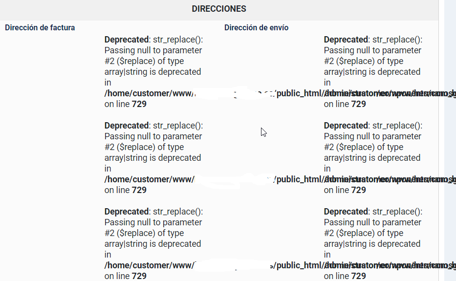

I attach a screenshot of errors.

For the first screenshot, change the line:
if(empty($item->$namekey) && !strlen($item->$namekey)) continue;
to:
if(empty($item->$namekey) && !strlen((string)$item->$namekey)) continue;
in the file media/com_hikashop/mail/payment_notification.preload.php and it will remove these.
We'll add the change on our end for the next version.
Regarding the other screenshot, I don't see the file path in full in your screenshot, so I can't say what to do.
Could you please provide the full path where the deprecated message happens, like you did for the other deprecated message in the email ?

/home/customer/www/domain.es/public_html/administrator/components/com_hikashop/classes/address.php on line 698
(in address - front)
  • Posts: 457
  • Thank you received: 19
2 years 11 months ago #354882
Another URL with error.
/home/customer/www/domain.es/public_html/administrator/components/com_hikashop/classes/address.php on line 729

In the file administrator/components/com_hikashop/classes/address.php search for the code:
str_replace('{'.$fieldname.'}',
you'll find it on 3 places. In each place, add
(string)
just after it to get:
str_replace('{'.$fieldname.'}',(string)
and it will remove these deprecated messages.
We'll add the changes on our end too for the next version.
PS: note that these are not errors. They are messages for developers to update their code for future versions of PHP.
Normally, these deprecated messages shouldn't appear on a live website. So that means that you probably want to check with your hosting why these are being displayed and how to not have deprecated messages.
