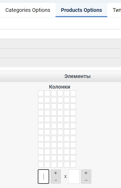

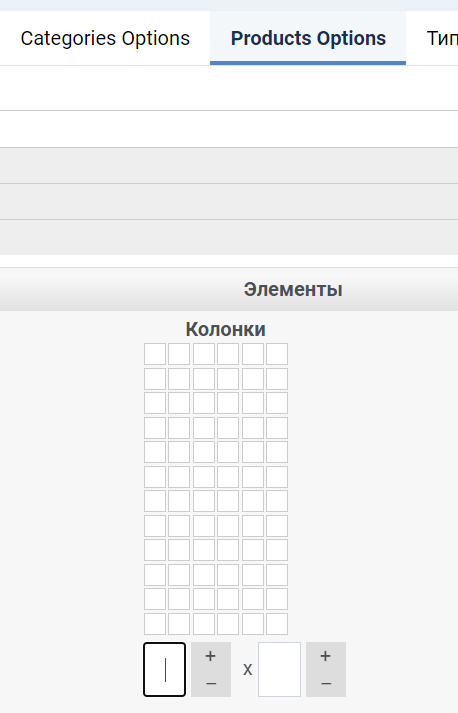

Hello, I wanted to make sure that by clicking to display all products, only categories would be displayed, without products.
In the menu item settings I made it as in the screenshot:

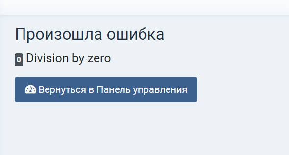

After this, the menu item stopped working, now there is this error:
Tell me how to fix it?

Instead of this setting (that can work) provide us these elements (via screenshot) :
- Your Categories Options settings
- Your Products Options settings
- Precise In Details tab, your "Menu Item Type *"

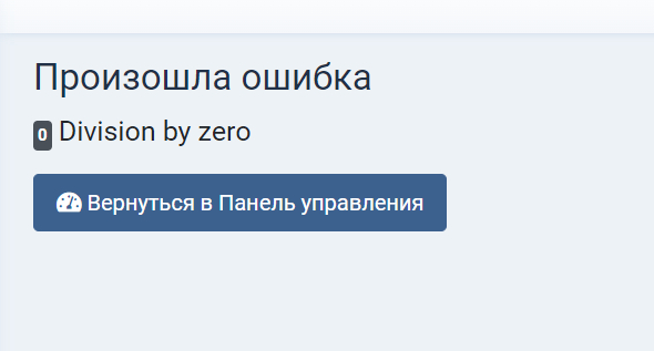

Hello, I can’t log in, there’s an error when I open a menu item, like in the screenshot

Delete the menu item and then recreate it.
You can't have 0 rows * 0 columns. We'll add a patch on our end to prevent the error from happening to others in the future. Thanks for the report.
If you have a products listing below the categories listing and you don't want that, I suppose it's because the products are linked to sub categories of the main category and you have the "sub element filter" setting of the "products options" of the menu item set to "all sub elements". Change this setting to "direct sub elements" and you'll only have the products directly linked to the current category below the categories listing, and thus, if your main category is not linked to any product directly, you won't get a products listing below the categories listing.
