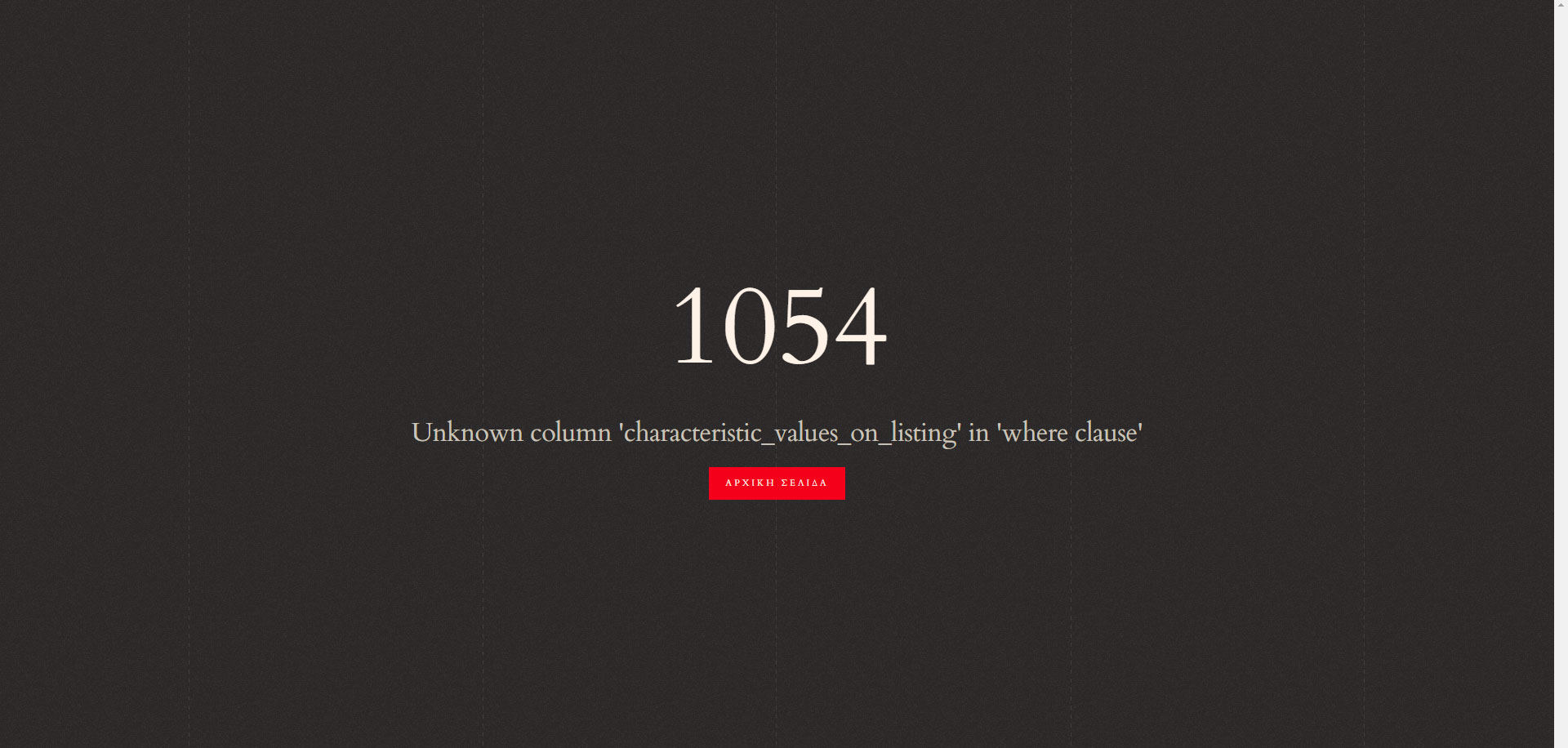

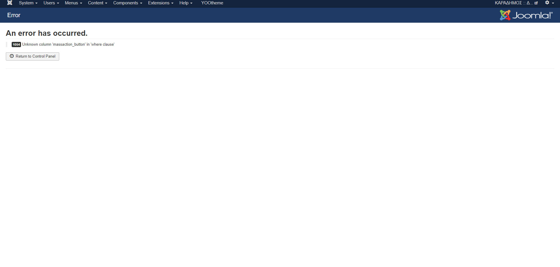

-- Joomla version -- : 3.10.12
Hello!
I tried to install the latest version and i get this error!
Thank you

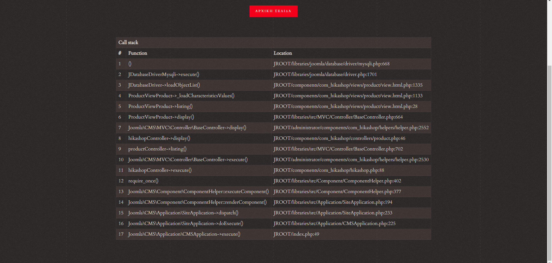

  • Posts: 1184
  • Thank you received: 13

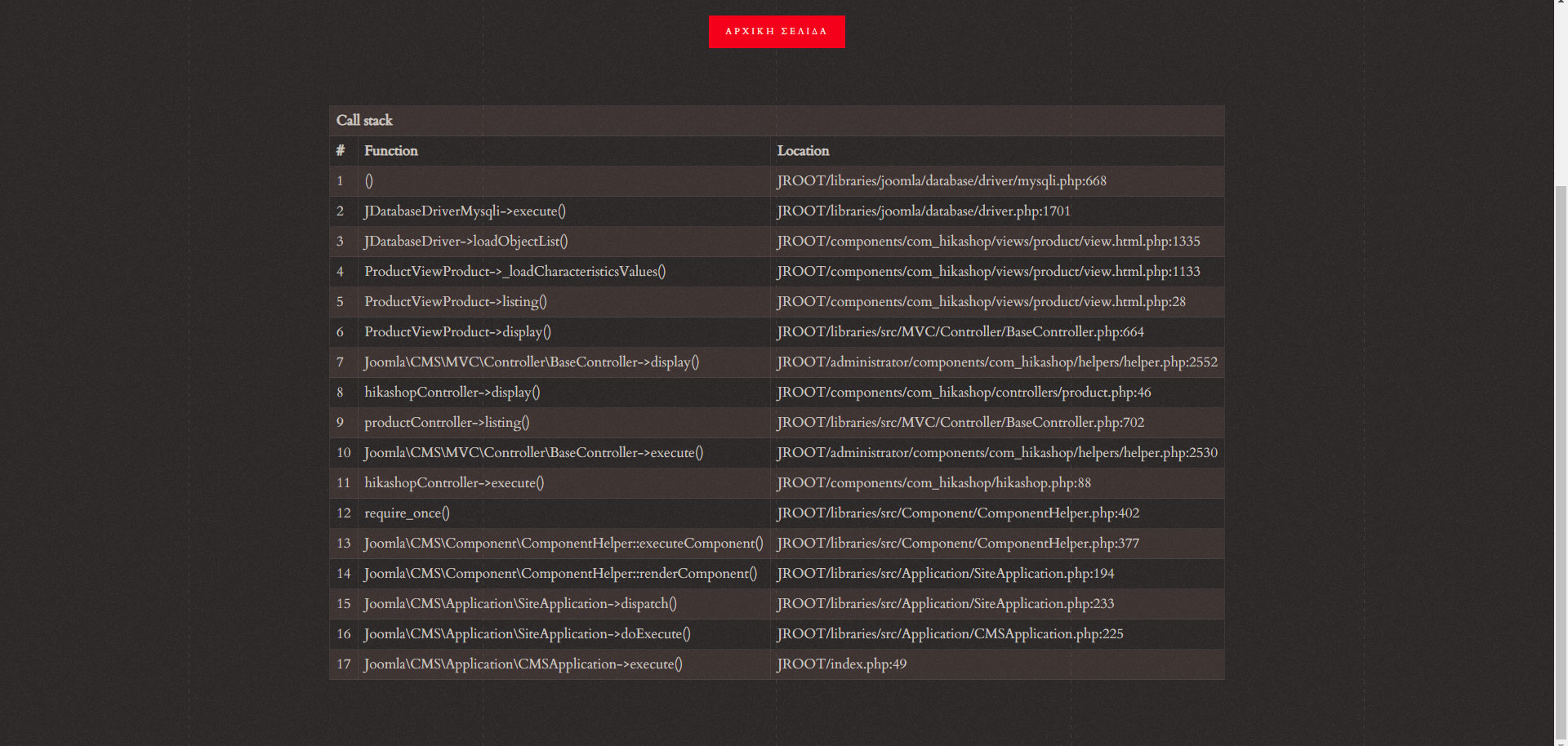

2 years 11 months ago #355354
Okay here is the debug result.
Thank you!
  • Posts: 86080
  • Thank you received: 14188
2 years 11 months ago #355360
This indicates that you're missing the column characteristic_values_on_listing in the table hikashop_characteristic
That column is normally added automatically by the installer during the update process from a version of HikaShop before the 4.5.2 to the 4.5.2 or newer.
Click on the "check database" button of the HikaShop configuration page, and it should fix that automatically.
