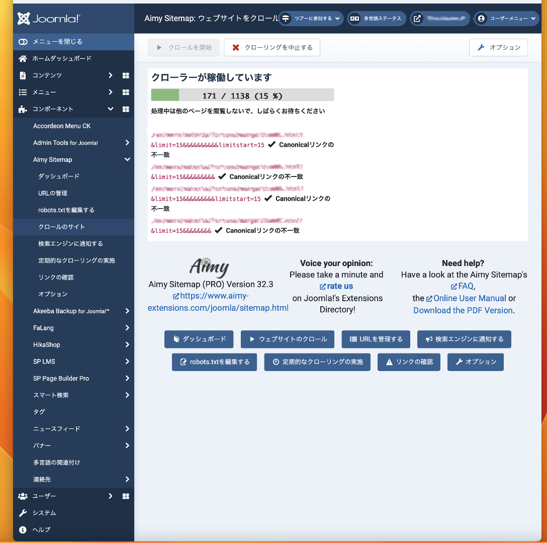

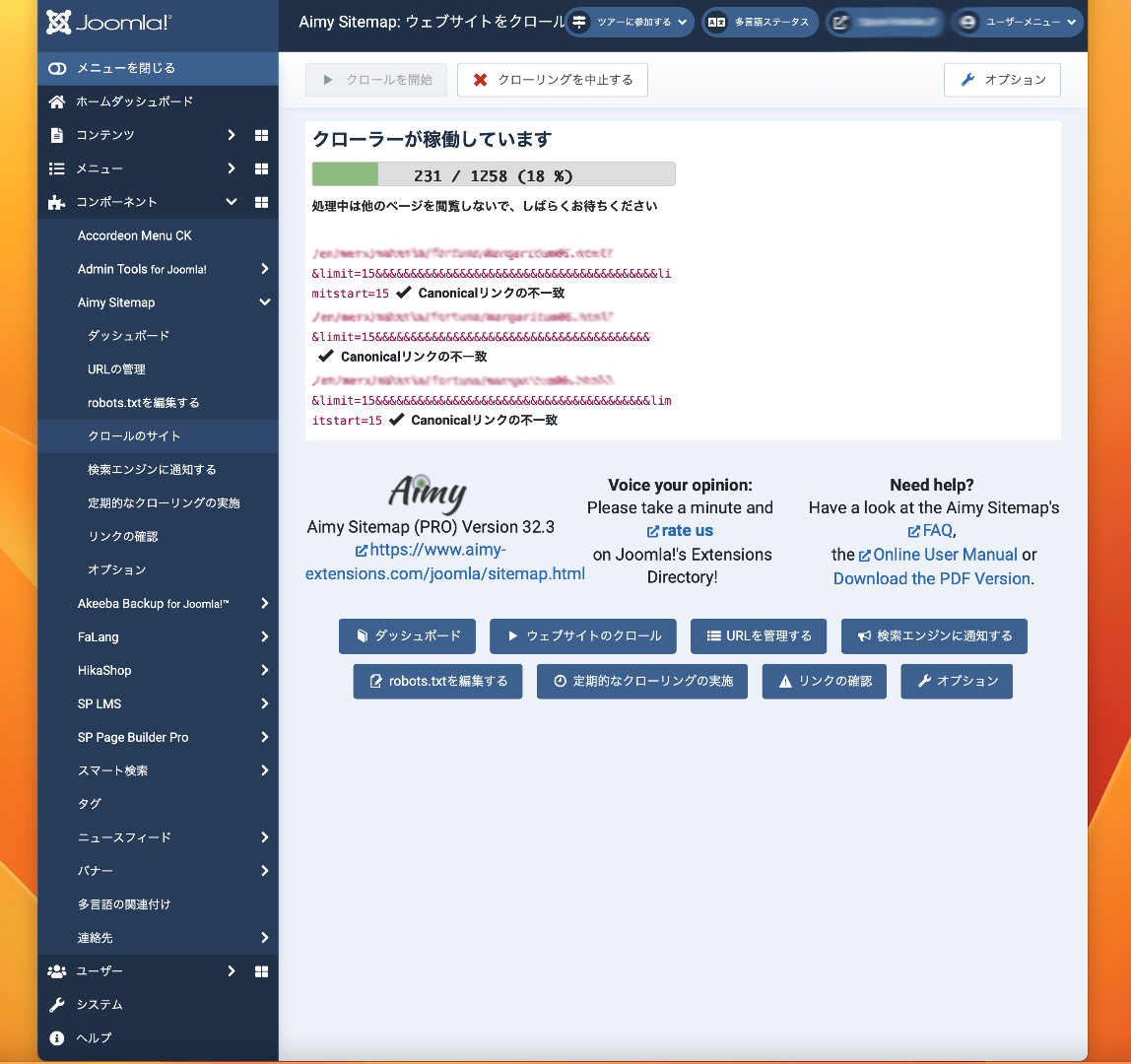

こんにちは。
’HikaShop Business 5.0.0’のアップデートにより、’Aimy Sitemapのクロール’で”&”永遠に増加するバクが発生しました。
prnt.sc/XuvYNRgkDHZF
prnt.sc/FHlGWATHalQS
’HikaShop Business 4.7.5’までは、このような症状はありませんでした。
クロールの問題なので先にaimy-extensions.comに確認しました。返事があり
Based on your description of the issue I assume the HikaShop update
introduces links that contain a growing amount of ampersand characters
("&") - I recommend to report the issue to the developers of HikaShop.
Meanwhile you can prevent Aimy Sitemap from crawling those links by
adding an entry like the following one to your website's robots.txt
file:
User-agent: AimySitemapCrawler
Disallow: *&&*
Please let me know whether that helps to work around the issue you
reported.
("&") - この問題を HikaShop の開発者に報告することをお勧めします。
とのことで連絡いたします。
何か良い提案ありますか?

2 years 11 months ago #355374
One month ago, we were contacted about a similar issue regarding the limit parameter in the URLs of the pagination:
www.hikashop.com/support/forum/install-u...s-of-duplicates.html
This problem was present in previous versions of HikaShop too and we've added 2 patchs in the 5.0.0 to fix the problem.
So I'm surprised of what you're saying as it should not happen with the 5.0.0
Could you provide a FTP access and a backend access so that we can reproduce the issue ?
You can provide these via our contact form:
  • Posts: 86080
  • Thank you received: 14188
2 years 11 months ago #355396
Thanks for the access.
I've made a patch which seems to fix the problem.
We'll include it in the next version of HikaShop.
