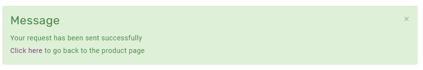

Not receive email once submit form at catalog mode.
mygift.satumalaysiahosting.com/catalogue...duct/contact/cid-108
and also how to make the alert success form come out as image attach.
