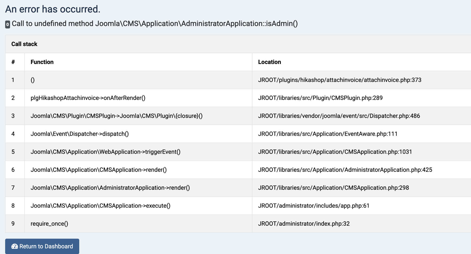

I am having a problem with the Attach Invoice plugin.
I am using Hikashop business 5.0.2 on a site which I have started to upgrade from Joomla 3-4.
I didn't set up Hikashop on the site in the first place, but after the upgrade to Joomla 4 I am getting an error when I go to the Hikashop component that appears to be related to the Attach Invoice plugin, which is available in the marketplace.
It looks like I should update the plugin, but I am getting no messages to say it needs updating - my question is do I need to pay for it and download it again in order to update the plugin?
I have attached a screenshot of the error messages.
Any information gratefully received.

2 years 7 months ago #358159
This error indeed means that you're using an old version of the plugin.
You can see the changelog of the plugin here:
www.hikashop.com/marketplace/product/18-plugin-pdf.html
As you can see, we regularly release new versions of the plugin and the support for Joomla 4, which transitioned from isAdmin to isClient was done with the 1.0.26 in 2019, so this means your version is older than this.
Old versions also don't support the update notification system of Joomla. This was added only about 1 or 2 years ago so it's normal you are not notified of the update in your backend. Once you update to the latest version, you'll be notified going forward.
Regarding whether you need to pay for updates, here are the details:
Following your purchase of a plugin on our marketplace, you get access to updates of the plugin for 4 years for free. You can just use the same download link to get the latest version.
After the 4 years period, you need to purchase the plugin again in order to get a new donwload link which will also be valid for 4 years.
Since your version of the plugin is from 2019 or before, you need to purchase it again I'm afraid.
