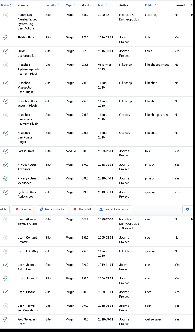

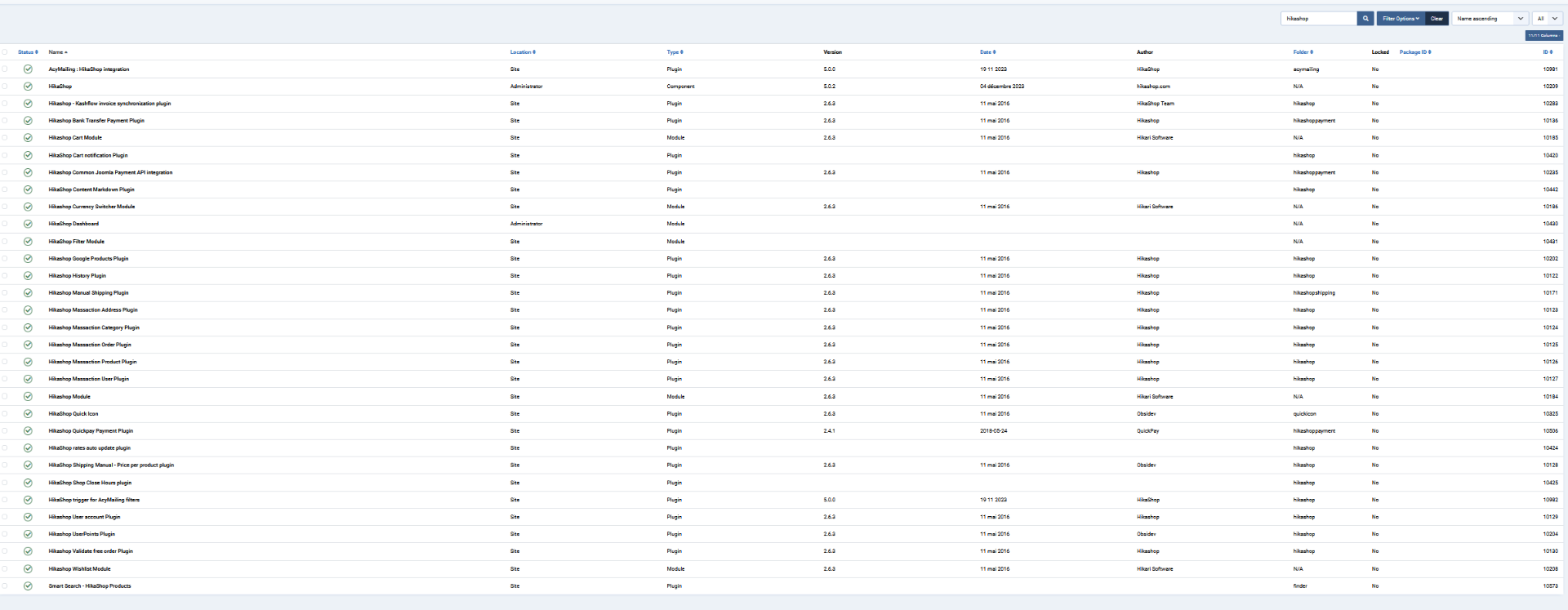

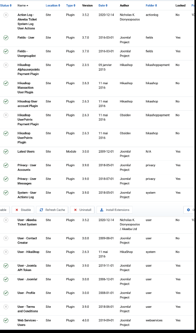

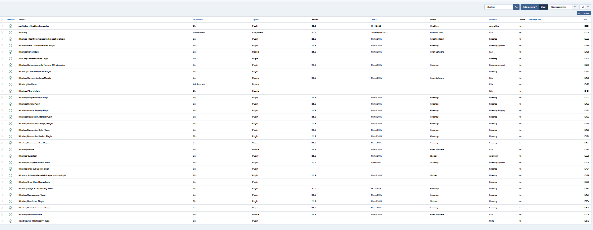

I have some extensions that os version 2.6.3 - - I cant delete them, because there still enablet ?
- I woddent dare to.
I have no ideas - if one/two or more is in use....
See attachnemt, big file.... :-)
If the version is correct, and the year is correct, they are old..
What can you adwise me to do ??
Yes, have used hika for a long time :-)
Regards.

From your screenshot, it seems that you have a problem with the permissions on the plugins folder(s) which prevents Joomla from updating the plugins files when HikaShop is being updated.
I would recommend to :
- make sure that the plugins folder and its sub folder is writable by the unix user of your web server
- install the install package of the latest version of HikaShop again after that. That way, HikaShop will overwrite all the plugins with the latest version
If this doesn't work, then you can try a more violent approach:
- rename the folder of a plugin which was not updated so far via FTP (for example the plugins/hikashop/google_products/ )
- maybe you also need to rename the folder administrator/components/com_hikashop/extensions/plg_hikashop_google_products/ (that's where the files of the plugins are stored before they are installed)
- install the install package of the latest version of HikaShop again after that. That should definitely add the google products plugin with the latest version, so please check.
- if that works, rince and repeat for each plugin with an old version number.
