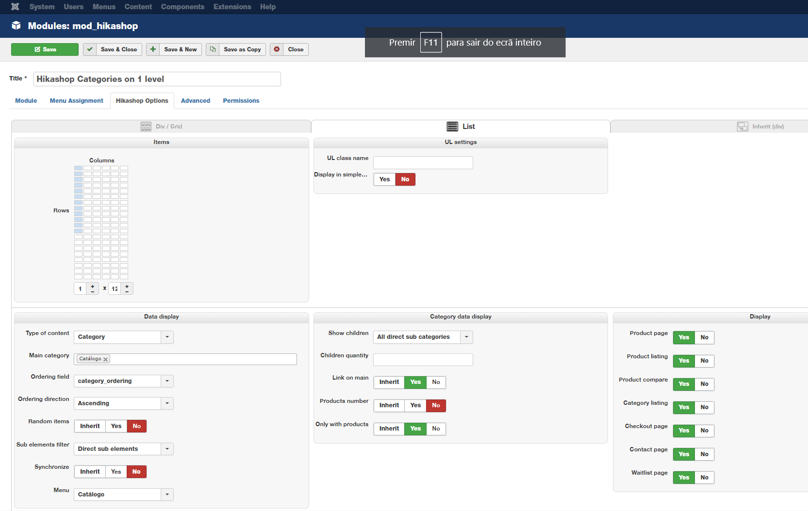

Since some weeks HikaShop ReCaptcha v2 stoped working. I've read this is due to a conflict between Google ReCaptcha v2 Javascrip and Mootools (I got ahold of this from this post in your forum )
I've tried disabling Mootools with Mootools Enabler/Disabler and that solves the issue.
However this comes at the expense of loosing the 'expand'/'contract' ability in the Hikashop Menu Module used in the right side pane of the site, i.e. it just shows all the main categories and 1st child level categories instead of showing just the main ones allowing for expanding to show the 1st child level ones.
The module in question is of the 'HikaShop Content Module' type, configured the way you can see in the attachment 20231129-screenshot-01.png . I'm guessing in this configuration it's using Mootools or in some other way the Mootools Enabler/Disabler the Plugin when enabled is afecting the category display functionalities.

For the accordion system in the HikaShop content module, we rely on the accordion library provided by Joomla.
On Joomla 4 and 5, the accordion library uses Bootstrap only as Mootools has been removed from Joomla.
On Joomla 3, the accordion library of Joomla comes with both a Mootools one and a Bootstrap one. HikaShop can rely on either of them based on the setting "use bootstrap design v2" setting in the Advanced tab of the HikaShop configuration. We default on Mootools because many templates made for Joomla 3 don't include Bootstrap v2 and in that case, it wouldn't work properly.
Note that other areas of the HikaShop interface on the front take into account this "use bootstrap design v2" setting. So if activating this setting messes things elsewhere, you can also edit the view file category / listing_list.php via the menu Display>Views and add the line:
$this->tabs->mode = 'bootstrap';
after the line:
$this->tabs = hikashop_get('helper.sliders');
This will force the use of the Bootstrap accordion regardless of your version of Joomla or how the "use bootstrap design v2" setting is set.
Ospam-a-not is indeed a good alternative to ReCaptcha.
Also, another solution is to use another accordion module for your categories instead of HikaShop's built in module.
For example:
www.joomlack.fr/en/joomla-extensions-acc...h-accordeon-hikashop
Or: extensions.joomla.org/extension/skyline-...ordion-for-hikashop/
Or: www.osthemeclub.com/product/accordion-menu-for-hikashop/
