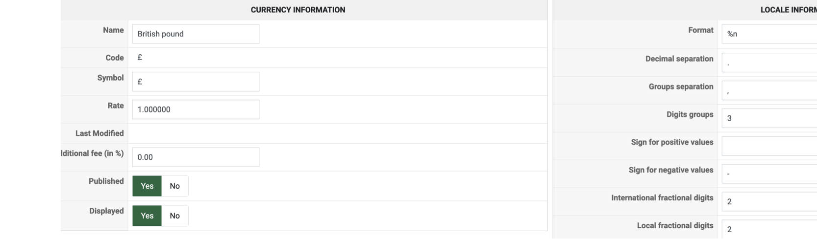

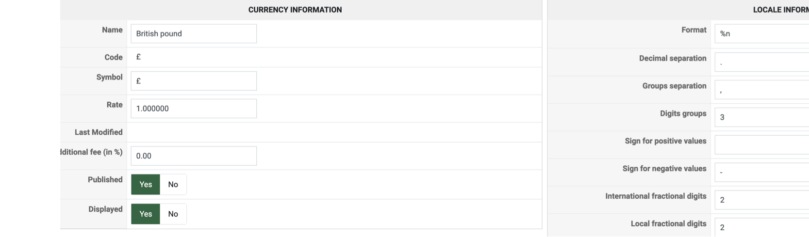

2 years 8 months ago #357336
Here's what's there for the UK Pound
Settings page
  • Posts: 86080
  • Thank you received: 14188
2 years 8 months ago #357338
Indeed, the problem is that the "code" field should contain the currency code GBP and not the symbol.
That code should normally not be changed as payment gateways rely on the currency code when processing payments.
  • Posts: 167
  • Thank you received: 26
2 years 8 months ago #357359
Dug around and they FINALLY found some notes
The currency table had been edited to show the £ instead of the GBP
Simple solution for the ignorant was to change %i to %n in the Locale information > Format to achieve what was sought :silly:
