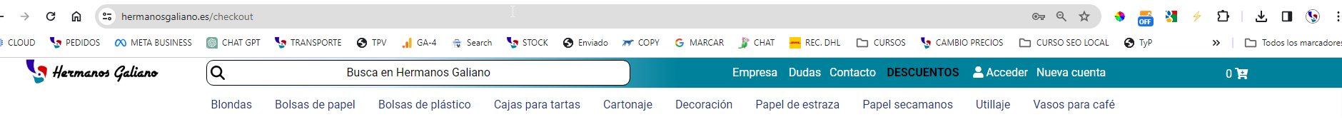

Hi.
In my store with hikashop, when a non-logged user adds items to the shopping cart and clicks the buy button to go to checkout, the number of products in the shopping cart indicator is set to 0.
It only happens with visiting users.
When a user is logged in this problem does not occur.
Any suggestions?

Confirmed.
It is the composition of the shopping cart within a anywhere module that is causing problems.
I have relocated the shopping cart to another position and problem solved.
I don't like it because I'm more in favor of putting the shopping cart on the top bar, but at least it doesn't cause errors.
If you have any other suggestions...

Hi Nicolas.
The top bar is made just as you tell me, using the "anywhere" component (you recommended it to me).
If I put the shopping cart in a different module than the one that takes "anywhere" as a reference, it doesn't give an error.
Even activating the Ignore Cache option it still worked poorly.
