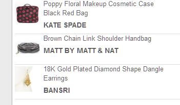

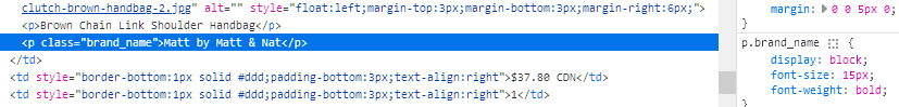

  • Posts: 966
  • Thank you received: 11
2 years 7 months ago #358590
1. Thank you. When is the "Order notification" used?
2) Sorry but that didn't work. Please see attached.
Thanks!
  • Posts: 86080
  • Thank you received: 14188
2 years 6 months ago #358624
1. When you use the "email" button of an order in the order details page of the backend.
2. Sorry I had read too fast your previous message and I didn't see you wanted to reverse the order.
In that case, you want to change the line:
$t.='<p class="brand_name">'.$brand->category_name.'</p>';
to:
$t='<p class="brand_name">'.$brand->category_name.'</p>'.$t;
