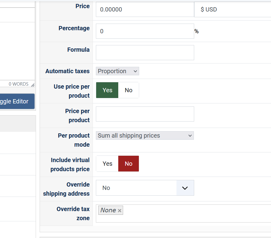

2 years 7 months ago #358551

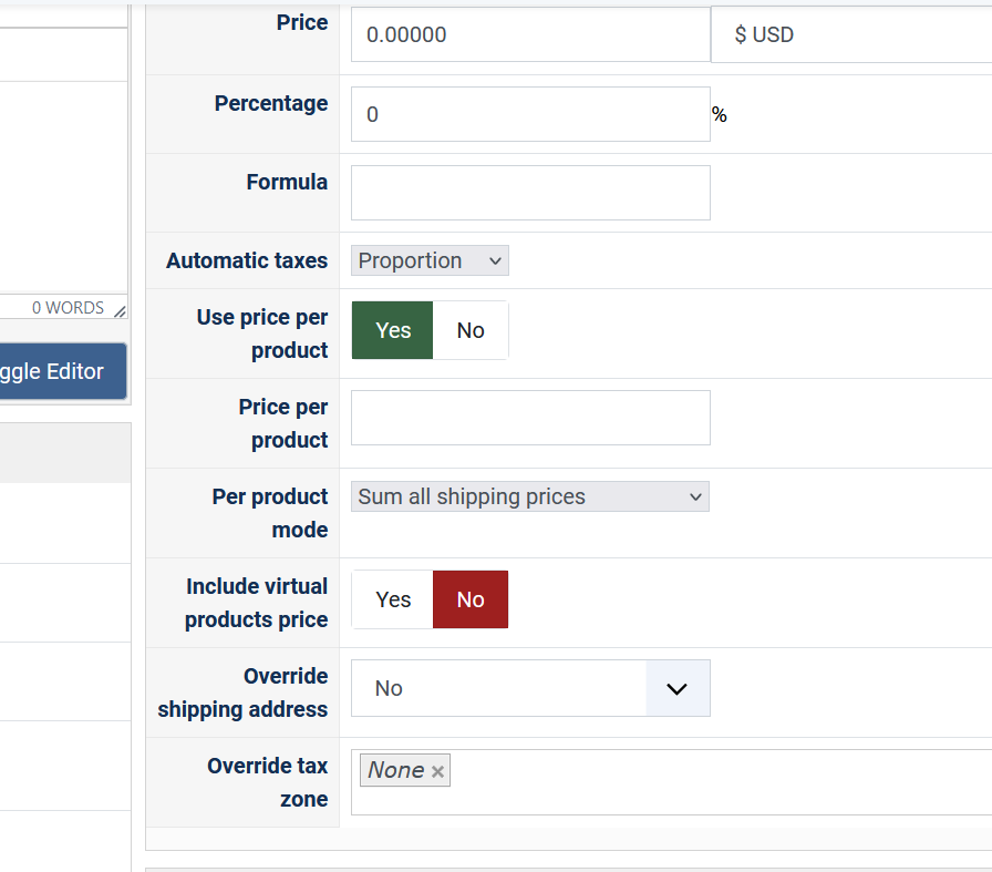

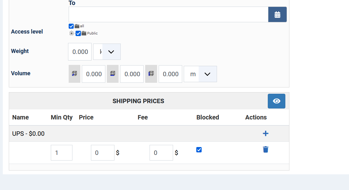

You want to activate the "shipping price per product" setting of your UPS shipping method. Then, when you edit your products, you'll have a "shipping prices" area.
In there, you'll see each shipping method with a "shipping price per product" setting activated. And you can use their "block" checkbox in order to disable the shipping method, when the product is in the cart.
www.hikashop.com/support/documentation/3...ng-manual-price.html

I think this pretty much describes what I need to do?
www.hikashop.com/forum/shipping-methods/...-s-shipping-fee.html

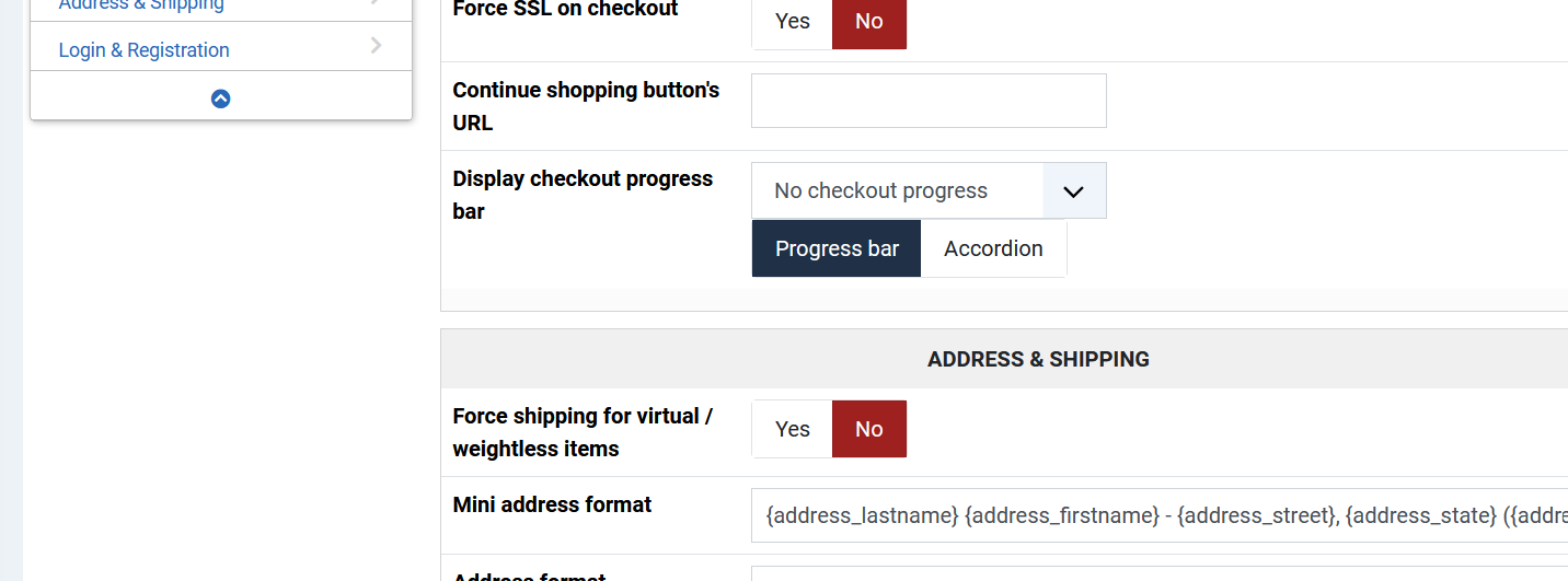

Supposing that you didn't set any weight in these products and variants, if you're still seeing the UPS shipping method before blocking, and since the checkout is blocking you to finish now, this indicates that you probably have the "force shipping regardless of weight" setting activated in the HikaShop configuration.
Because of this, a shipping method has to be selected to be able to complete the checkout.
Since you're not talking about an error message, I suppose that you also must have turn off the error message display setting of the shipping block in your checkout workflow.
Normally, the error message should tell you that no shipping methods were found for the products in the cart.
So, there are 2 ways to go about it:
- The simplest would be to just turn off the "force shipping regardless of weight" setting. In fact, by doing so, you could just not have to block the shipping method since no shipping would be asked during the checkout for products with a weight of 0.

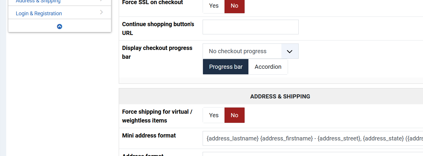

2 years 7 months ago #358581
Nicolas,

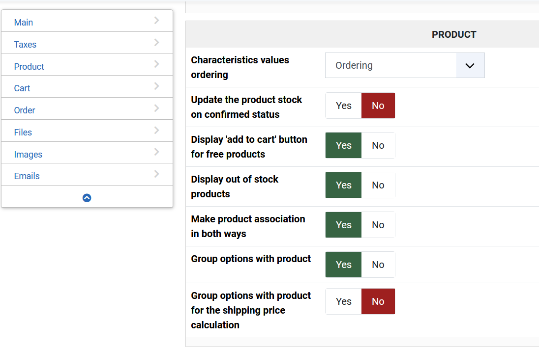

Should this ("Group") be turned on? (I think so.)
Also, I couldn't find a button labeled "Force shipping regardless of weight." But maybe it is this?
Thanks again!
-JG
Last edit: 2 years 7 months ago by jgribble.
  • Posts: 86080
  • Thank you received: 14188
2 years 7 months ago #358584
1. Yes, you want to turn on the group option.
2. Ah right, the text of this option was changed ! I had forgotten. It's indeed this option.
