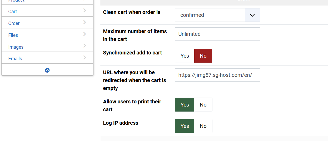

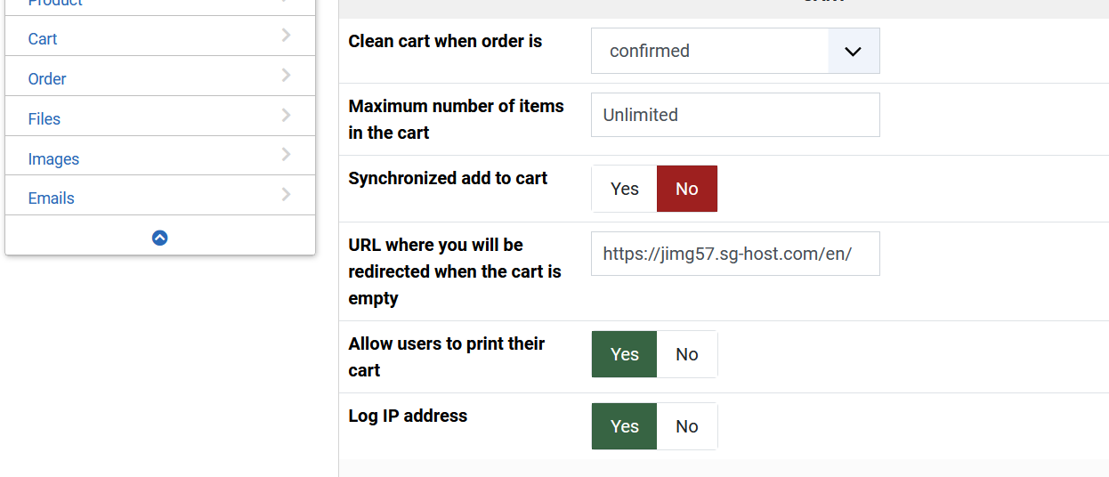

2 years 6 months ago #358756
We find the root issue, you have activate the "Synchronized add to cart", switch it to "Off" and it will solve your issue.
Now, in order to explain you this option can't work when you have a product with lots of options associated, and unless I'm mistaken, it doesn't seem to us that you really need this option given your frontend.

2 years 6 months ago #358769
I think there is a misunderstanding, I deactivated this option.

2 years 6 months ago #358790
Don't worry, I should have told you that I allowed you to change this parameter.
regards
  • Posts: 317
  • Thank you received: 20
2 years 6 months ago #358815
I did republish the field and now everything works perfectly, thank you. Making a note to always leave that setting off.
