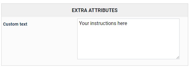

If want to create a custom field for "Special Instructions" on the checkout page, how would I do that?
  • Posts: 86080
  • Thank you received: 14188
2 years 6 months ago #358786
It depends.
If you want the field to be tied to each address, you should create a custom field of the table "address".
If you want the field to be tied to the order, you should create a custom field of the table "order".
You want the type to be "textarea".
  • Posts: 278
  • Thank you received: 42
  • Hikamarket Multivendor Hikaserial Subscription Hikashop Business

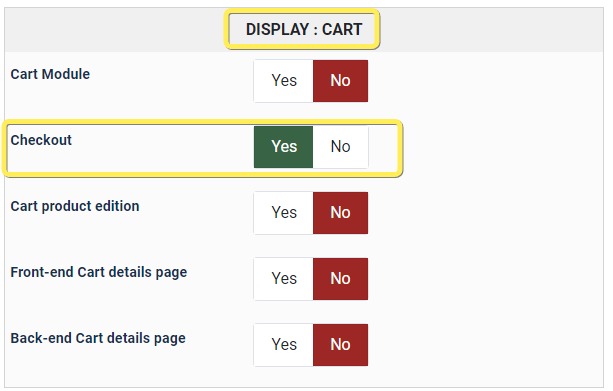

2 years 6 months ago #358791
Create a custom field with this settings:
  1. Table: Item
  2. Field type: Custom text
After you save, you will have the option to make the field visible in checkout.
