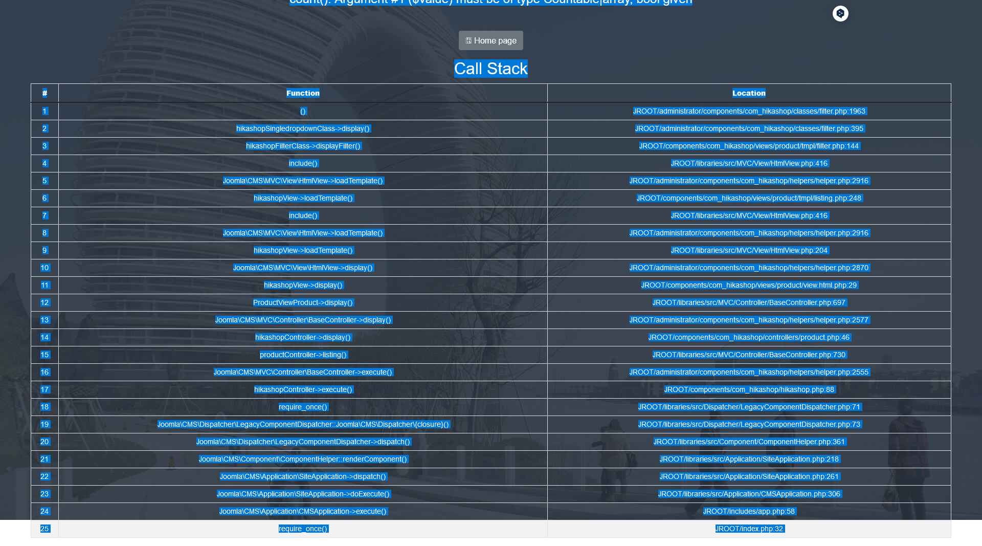

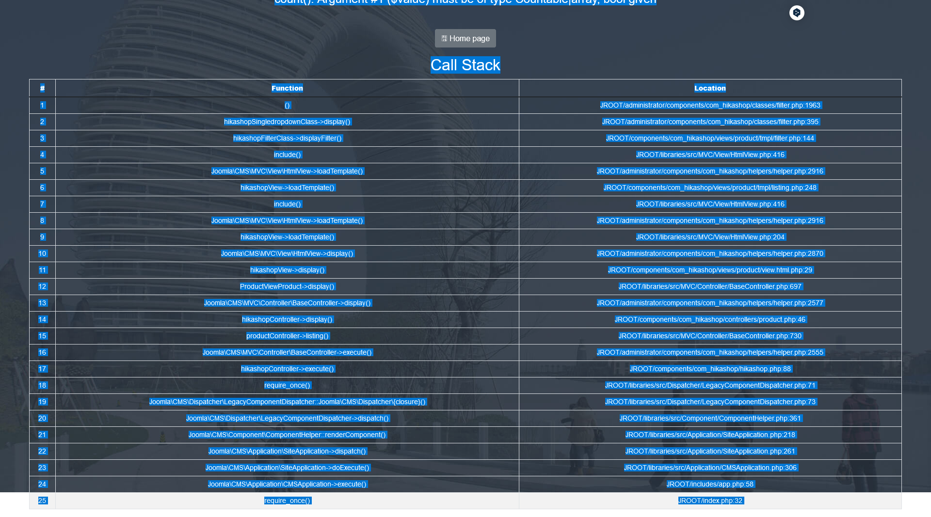

  • Posts: 11
2 years 6 months ago #359007
I'm attaching the screenshot with the error after activating Joomla debug at the maximum level.
Thank you.
  • Posts: 86080
  • Thank you received: 14188
2 years 6 months ago #359015
Thanks. That's exactly what we needed.
I've made a patch on our end for it. Download again the install package of HikaShop 5.0.3 on our website and install it on yours. It will add the patch and you won't have the error.
