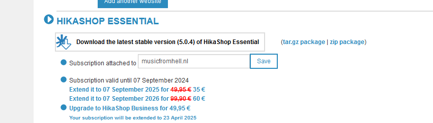

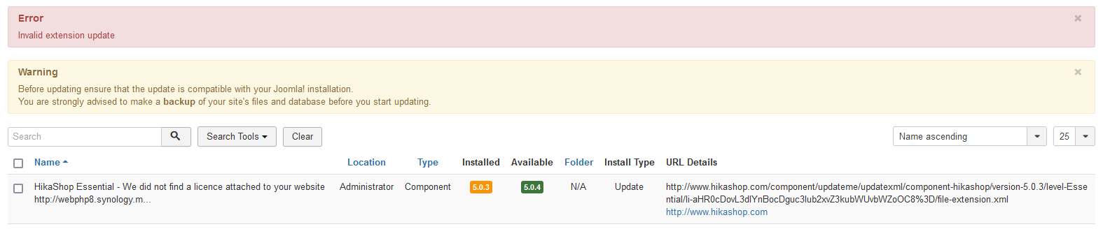

Sorry I was unclear, I will try to explain with some screenshots taken on the local test server , as this is the one I put back on the live server the error is the same.
And yes of course locally it does not work ;)

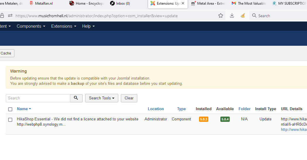

If I look at the update in joomla I get :
HikaShop Essential - We did not find a licence attached to your website webphp8.synology.me
And the update fails, because Hikashop sees still the local url instead the one with the licence (musicfromhell.nl)
Hope is a bit better explained now???
Thanks for your time
Appie

nicolas wrote: Hi,
Which URL are you using to access your backend ?
I am using the URL with the subscription (musicfromhell.nl)
Have attached some screenshots so you can see..
The live site in my config file is blank, and yes I cleaned cache several times, browser cache and joomla cache
If this is something you would like to investigate you can get access to my backend..
But that said its not a big problem for me, I always download an update also for backup reasons, so for now I can do the update that way.
And maybe if I install it manually now, the next update it would be okay again?
Thanks..
Appie
