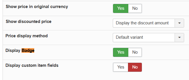

We will need these elements in order to better understand the context :
- Your relative badge settings via a screenshot
- As an example, an url link to a product page where your badge works and one where it does not work.

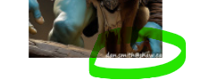

Ok, go ahead and give it a try. I've added a free Ogre product. As you can see, the watermark is on the thumbnails but not on the product download image. Do not worry, you will not be charged for the order, but you have to sign up in order to get it.
Here is the item on the product page:
My Badge setting:

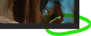

And the final product. Note there is no watermark on the image.
Any assistance would be greatly appreciated.

First of all, I have your badge everywhere, including when I downloaded it, see my screenshots:
But it seems that it is your image of your product that directly contains your badge.
From there, I don't really understand how you manage to have a download without this badge...

I have just created another free item, the glass hummingbird. Please go through the ordering process and download the product image. Don't rely on the thumbnails for watermark accuracy. Once you get the product image downloaded, look at the image and you will notice the watermark is not showing like it does on the thumbnail images.
You may create a dummy account with fake information but please do this so you can see what I mean, then it will all be more clear. Just let me know what it is so I can delete it later.
