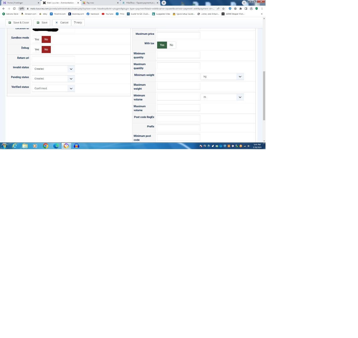

We will need these elements :
- Your Square plugin setting via a screenshot
- Activate the Joomla Debug, in maximum level and process a test to see if we have errror message & clues
=> Provide this via a screenshot

Hi my square settings is attached. some is cut off. at top it says published and at bottom access level is set to all. I went and set joomla to maximum error recording then tried to add to cart on front end and check out with square, purposely backing out. The cart does not empty. I am unsure where to get the log file? i went to administrator/logs and see some stuff listed under error.php. but the last entries were just
2024-07-30T22:03:07+00:00 WARNING 144.62.xxx.xxx deprecated Joomla\CMS\Application\CMSApplication::getCfg() is deprecated and will be removed in 6.0. Use Factory->getApplication()->get() instead.
