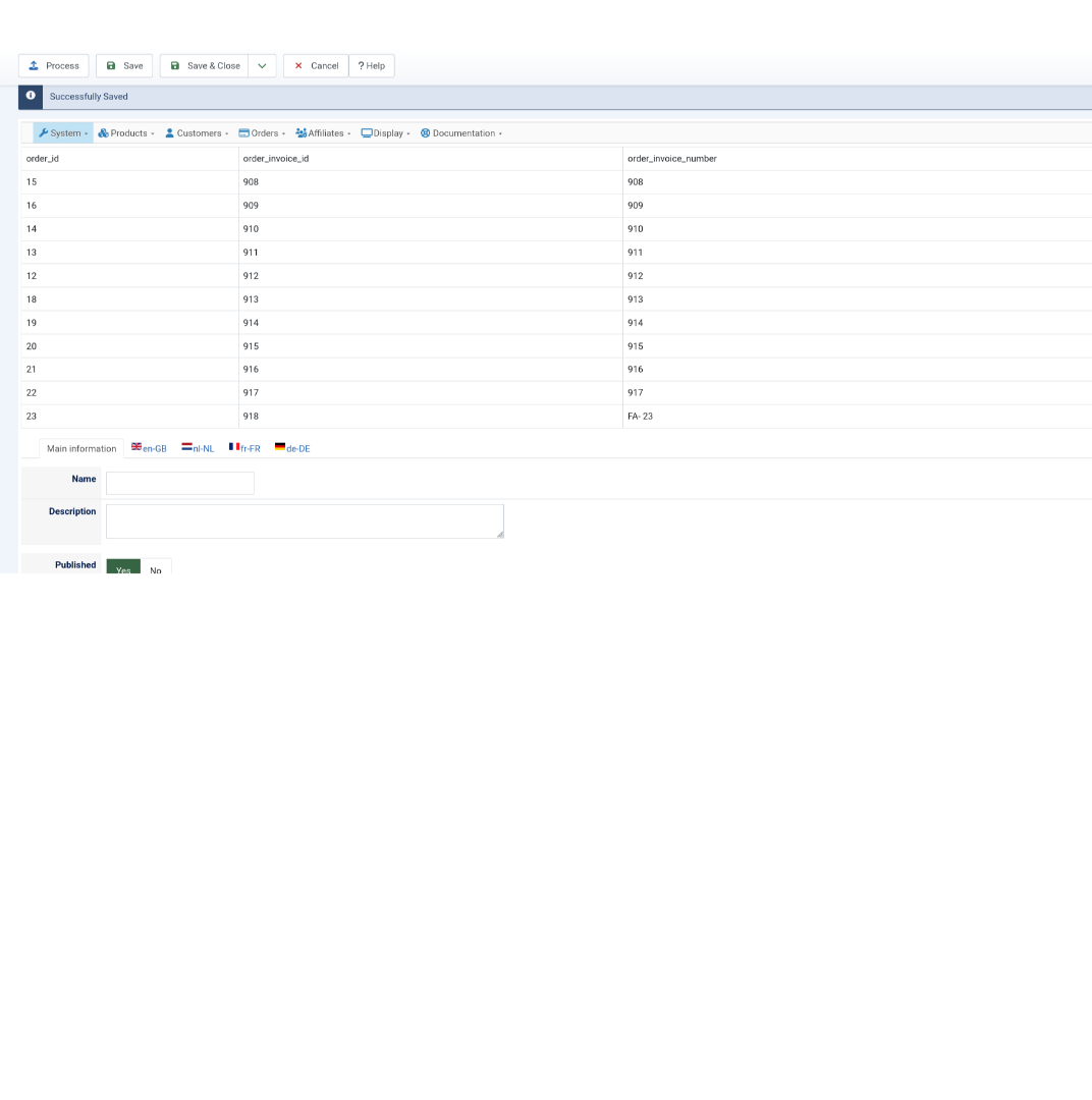

i am still trying to change the invoice numers (coming from j2store). I can chnge them with mass action, but the next invoice number is again the old folow number.
Need simple howto

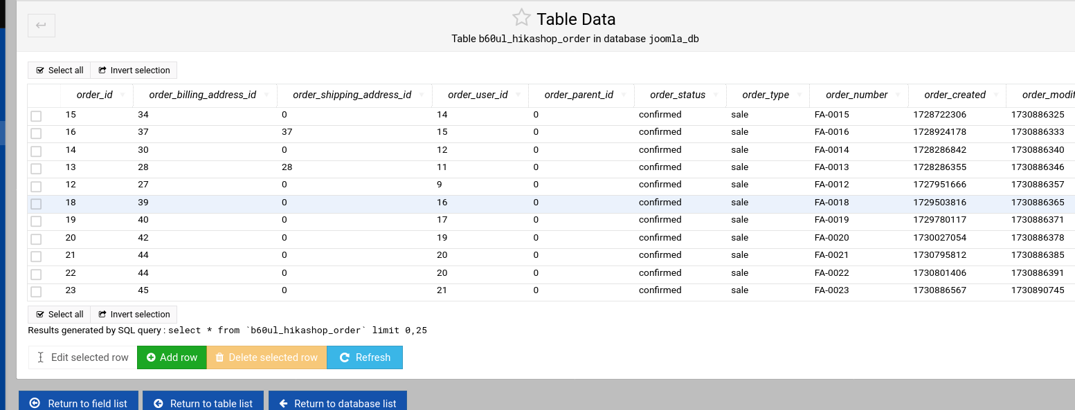

1 year 10 months ago #364291
this the data from mariadb.
What to change?

1 year 10 months ago #364312
no, i do not understand. How to set next order_invoice_id or order_id?
Also, if i manual create an order, the id is FA-0025.
If I delete this order, and again make new order, the id is FA-0026
Should this be again FA-0025?
