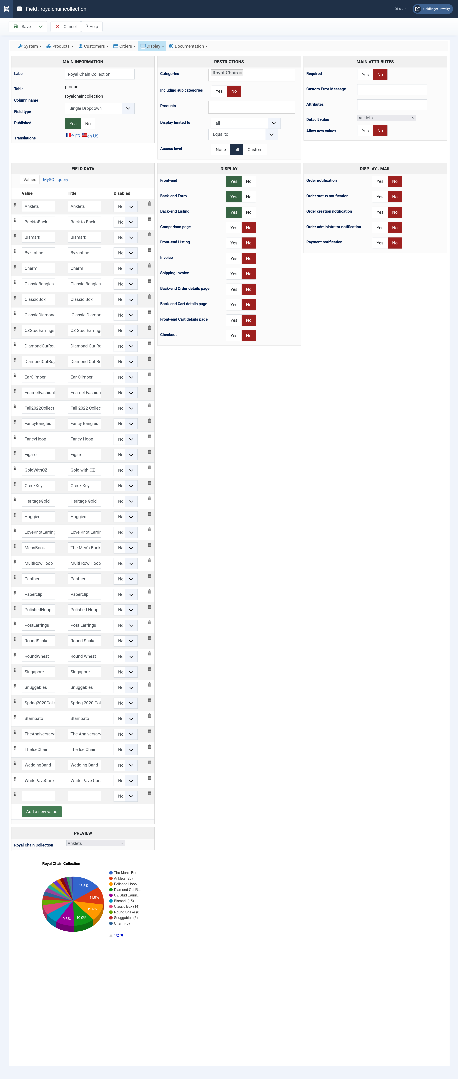

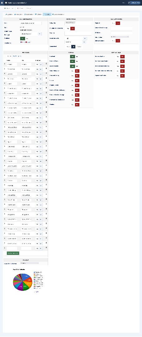

1 year 9 months ago #364695
I enclose a screenshot.
What is strange is that I've been working with this custom field since a few day without any issue until today. And I didn't change any settings.
Sandra

  • Posts: 195
  • Thank you received: 18
1 year 9 months ago #364699
Oh sorry.
Here is the zip.

  • Posts: 86080
  • Thank you received: 14188
1 year 8 months ago #364755
The custom field works fine.
I edited a product and tried to select another value and it worked fine. I tried many values.
The only one which didn't work is "Wedding Band".
That's because there is an extra space at the end: i.imgur.com/uTjTOVI.png
This prevents HikaShop from matching the saved value in the database (without the space), and the value in the list of values.
You should remove the space at the end there and it will then work fine for this value too.
