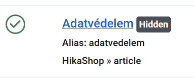

After Joomlaupdate the URL-s of some of the single article type pages are changed, the suffix id-xxx is added to the URL, where xxx is the article id. This results in a HTTP 404 error.
When I open the menu, I see that the menu item type is Hikashop >> Article. (see attachement Before.png)
When I open the menu item and save it without any modification, the menu item type is changed to Articles >> Single Article, the suffix disappears from the URL and everything works fine. (see attachment After.png).

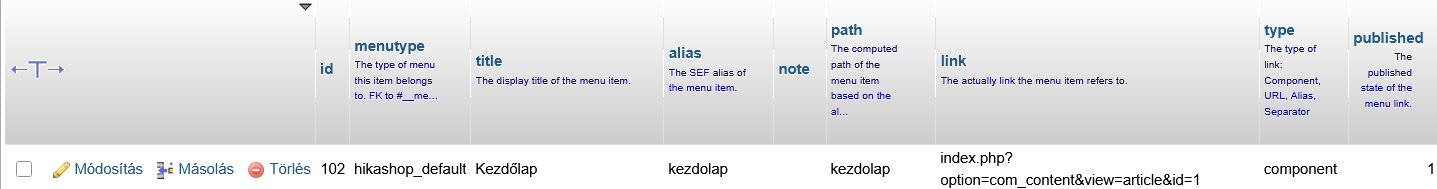

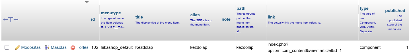

In database the component is com-content, see
Any idea? Isn't this pre-created "Hikashop default menus" menu different than the normal menu?
