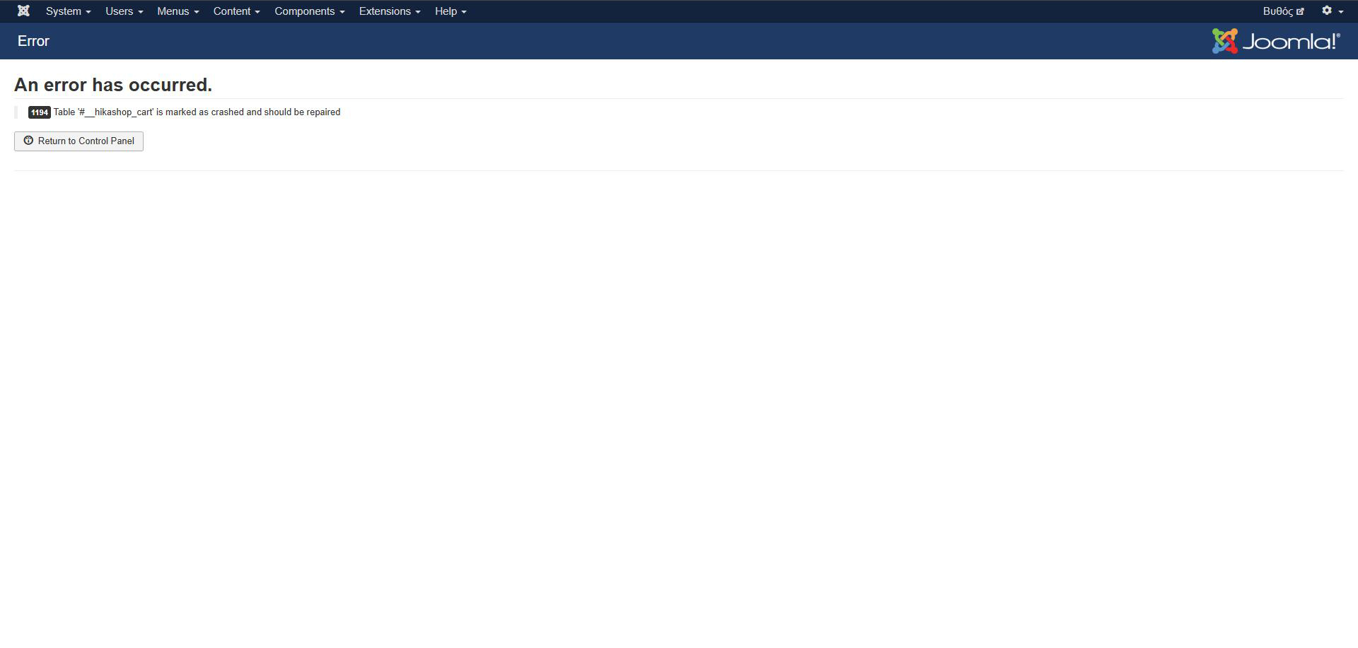

Hi!
About every 10 days, i get this error that hikashop cart table crashed and i cannot enter the Hikashop control panel in backend.
The only solution i found is emptying the hikashop cart table from PhpmyAdmin but it keeps happening.
Any idea why and how to fix this?
Thank you!

1 year 2 months ago #367512
Maybe it is too big because of bots ?
Next version should help.
Another thing you can try is to change the engine type of the table to innoDB instead of MyISAM via your PHPMyAdmin
