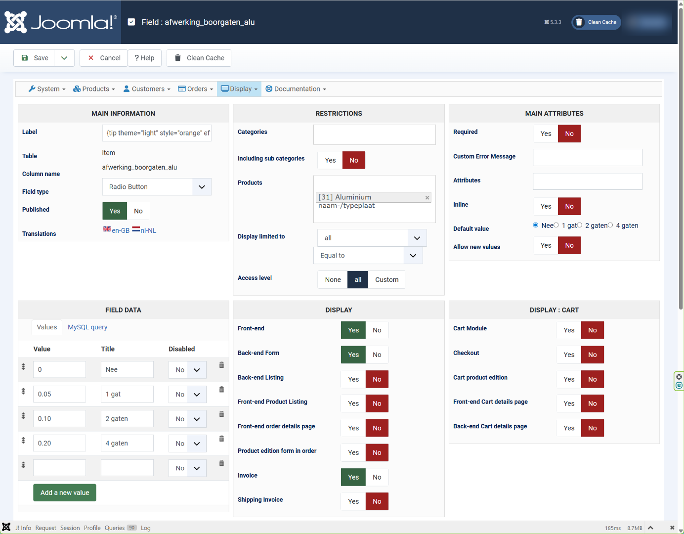

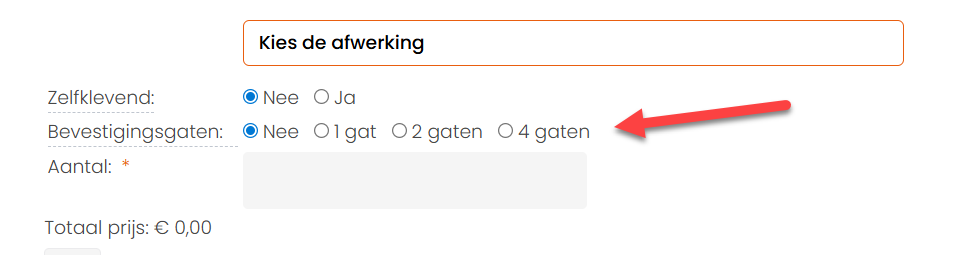

We are selling aluminium plates with the option to add holes. Each hole costs €0.05, but to start this process we need to add a one-time starting cost of €10. We created a custom field {afwerking_boorgaten_alu} see screenshot.
The idea is that when “No” is selected, the outcome is 0. But if one of the other options is chosen, the result should be:
{afwerking_boorgaten_alu} * {quantity} + €10 fixed cost.
However, the fixed cost should only be applied once, and not if “No” is selected.

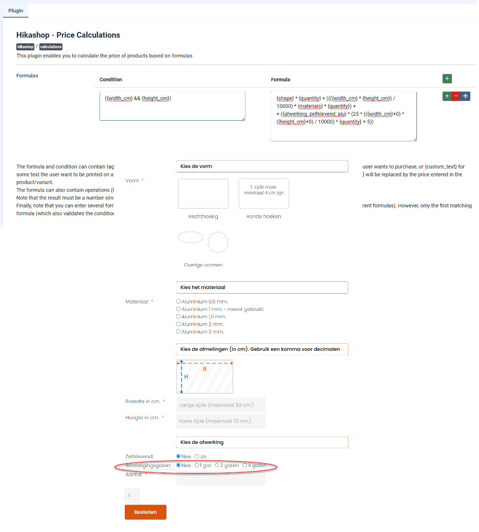

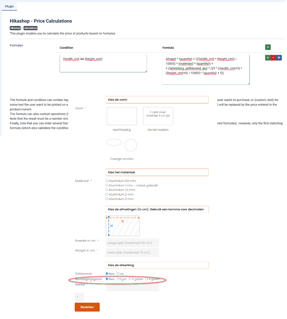

Thanks for the explanation. But this custom field is part of a larger formula.
See: novomark.lucians.eu/webshop/producten/pr...nium-naam-typeplaat/
How can we add this part to the existing working formula?
See screenshot: everything is working fine, but how can we add this part that is circled, which you gave me two formulas for?
If we have to create two lines just for this one item in the form, how will we handle it later if I have a few more of these kinds of questions?
It will become hard to manage all those combinations in different conditions, and with four of these questions we would already need 16 lines. Or am I seeing that wrong?
