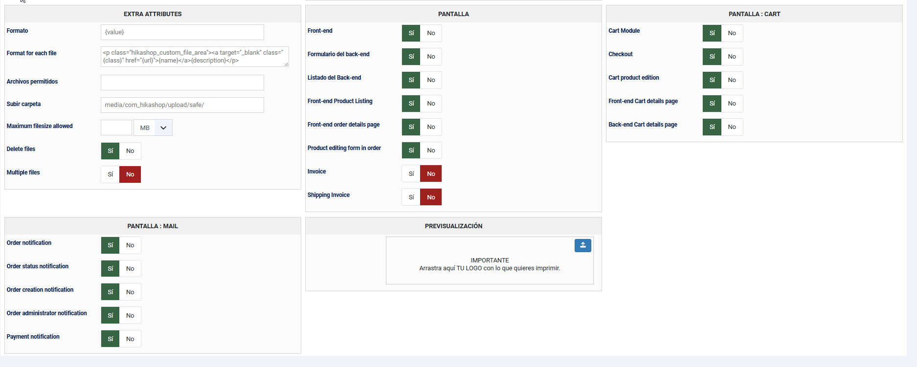

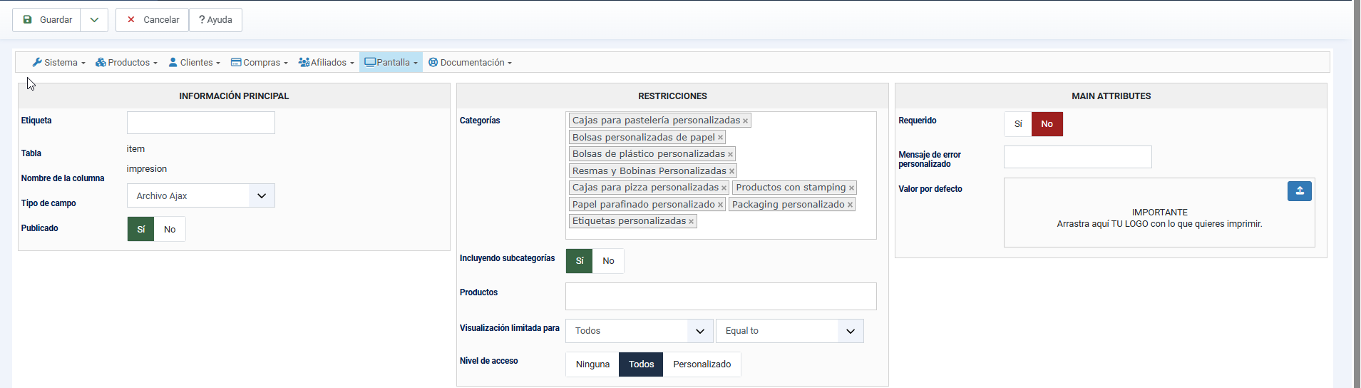

Can you please provide a screenshot of the settings of your custom field with the issue ?
  • Posts: 457
  • Thank you received: 19
8 months 4 weeks ago #369533
I’m attaching two screenshots of the custom field configuration.
Right now it is working because I’m using the previous version of HikaShop.
  • Posts: 86080
  • Thank you received: 14186
8 months 4 weeks ago #369544
Great. That's what I needed. I was able to reproduce the problem and I made a patch on our end.
Download the install package of HikaShop on our website and install it on yours and you'll get the patch.
