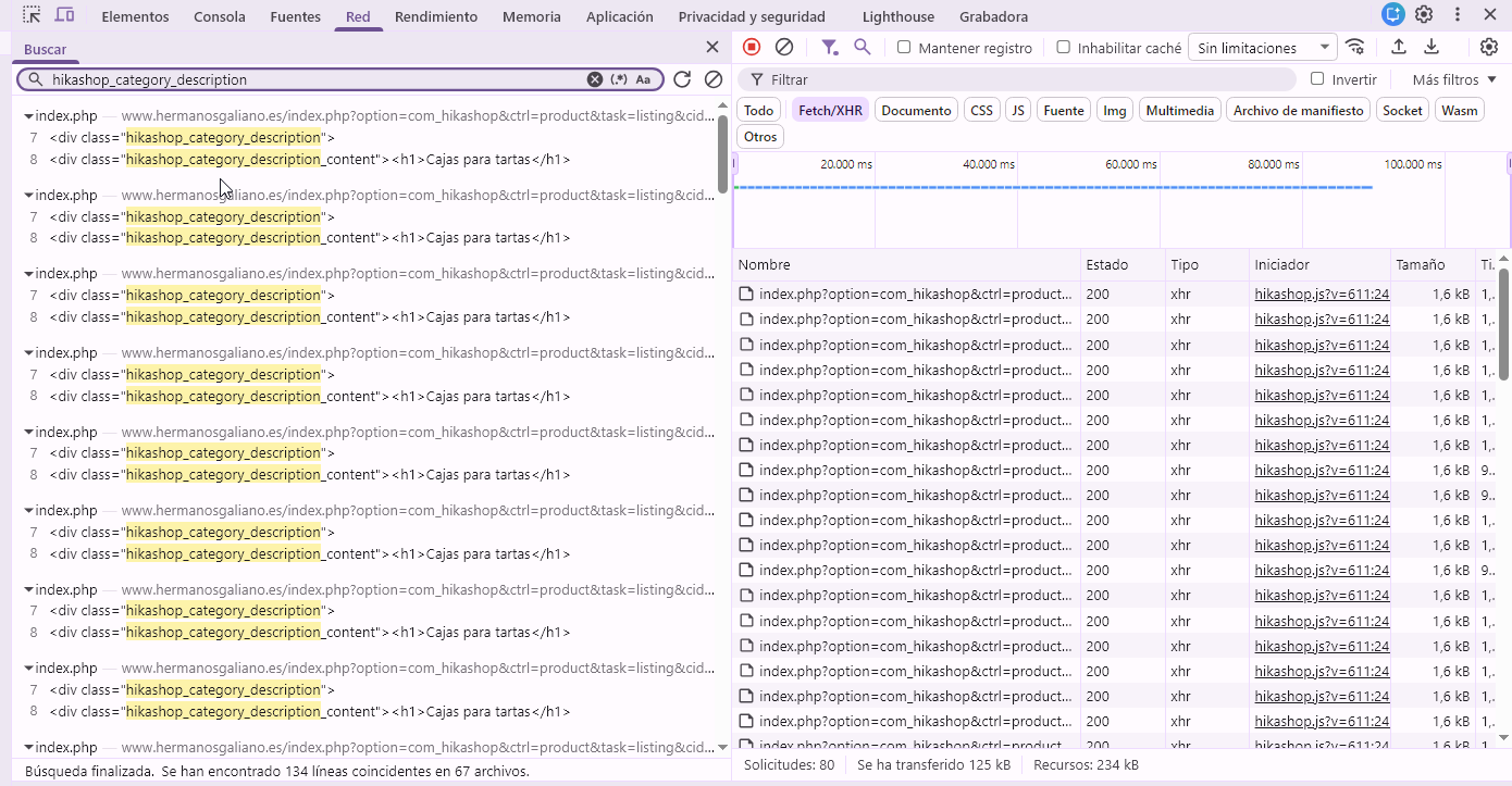

I am making changes to our website to achieve better positioning. This has led me to Chat GPT detecting a possible "bug" on category pages
I have asked him to ask me a technical question so I can pass it on here, and this is what he tells me:
I’m using Joomla + HikaShop and on category pages the category description is duplicated multiple times after dynamic loads (AJAX refresh / infinite scroll / pagination).
What I see
In view-source: the category description appears only once (so initial HTML is OK).
But in the live DOM, after each dynamic load, the description is appended again.
The number of nodes grows after each load:
document.querySelectorAll('.hikashop_category_description').length
(example: it goes from 1 to 5/8/etc. depending on how many AJAX loads happened).
Most duplicated descriptions are located inside the AJAX container:
.filter_refresh_div
Expected behavior
Category description should appear only once, not be re-injected during AJAX listing updates.
My assumption
The AJAX response used to refresh/append the product listing also contains the category description block (.hikashop_category_description / .hikashop_category_description_content), and frontend JS appends it instead of replacing/removing the existing one.
How to reproduce (simple)
Open any HikaShop category page that uses AJAX refresh / infinite scroll.
Scroll / trigger dynamic loading several times.
Category description appears repeatedly below the first one.
Confirm in console:
Question
Is there a recommended setting to exclude the category description from AJAX refresh responses, or ensure it’s not duplicated?
Is this a known issue with filter_refresh_div / infinite scroll / filter module?
If the fix is a template override, which file/hook should be adjusted?
Environment (fill in)
Joomla: 4.x
Browser: Chrome
Thanks!

if(empty($layout_type))
	$layout_type = 'div';
$classes = 'hikashop_category_information hikashop_products_listing_main hikashop_product_listing_'.@$this->element->category_id;
if (HIKASHOP_J40)
	$classes .= ' hika_j4';
else
	$classes .= ' hika_j3';
$attributes = '';
if(!$this->module || hikaInput::get()->getVar('hikashop_front_end_main',0)) {
	$classes .= ' filter_refresh_div';
	$url = hikashop_currentURL();
	$tmpl = 'component';
	if(HIKASHOP_J30) {
		$tmpl = 'raw';
	if(!strpos($url, '&tmpl='.$tmpl.'&filter=1')) {
		if(strpos($url, '?'))
			$url .= '&tmpl='.$tmpl.'&filter=1';
		else
			$url .= '?tmpl='.$tmpl.'&filter=1';
	$attributes = 'data-refresh-class="hikashop_checkout_loading" data-refresh-url="' . $url . '" data-use-url="1"';
if($filter_type !== 3) {
	$this->setLayout('listing');
	$html = $this->loadTemplate($layout_type);
	// FIX: do not re-output $mainInfo on infinite scroll AJAX loads
	$enableCarousel = (int)$this->params->get('enable_carousel', 0) && $this->module;
	$infinite_scroll = !$enableCarousel && ((int)$this->params->get('infinite_scroll', 0) == 1) && !hikashop_isAmpPage();
	if(!$this->module && empty($this->pageInfo->limit->start))
		echo $mainInfo;
	if(!empty($html)){
		if($this->module) echo $mainInfo;
		if(!empty($htmlFilter) && $ctrl == 'category')
			echo $htmlFilter;
	<div class="hikashop_products_listing">
<?php
		if(hikaInput::get()->getVar('hikashop_front_end_main',0) && hikaInput::get()->getVar('task') == 'listing' && $this->params->get('show_compare')) {
			$css_button = $this->config->get('css_button', 'hikabtn');
			$css_button_compare = $this->config->get('css_button_compare', 'hikabtn-compare');
			<div id="hikashop_compare_zone" class="hikashop_compare_zone">
				<a class="<?php echo $css_button . ' ' . $css_button_compare; ?>" id="hikashop_compare_button" style="display:none;" href="#" data-compare-href="<?php echo hikashop_completeLink('product&task=compare'.$this->itemid, false, true); ?>" onclick="if(window.hikashop.compareProducts) { return window.hikashop.compareProducts(this); }"><span><?php
					echo JText::_('COMPARE_PRODUCTS');
				?></span></a>
			</div>
<?php
		echo $html;
	</div>
<?php
	if ((!empty($this->filters)) && (is_array($this->filters)) && (count($this->filters)) && (!empty($this->filter_set))) {
		$classes .=  ' filter_refresh_div_applied';
<?php
	} elseif(( !$this->module || hikaInput::get()->getVar('hikashop_front_end_main',0) ) && ($ctrl == 'product'  || $ctrl == 'category') && $task == 'listing') {
		if(!empty($this->filters) && is_array($this->filters) && count($this->filters) && !empty($this->filter_set)) {
			if(!empty($htmlFilter))
				echo $htmlFilter;
			echo '<div class="hk-well hika_no_products"><i class="fa fa-search"></i> ' . JText::_('HIKASHOP_NO_RESULT') . '</div>';
		} elseif(!$this->params->get('category_has_subcategories', 0)) {
			echo '<div class="hk-well hika_no_products"><i class="far fa-circle-xmark"></i> ' . JText::_('HIKASHOP_NO_PRODUCTS') . '</div>';
} else if(!empty($this->rows) && !empty($this->categories)) {
		echo $mainInfo;
	$allrows = $this->rows;
	$pagination = '';
	if((!$this->module || hikaInput::get()->getVar('hikashop_front_end_main',0)) && $this->pageInfo->elements->total) {
		$pagination = $this->config->get('pagination','bottom');
		$this->config->set('pagination', '');
	if((!empty($allrows) || !$this->module || hikaInput::get()->getVar('hikashop_front_end_main',0)) && in_array($pagination, array('top','both')) && $this->params->get('show_limit') && $this->pageInfo->elements->total) {
		$this->pagination->form = '_top';
	<form action="<?php echo str_replace(array('&tmpl=raw', '&tmpl=component'), '', hikashop_currentURL()); ?>" method="post" name="adminForm_<?php echo $this->params->get('main_div_name').$this->category_selected;?>_top">
		<div class="hikashop_products_pagination hikashop_products_pagination_top">
		<?php echo str_replace(array('&tmpl=raw', '&tmpl=component'), '', $this->pagination->getListFooter($this->params->get('limit'))); ?>
		<span class="hikashop_results_counter"><?php echo $this->pagination->getResultsCounter(); ?></span>
		</div>
		<input type="hidden" name="filter_order_<?php echo $this->params->get('main_div_name').$this->category_selected;?>" value="<?php echo $this->pageInfo->filter->order->value; ?>" />
		<input type="hidden" name="filter_order_Dir_<?php echo $this->params->get('main_div_name').$this->category_selected;?>" value="<?php echo $this->pageInfo->filter->order->dir; ?>" />
		<?php echo JHTML::_( 'form.token' ); ?>
	</form>
<?php
	$main_div_name = $this->params->get('main_div_name');
	foreach($this->categories as $category) {
		if(empty($category['products']))
			continue;
		$this->rows = array();
		foreach($allrows as $p) {
			if(in_array($p->product_id, $category['products']))
				$this->rows[] = $p;
		if(!$this->config->get('simplified_breadcrumbs', 1))
			$this->category_pathway = '&'.$this->pathway_sef_name.'='.$category['category']->category_id;
		$this->params->set('main_div_name', $main_div_name.'_'.$category['category']->category_id);
		if(!empty($html)) {
				echo $htmlFilter;
	<h2><?php echo $category['category']->category_name; ?></h2>
	<div id="<?php echo $main_div_name.'_'.$category['category']->category_id; ?>" class="hikashop_products_listing">
<?php
				?></span></a>
			</div>
<?php
		echo $html;
	</div>
<?php
	$this->params->set('main_div_name', $main_div_name);
	$this->config->set('pagination', $pagination);
	if((!empty($allrows) || !$this->module || hikaInput::get()->getVar('hikashop_front_end_main',0)) && in_array($pagination,array('bottom','both')) && $this->params->get('show_limit') && $this->pageInfo->elements->total) {
		$this->pagination->form = '_bottom';
	<form action="<?php echo str_replace(array('&tmpl=raw', '&tmpl=component'), '', hikashop_currentURL()); ?>" method="post" name="adminForm_<?php echo $this->params->get('main_div_name').$this->category_selected;?>_bottom">
		<div class="hikashop_products_pagination hikashop_products_pagination_bottom">
		</div>
	</form>
<?php }
<!-- BOTTOM EXTRA DATA -->
<?php if(!empty($this->element->extraData->bottom)) { echo implode("\r\n",$this->element->extraData->bottom); } ?>
<!-- EO BOTTOM EXTRA DATA -->
<?php
$html = ob_get_clean();
if(!empty($html) || hikaInput::get()->getVar('hikashop_front_end_main',0)) {
	<div id="<?php echo $this->params->get('main_div_name');?>" class="<?php echo $classes; ?>" <?php echo $attributes; ?>>
<?php
	if(hikaInput::get()->getVar('hikashop_front_end_main',0)) {
		<div class="hikashop_checkout_loading_elem"></div>
		<div class="hikashop_checkout_loading_spinner"></div>
<?php
	echo $html;
	</div>
<?php
if(!$this->module){
<div class="hikashop_submodules" style="clear:both">
<?php
	if(!empty($this->modules)){
		jimport('joomla.application.module.helper');
		foreach($this->modules as $module) {
			echo JModuleHelper::renderModule($module);
</div>
<?php

5 months 1 week ago #369884
You still have the code:
So this will output the description regardless of the pagination.
I think that's why the change didn't work.
And make sure you use the correct condition:
if(!$this->module && (!$infinite_scroll || empty($this->pageInfo->limit->start)))
not :
because otherwise this means that the description won't appear at the top for other pages of the listing.
  • Posts: 451
  • Thank you received: 19
5 months 1 week ago #369887
Hi Nicolas.
I can't get it to work with just the .php file, even if I make the changes you tell me.
I just stop that loop by disabling infinite scroll in the product settings.
If you put a patch, please let me know so I can download the updated version.
  • Posts: 85723
  • Thank you received: 14053
5 months 1 week ago #369894
I tried on my end, however, I'm not able to reproduce the issue, with or without the patch.
So I can't conclude anything.
To be able to publish a patch, we would need to reproduce the issue and confirm the patch works.
If you can provide the URL of the page with the issue and a FTP access via our contact form, we can look into it.
