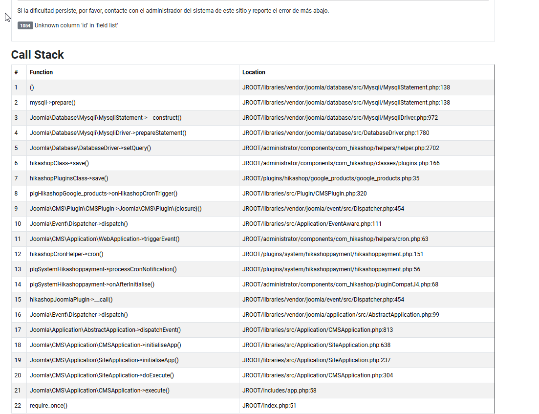

-- Error-message(debug-mod must be tuned on) -- : Error 1054 - Unknown column 'id' in 'field list'
A few days ago I told you about the error I was getting when trying to view the shopping carts. I installed the patch you recommended, but I can see that since then the reminder plugin has not been running correctly.
Error 1054 - Unknown column 'id' in 'field list'.
I’m attaching a screenshot.
  • Posts: 85860
  • Thank you received: 14107
5 months 2 weeks ago #370154
Can you try again to reproduce the issue with the "debug" setting of the Joomla configuration page turned on and provide the full error message you'll get doing so ?

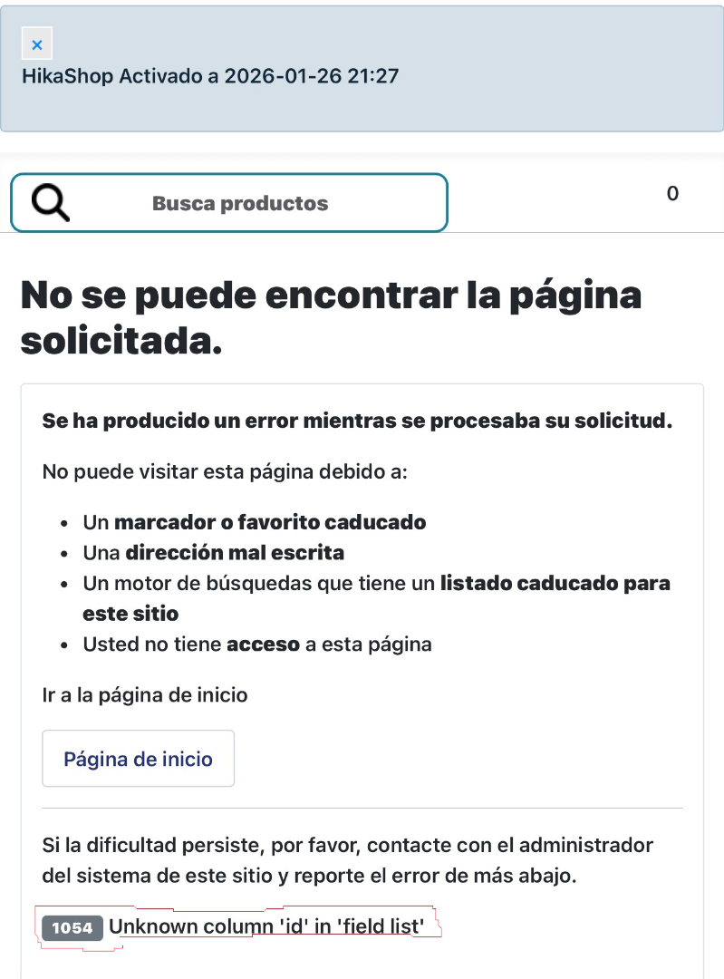

  • Posts: 456
  • Thank you received: 19
5 months 2 weeks ago #370155
Hi Nicolas.
I’m attaching a screenshot showing the messages that appear.
  • Posts: 85860
5 months 2 weeks ago #370157
Thanks. I've made a patch which should help.
Download again the install package of HikaShop and install it on yours to get the patch. You should not have the error anymore.

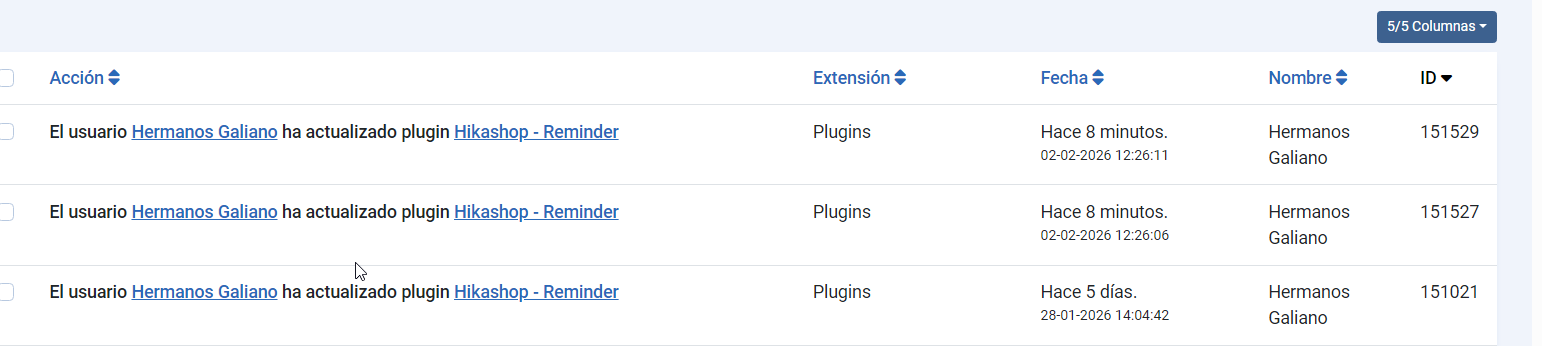

  • Posts: 85860
5 months 1 week ago #370225
There is no uninstall mechanism. The only way to uninstall it is to do it manually as far as I know.
I would recommend double checking the extension manager. Then, reinstall it, reconfigure it, and check that it still works.
Also, you can configure the actions log in Joomla:
docs.joomla.org/J4.x:User_Actions_Log
That way, if it happens again, you should get some log of how it got uninstalled which would help understand how it happened.

5 months 1 week ago #370226
Hi Nicolas.
I have reinstalled the Reminder plugin again.
I ran the cron, it worked correctly, but the plugin has disappeared from the system again.
I’m attaching a screenshot of the user actions log where you can see that the plugin was installed, but there is no record of its uninstallation.
