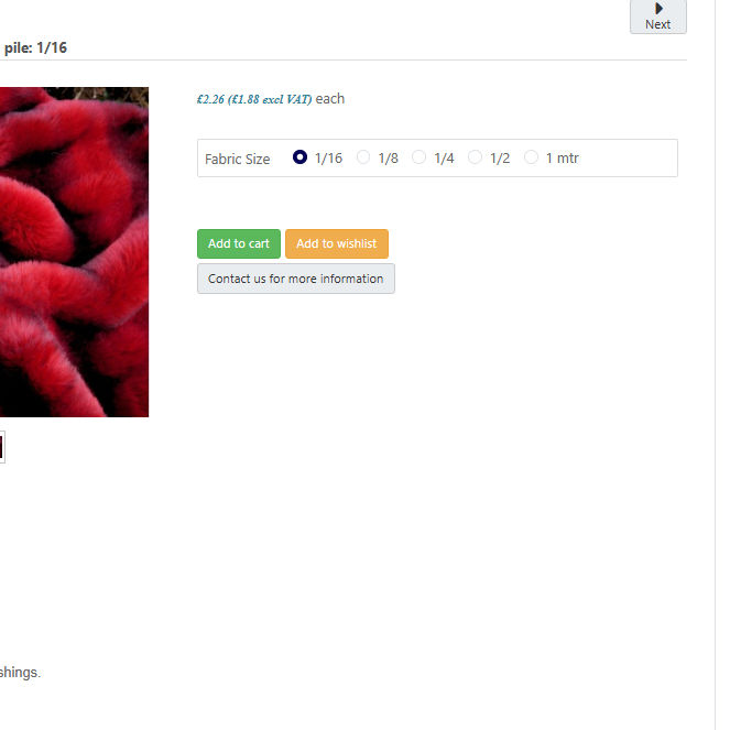

Hi, I have the same issue. It used to show?
All of what you suggested is on but nothing will show on the product page (cart only?)
thanks
  • Posts: 86080
  • Thank you received: 14186
6 months 2 days ago #370573
The "synchronized add to cart" setting should be turned off, not turned on. It's probably your problem.
