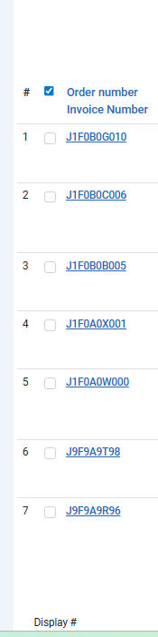

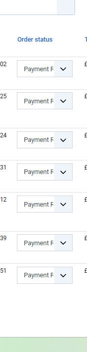

Hi, 2 issues on the back end orders page:
1. cannot 'mass select' like we can on all other back end pages?
2. cannot change the 'status' from outside the order? we used to be able to?
Guessing the 2 are related as they both in the orders page.

This indicates a JavaScript error on the page, which leads to both mechanisms not working. Please provide a backend access so that we can check:
  • Posts: 86080
  • Thank you received: 14186
5 months 3 weeks ago #370669
Looking at the HTML source of your page, I can see that the onchange attributes on the status dropdown selects have been rewritten to on-change (with a hyphen), and the onclick on the mass select checkbox has been rewritten to on-click. These are not valid HTML event attributes, so the browser simply ignores them which is why both features are broken.
This is not coming from HikaShop. Our code outputs the correct onchange and onclick attributes. The modification is most likely done by RSFirewall, which sanitizes inline JavaScript event handlers as part of its XSS protection.
The event handlers may have been sanitized when the override file was created or processed. You can delete the view override for order / listing via the menu Display>Views and it will fix the problem.
You can also configure an exception in RSFirewall's configuration for the HikaShop view overrides so that it doesn't happen again in the future.
