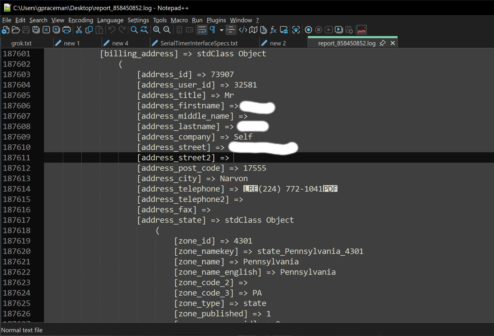

5 months 3 weeks ago #371043
We just had that issue happen again.
When I scan through the payment log, I notice unprintable characters in the phone number for the shipping and billing address. See attached screenshot. This customer had 3 invalid transactions. All 3 had this telephone number issue. This was for a recently created user account.
I will use your contact form to submit login credentials and the affected order#'s, if you need to check on this firsthand.
  • Posts: 86214
  • Thank you received: 14221
5 months 3 weeks ago #371045
Thank you for enabling debug and providing the details. The screenshot confirms the issue: the customer's phone number contains invisible Unicode control characters. Specifically, it has a LEFT-TO-RIGHT EMBEDDING character (U+202A) at the beginning and a POP DIRECTIONAL FORMATTING character (U+202C) at the end. These are invisible in normal display but they are included in the data sent to Authorize.net, and they cause the SHA-512 hash to not match.
This typically happens when a customer copies and pastes their phone number from a source that includes bidirectional text formatting (for example, from certain mobile apps, contacts, or web pages).
To fix this customer's account, edit their billing and shipping addresses in HikaShop and clear the phone number field, then re-type it manually. That will remove the hidden characters.
To prevent this from happening in the future, you can add a regex validation to the phone field. Go to HikaShop > Display > Custom fields, edit the "address_telephone" field, and in the Options tab, set the regex to:
^[0-9\s\+\-\.\(\)]+$
This will only allow numbers, spaces, plus signs, dashes, dots, and parentheses in the phone number, and will reject any invisible characters or letters.
  • Posts: 166
  • Thank you received: 11
5 months 3 weeks ago #371060
The problem that I see with the regex solution is that the customer will get an error message about invalid data entered. Yet they won't be able to see those control characters to see what to fix.
There are other accounts that are affected with this issue. We didn't note every customer that had this issue. So, next time they go to place an order with us, they will run into the same problem. It would seem the best solution would be for HikaShop to filter out any control characters when retrieving any customer entered data (first name, last name, address, telephone#, etc.) from the dBase with respect to the credit card transaction process.
