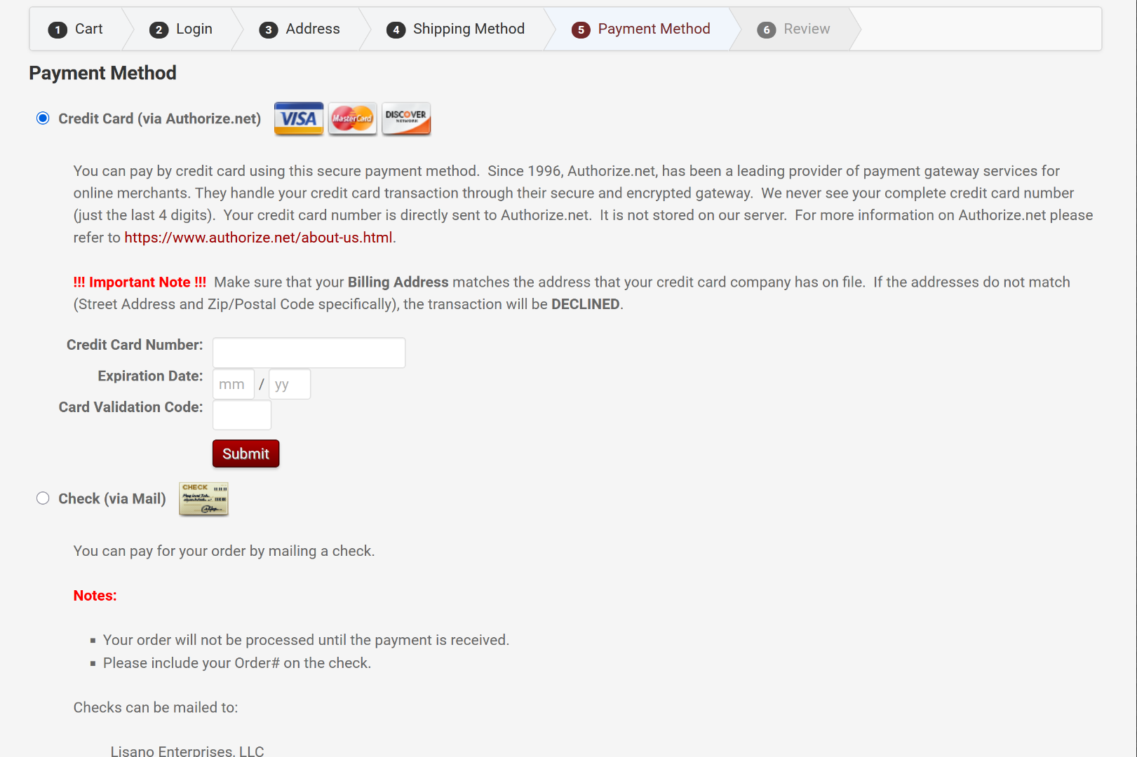

A drawback I see for Authorize JS, over the Authorize SIM plugin, is that we no longer get any notification if a customer has a declined transaction. We can get some customers that have multiple declined transactions. When that happens, we will contact them and let them know the problem. Most often it is a mismatch with their billing address and the address that the credit card company has on file. We do add a message about that in the payment method description (see screenshot), but some customers just don't read when they are in a rush.
Can the plugin be modified to add an option that, when selected, will email the admin when there is a declined transaction?
Also, a bit annoying of an aesthetic issue, is that for the credit card entry fields, the labels are not centered vertically on the text boxes.
Last edit: 3 months 2 weeks ago by gpraceman.
