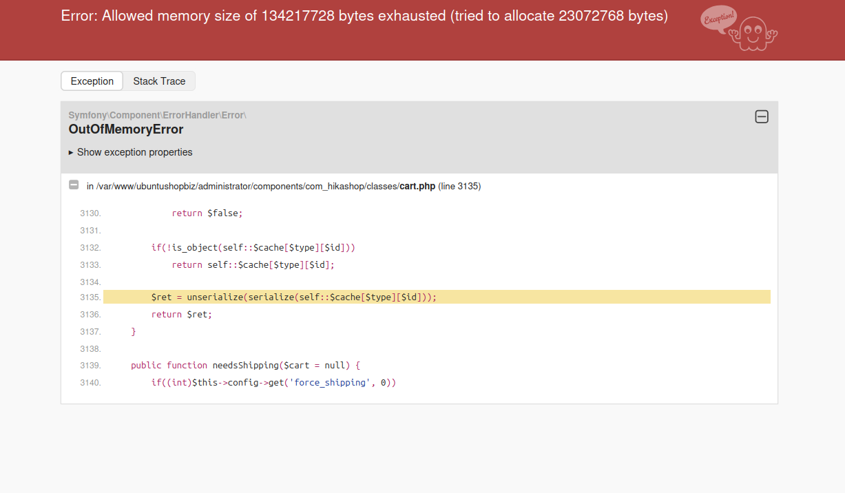

3 months 3 weeks ago #371724
screenshots
stack trace:
OutOfMemoryError
Symfony\Component\ErrorHandler\Error\OutOfMemoryError:
Error: Allowed memory size of 134217728 bytes exhausted (tried to allocate 23072768 bytes)
at /var/www/ubuntushopbiz/administrator/components/com_hikashop/classes/cart.php:3135
Last edit: 3 months 3 weeks ago by duportail.

3 months 3 weeks ago #371726
So what is the exact URL of the page with that error ?
To me, it looks like you're trying to display a listing of carts. Each cart is several MB of memory, and with only 128M of memory_limit configured in the php.ini of your hosting, it hits the limits after a bunch of carts are loaded.
Why the carts on your website are so big, I'm not sure though.
The simplest would probably to try to increase the memory limit to 256 or 512 and see if that helps.

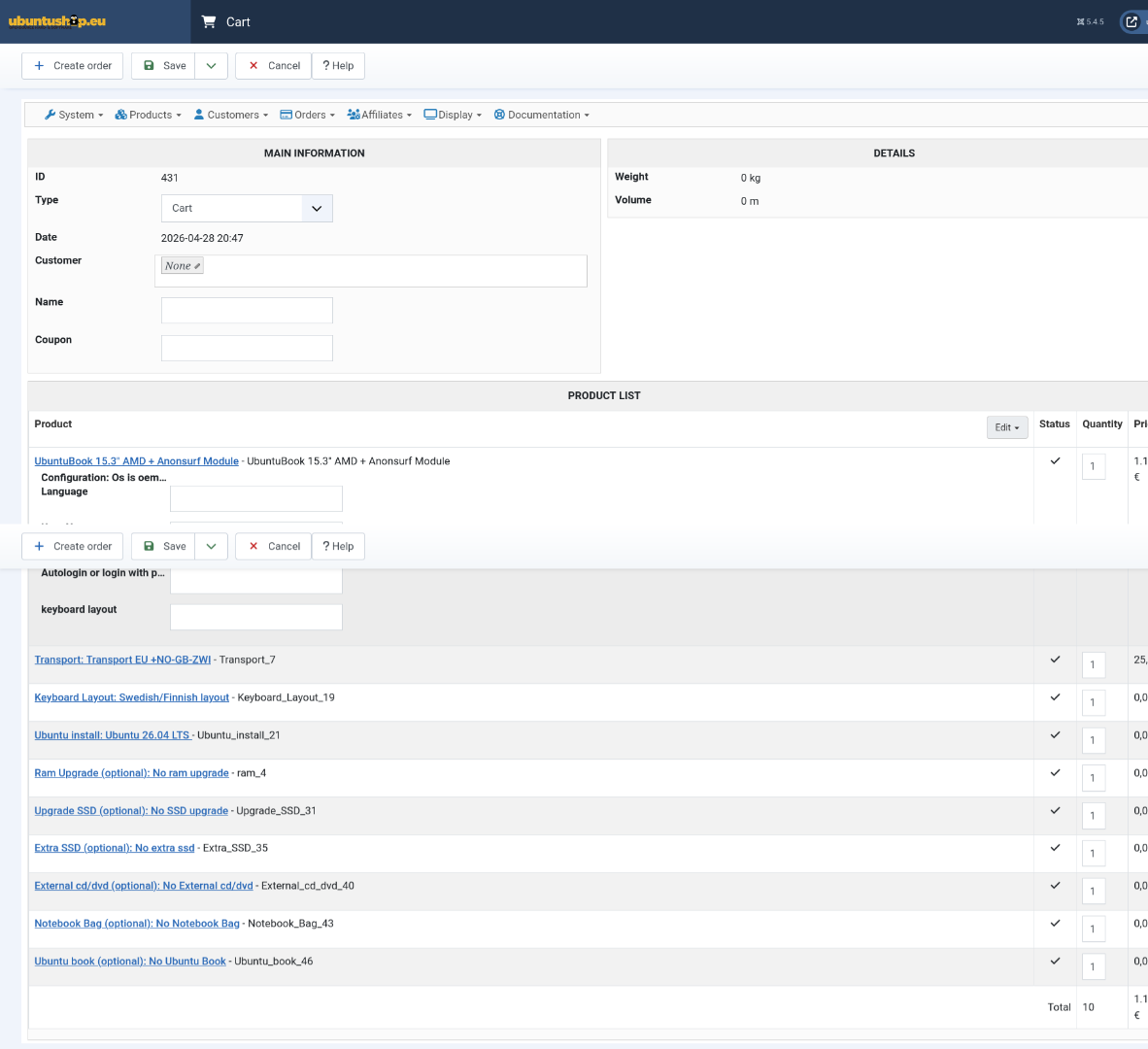

3 months 2 weeks ago #371730
url:
www.ubuntushop.biz/administrator/index.p...rt&task=edit&cid=431
raise memory solved this.
attached screenshot cart
  • Posts: 86056
  • Thank you received: 14181
3 months 2 weeks ago #371740
Was the error on that page or on the page after you click "cancel" ? If it was on the page after you click on cancel, it's quite normal. It's the listing of carts. The system has to load the full data of all the carts to be able to calculate the total, etc on that listing. That's quite heavy. If you have a lot of carts per page, it can lead to a lot of memory being used.
Anyways, that's not too much of a concern. It's not really a bug. Just something that requires a lot of resources due to its nature.
