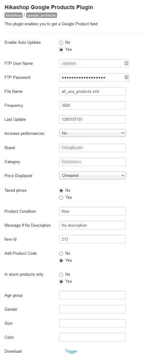

  • Posts: 68
  • Thank you received: 6
12 years 8 months ago #138975
Ok thanks for the clarification about DS.
The plugin configuration is straightforward and we have double-checked everything. See screenshot attached.
But I may have a clue. I always tried to connect FTP to uploads.google.com manually to confirm credentials but I never tried to actually manually upload an XML file.
It appears it does not work for me anymore. I get a Connection timed out when trying to put s file.
Can someone try it out to confirm whether the issue is only for my account?
