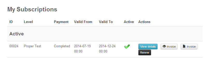

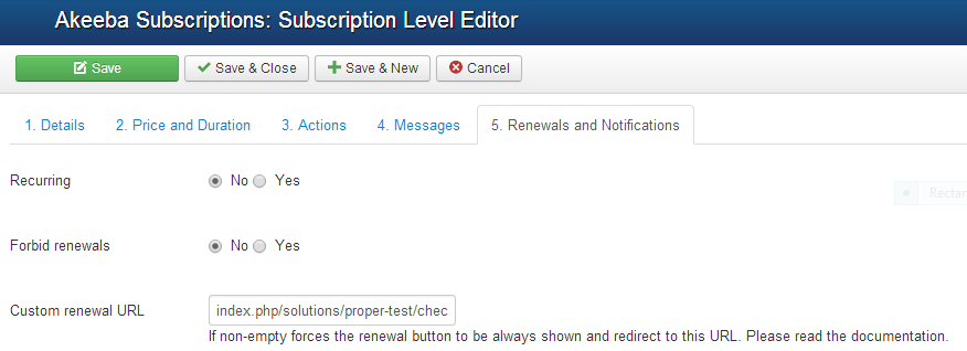

2. In the email sent by Akeeba Subs it sends a URL to manage your subscriptions, you go there and it takes you to a "My Subscriptions" page. On there I can see my current order, when I try click "renew" (Image: AkeebaURL3) it doesnt use the custom URL I specified in the Subscription Level itself. Please see attached image (AkeebaURL1). Basically that URL never applies itself correctly, I suspect an issue with the logic in the code itself.
The link that should be used for the custom URL is actually a Hikashop Link with Checkout specified, so basically they just buying my item again when they click the renew button. But the URL is not applied. ie. "index.php/solutions/proper-test/checkout" when appended to my domain will check out the item and start the checkout process.

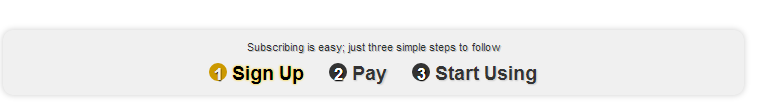

(Image: AkeebaURL2) is the actual page I get to when I click Renew.

2. This is more a Akeeba subscription issue, we don't manage the emails sent by Akeeba. As link, you can provide the default HikaShop link to the orders page.

Re 2. Managed to sort it out, seems there was a problem with the $CanRenew and $RenewURL, so just told it to always use the custom value irrespective :)
