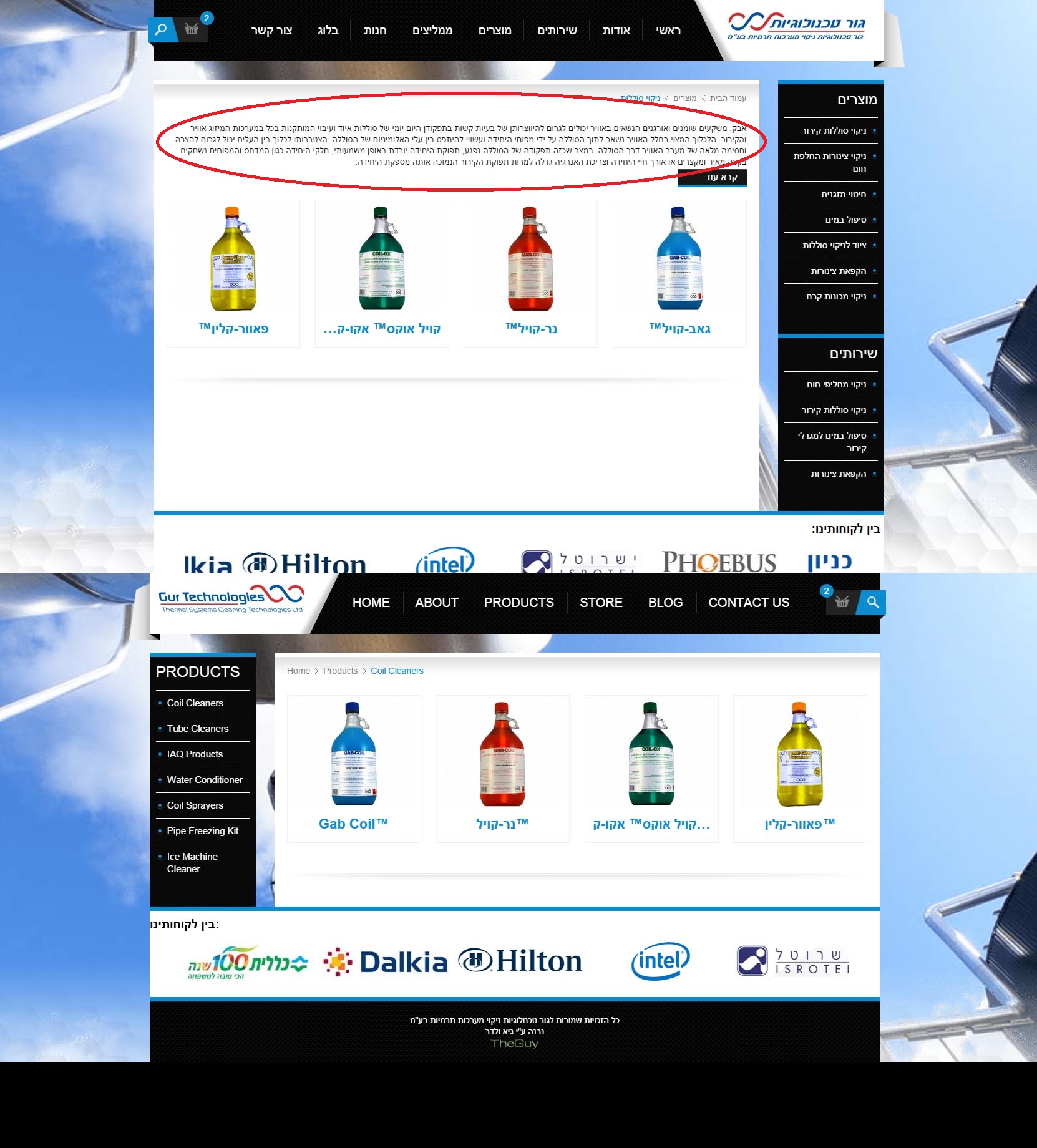

I'm using HikaShop essential on a multilingual site with Hebrew and English. I've setup Hikashop in Hebrew at first and now I'm working on translating it to English. I've successfully installed Falang and all Hikashop fields are showing in the component list. I've enabled the "Activate the edition of content in multiple languages" and the "Translation published by default" under the language settings.
I've made an attempt to translate one of my products categories and the result was not promising. The translation did not show up at all:
In this link you can see one of my categories in Hebrew:
gurtech.guywalderonline.com/index.php/he...9%D7%9D/category/13-
In this link you can see the same category but in English:
gurtech.guywalderonline.com/index.php/en/products/category/13-

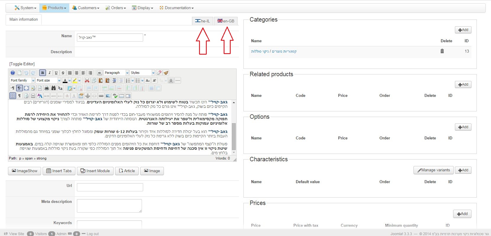

BTW, is there an option to add the flags of translation to the custom fields in Hikashop just like in the product description so my client could edit the translations directly from the product?
See attached image of the flags I'm talking about.

1.Yes, the products names are being translated. And so does the products themselves. But, the category's descriptions are not being translated. Please see attached screen shot.

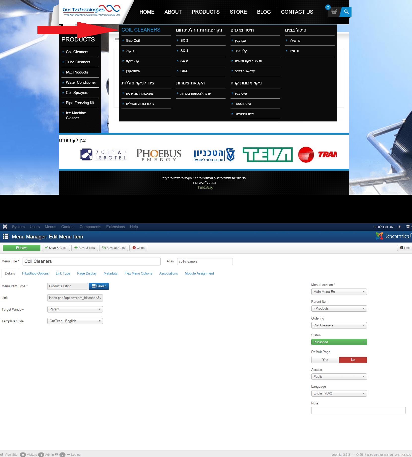

But something is REALLY messed up here. The first product "coil-cleaners" works fine but all the others get "category" added after "products" in the url and then the translation does not appear. If I set "Remove products and categories id in URLs" to yes "Tube Cleaners" stops working.... :blink:
Found the source of the bug/feature. I had change the menu item pointing to the categories to something else, save it and then I had to manually assign the menus, in HikaShop menus page, to each category all over again for some reason. You should check this thing out as I believe I've stumbled over a bug...
2. I've tried to enable "Remove products and categories id in URLs" (it was off) but it made no difference. As for "sub element filter", I tried that as well, no change. It must be related to the fact that my menu items which are set to "Products listing" and not clickable as well and I didn't find a way to fix that as well (Please see second screen shot).
Update: This problem was solved along with the fix in part one.

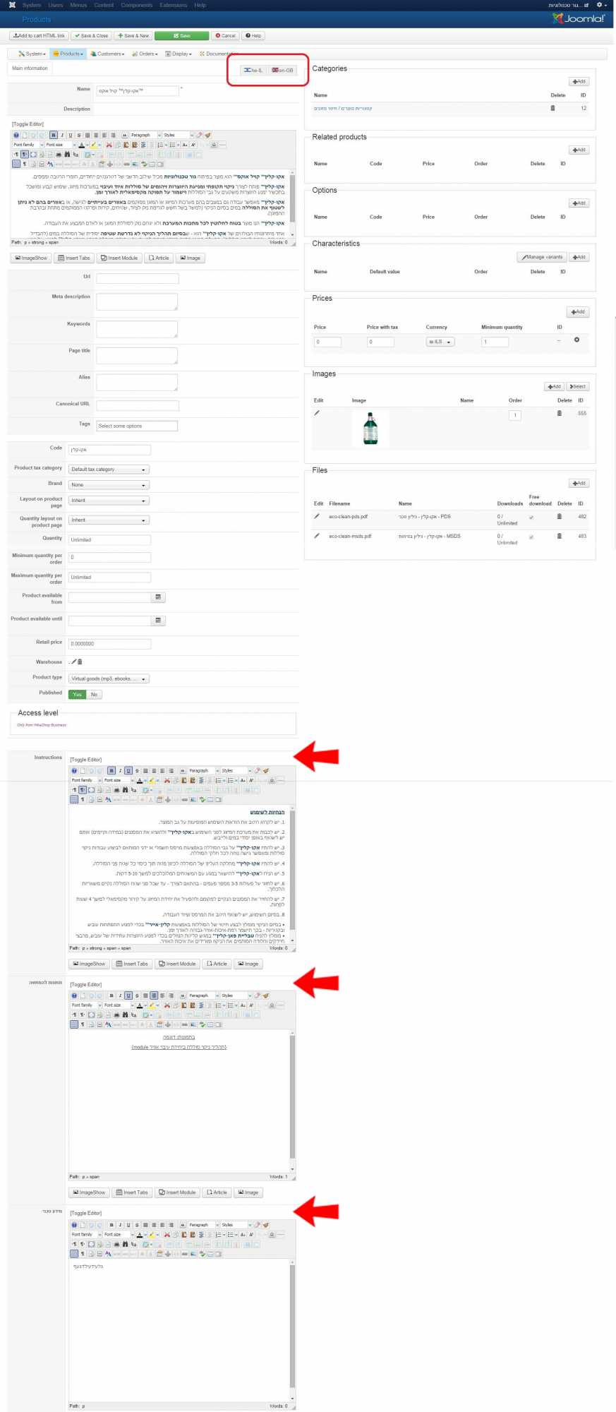

After I've enabled the multilingual option each product and category description got additional flags at the top of the WYSIWYG to manage the translations.
My products are comprised of many custom HTML fields which must be translated as well. As for today, in order to translate a custom field I need to do it via FaLang's interface.
My question was, is there a way to add the translation flags to other fields as well? In my case, to the custom fields.
Please see attached image with one of my products back-end for example. The flags are marked by a red box and the custom fields are marked with a red arrow.

We don't have that possibility for now. The custom fields have to be translated via Falang.
That's something we would like to do in the future.
