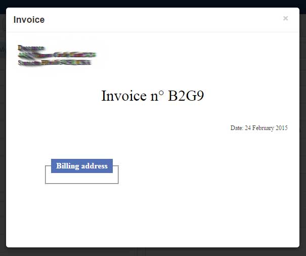

I have installed the PDF Invoice Plugin and in the plugin settings I have set the "Statuses for email attachment" to "confirmed" and all other settings are at default.
With this plugin enabled, when an order is successfully paid for through Paypal, the customer does not receive the order confirmation email and no payment confirmation email is received by the site administrator. The order creation email is received every time though. If I turn the PDF Invoice plugin off, then all emails are received fine.
When I go to the back end and generate an invoice by clicking the invoice button in the order detail screen, the popup that opens to display the PDF invoice displays a partly formed invoice only. I am attaching a screen shot of that popup.
Also, I do not find any invoice generated in the /plugins/hikashop/attachinvoice/attachinvoice/invoices directory. It seems that the plugin is not able to create the PDF invoice as a result of which the order confirmation email does not get sent out at all to the customer and neither does the payment confirmation email gets sent out to the administrator.
Thanks in advance for your help in resolving this.

I think you should have a PHP error due to a too old HikaShop version.
The function "displayAddress" is not available in HikaShop 2.2.2 ; you should update to the last one (2.3.5)

A further update to my earlier message. After changing the code as mentioned earlier, my customers are able to receive confirmation emails along with the attached PDF invoice. Now I am facing two new problems as follows:
1. In spite of setting Override Front End and Back End to Yes in the plugin parameters, my Print button for the invoice on the front end is not overridden. I still get to see the regular invoice (not the PDF version) when I click Print button in the order detail screen on the front end. Is there some other way for the customer to be able to download a PDF version of the invoice on the front end?
2. In the Back End, when I click the Invoice button I momentarily get to see part of the PDF invoice being rendered and then immediately in less than a second the page redirects to www.mysite/adminsitrator/index.php .
I can't figure out why this is happening. Any help will be much appreciated.
