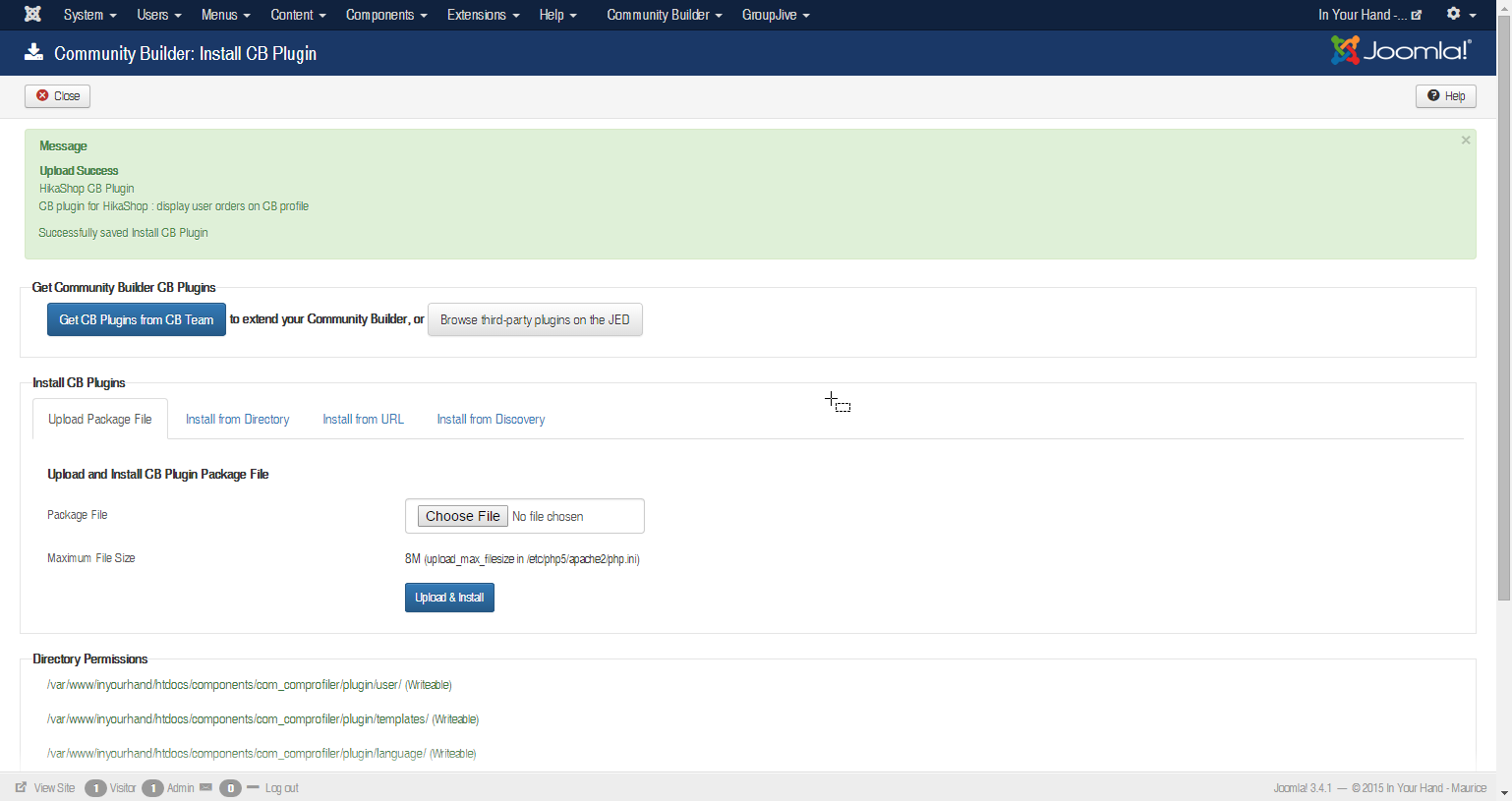

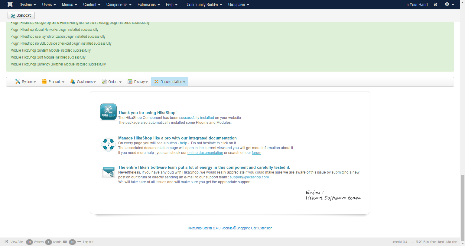

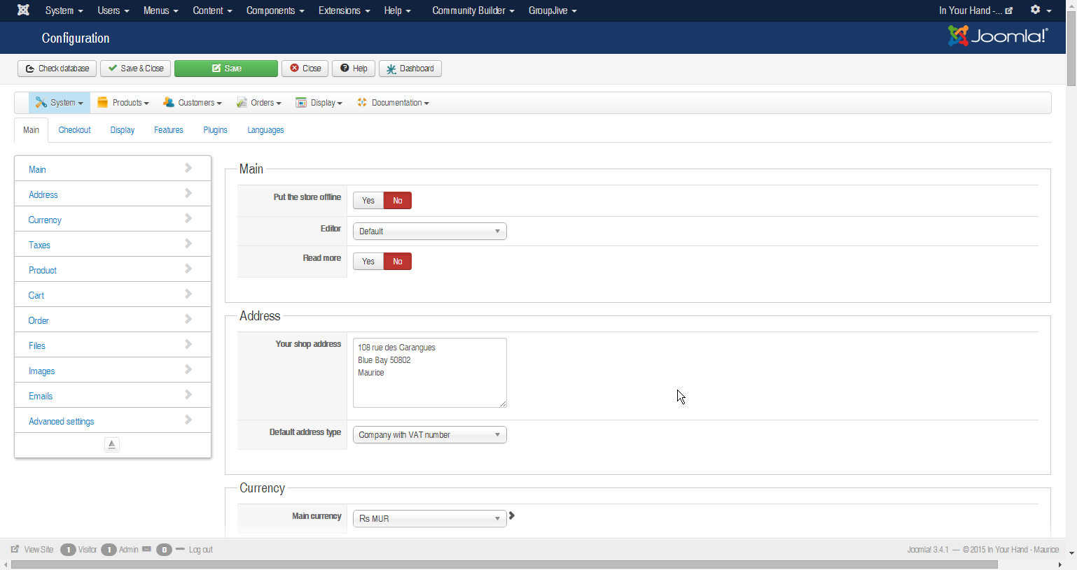

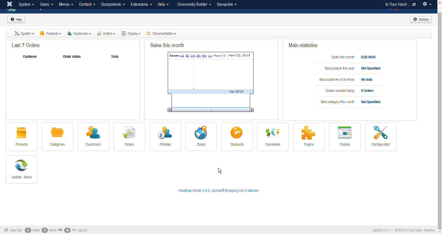

thank you for your reply. So I have uninstall CB Hihashop plugin and Hikashop component from Joomla. I have installed it again successfully (see attachment) from the following zip file (com_hikashop_starter_v2.4.0_2015-04-17_17-28-46.zip). After that, I have checked that I can at least go to Hikashop Control panel and I have changed some basic information in Configuration. All the things are right. Next, I have enabled and displayed the CB plugin on user profile but the problem is still occuring. So I decided to check if the helper.php file exists on the system.

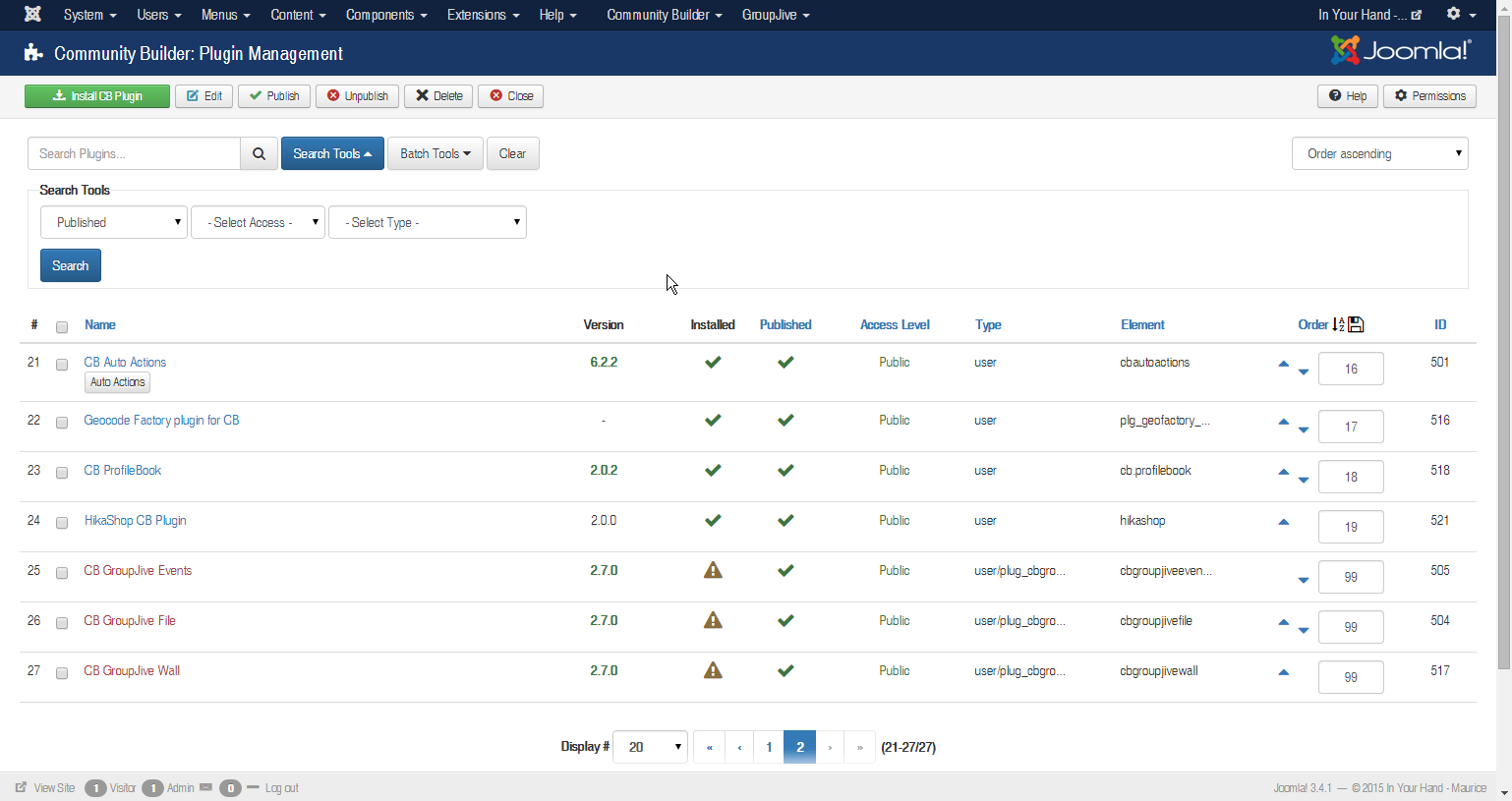

my probem has been solved by downloading a new CB plugin (see post 195344). The code is slightly different but it works now! For the moment I connot see the tab but it seems that it only appears if I buy something on Hikashop. Many thanks for you help and maybe you can put this release for public downloading.

Xavier didn't update the plugin on the FTP after applying his patch.
I just fixed it.
