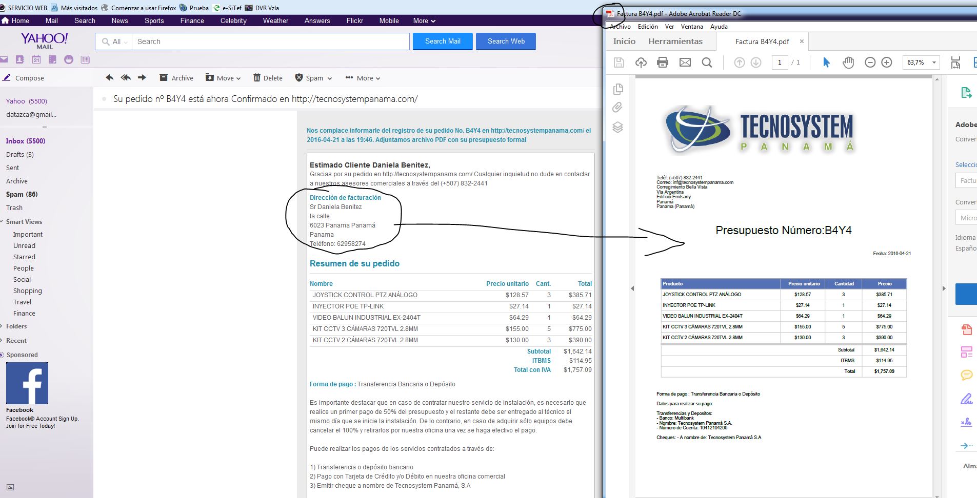

10 years 7 months ago #234797
by tecnosystempanama
Replied by tecnosystempanama on topic PDF plugin
Excellent, that was exactly what I need, is there a way to send the invoice in guest mode, with the name included? Because right now in guest mode only sends the invoice with the email in it and I need the name too(i don't need the users to be registered)

10 years 7 months ago #237859
Thanks friends,
The billing address works exactly how I need, but now I need that the information of the billing address to be show in the PDF Invoice, How can I do that? because right now is not showing the shipping address in the pdf invoice
10 years 7 months ago #237872
by nicolas
Replied by nicolas on topic PDF plugin
The billing address is displayed automatically on the PDF invoice thanks to this code:
so if you don't see the billing address in the PDF invoice even though you have it in the order, I can only think that you've modified the code in invoice.php and these modifications caused the issue.

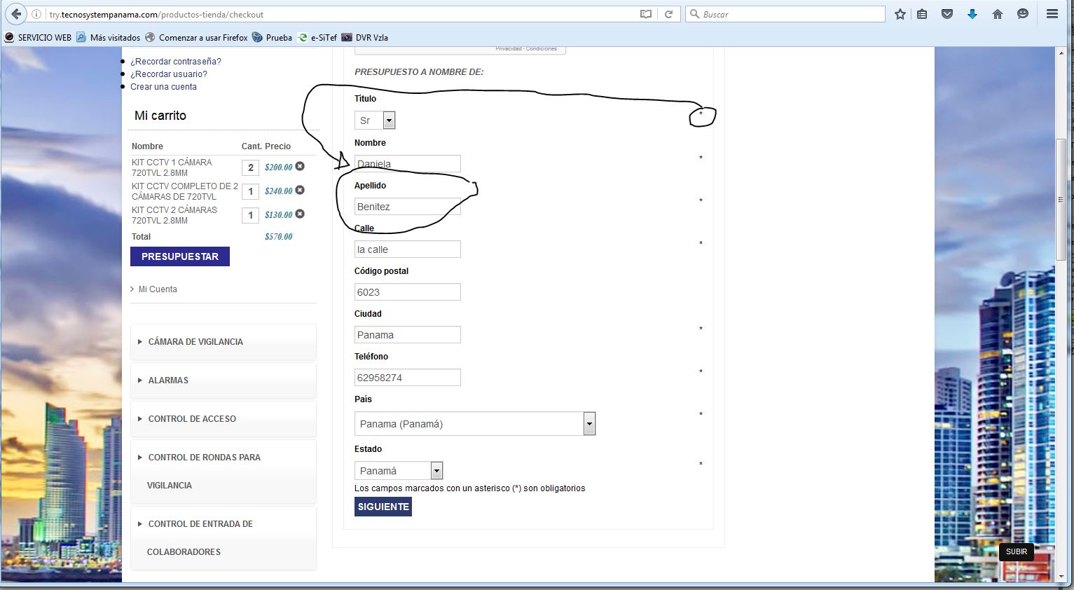

- tecnosystempanama
Topic Author
- Offline
Less
More
- Posts: 34
- Thank you received: 0
10 years 7 months ago #237960
Hi friends,
Thank you so much for your help. it works exactly as a I needed, now I just need to take off the last name of the billing form. and change the "*" from right to left.
Could you help me? Thanks in advance for all your help
10 years 7 months ago #237978
by nicolas
Add such CSS on your website and that should do it:
.hikashop_field_required {
float: none !important;

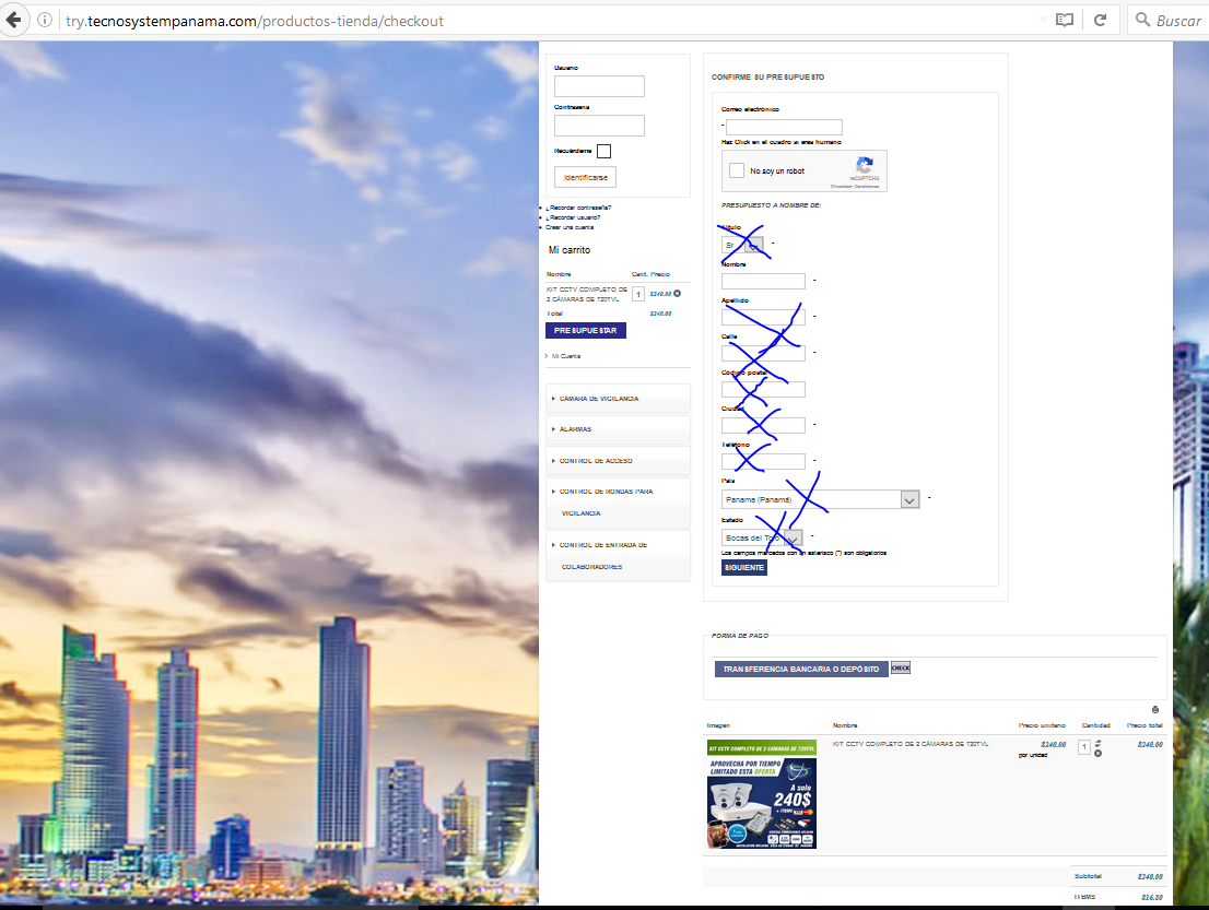

- tecnosystempanama
Topic Author
- Offline
Less
More
- Posts: 34
10 years 6 months ago #238295
Hi Friends,
Thanks you so much for your help, you've been really helpful. Could you help to edit the billing address form, I just need the field name, and erase the others fields of the form. Is that possible?
Thanks in advance for your soon reply
10 years 6 months ago #238326
by nicolas
It's possible yes. Just disable these fields via the menu Display>Custom fields.
PS: please open new threads for new unrelated questions.
