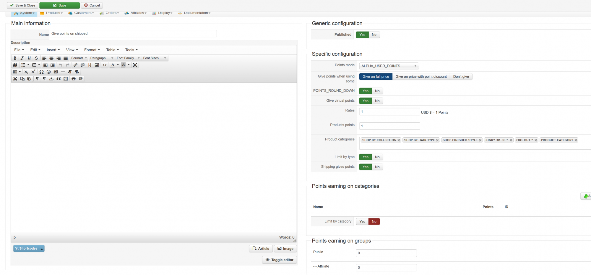

Attached are the screenshots. I am honestly hoping to fix this soon. As you can see, I opened this thread two months ago and before then, I talked with Hikashop team via email for over a month. It is almost four months that I am trying to resolve this.
Like I explained in previous email, we tried to keep setting like life site but on shipped order, it is not giving points:(
Thanks for your time.
I am not sure if properly configured...

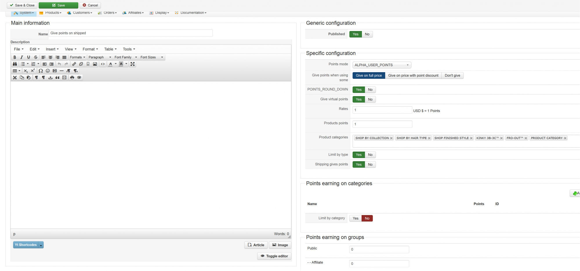

  • Posts: 26376
9 years 11 months ago #247651
You are not using the "User Points" plugin but a very old "AlphaUserPoints" plugins which is deprecated since a long time.
That old plugin is no more provided in the HikaShop packages since the "user points" plugin have been release stable.
Please use the HikaShop "user points" plugin in order to have something functional and with the HikaShop support team can provide support.
www.hikashop.com/support/documentation/257-using-points.html

9 years 11 months ago #247688
I have a look on previous thread, and see that Jerome suggest you to use HikaShop User point, but you decline this proposal for use Alta User point from your own word...
BUT from we can see on your screenshot you use Alpha User Points, and so on this point nothing change this plugin isn't supported anymore, AND we don't recommend to use it.
Did you read our HikaShop user point, here ?

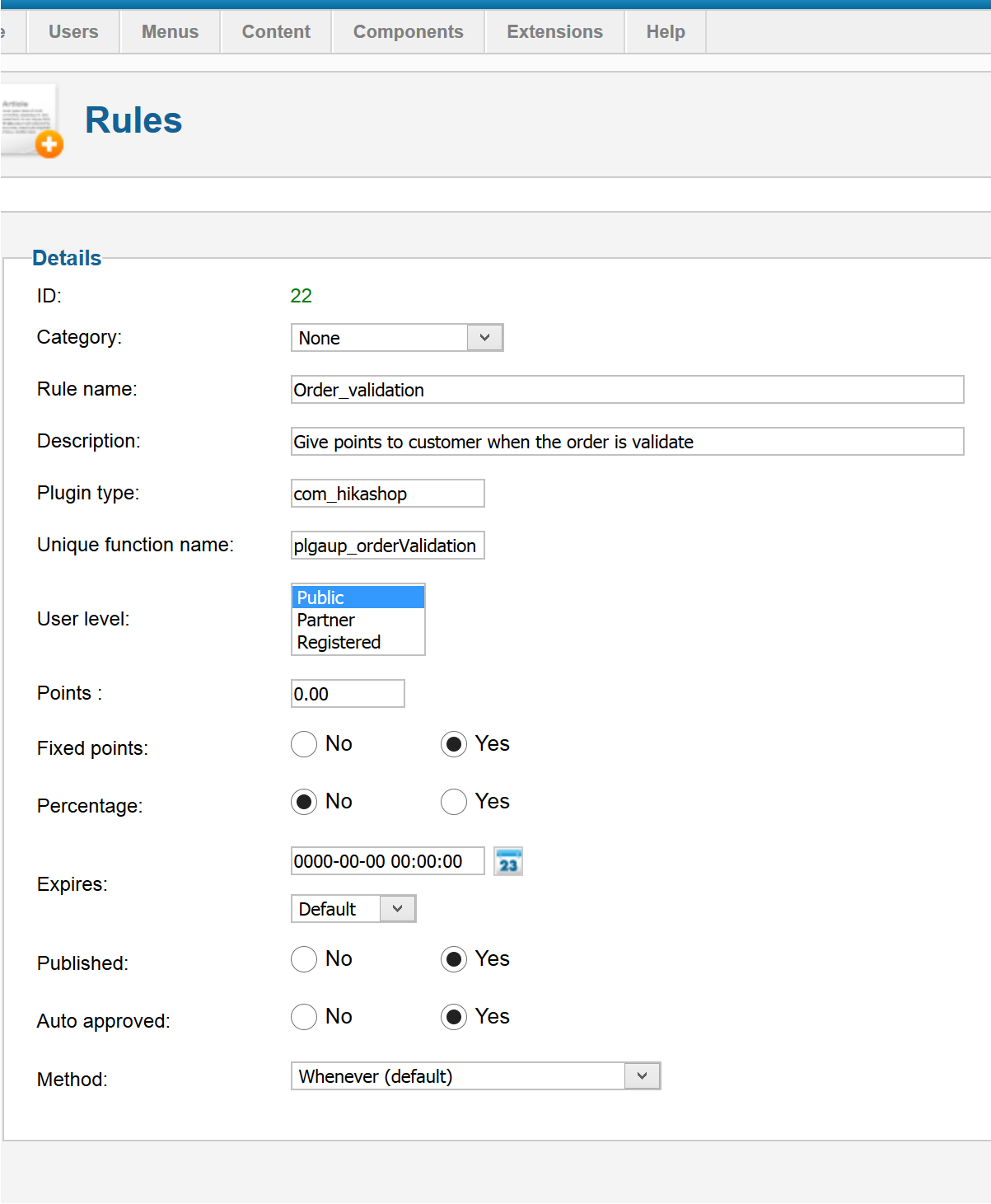

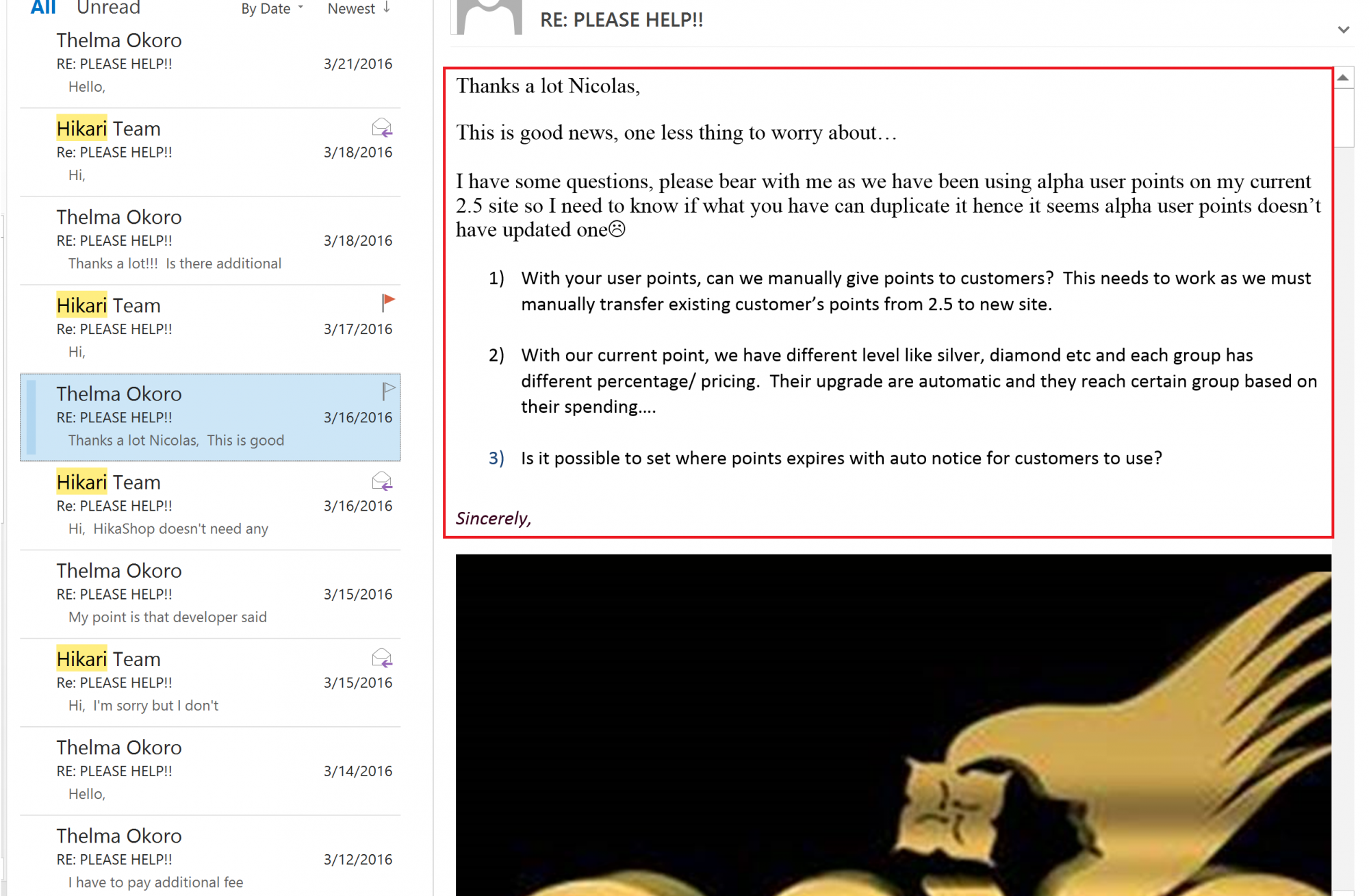

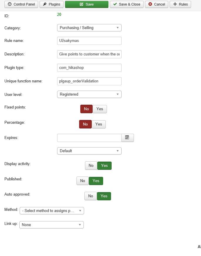

  • Posts: 101
9 years 11 months ago #247716

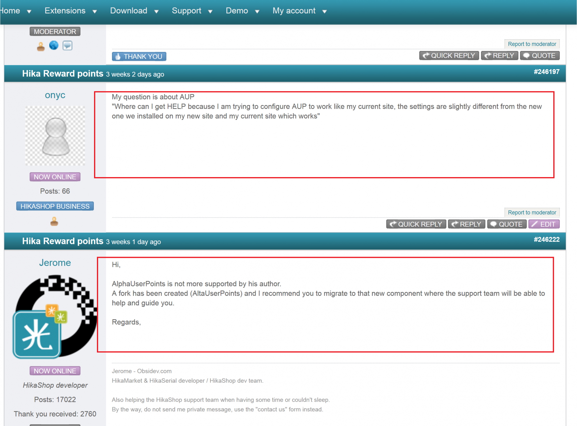

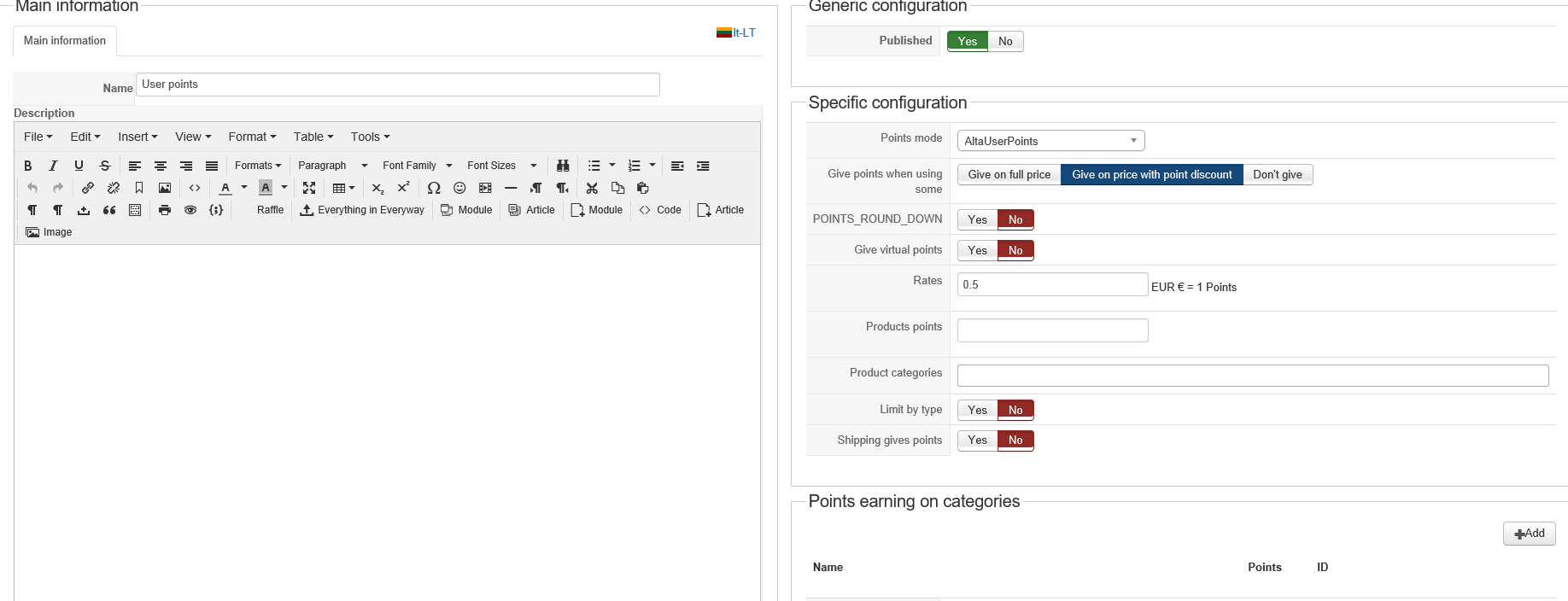

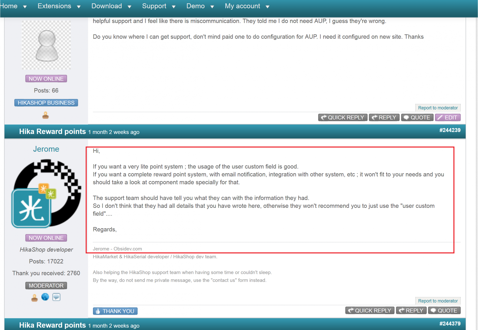

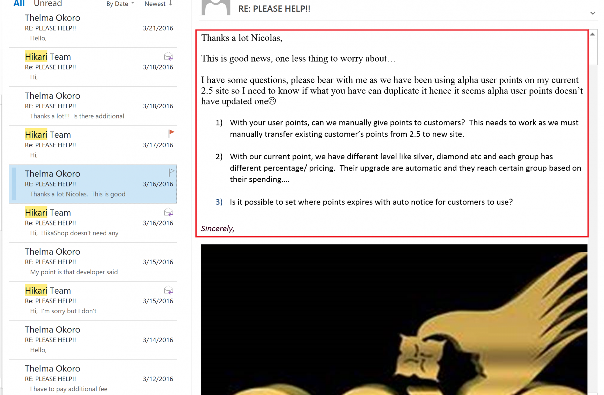

That is NOT the fact. It has been whooping 5 months I have been trying to make this work, UNBELIEVABLE.

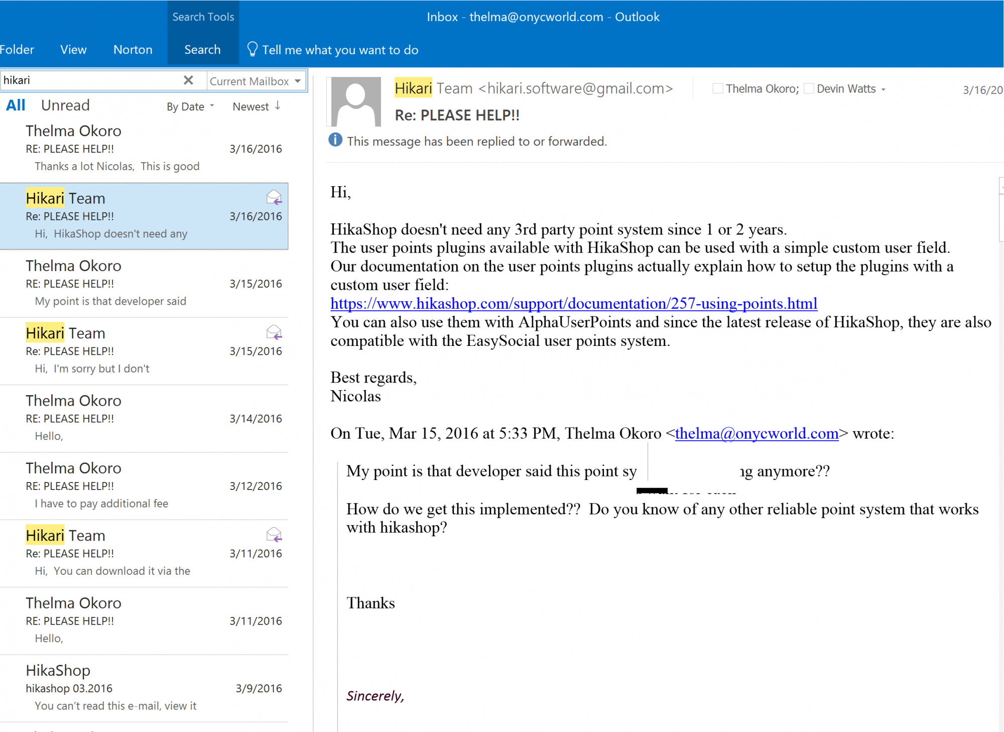

1) First I contacted you guys via email. All I wanted is to simply to find an alternative to current point system and was asking for your advice view image “1”, ““1 my initial question via email “ and “your response”

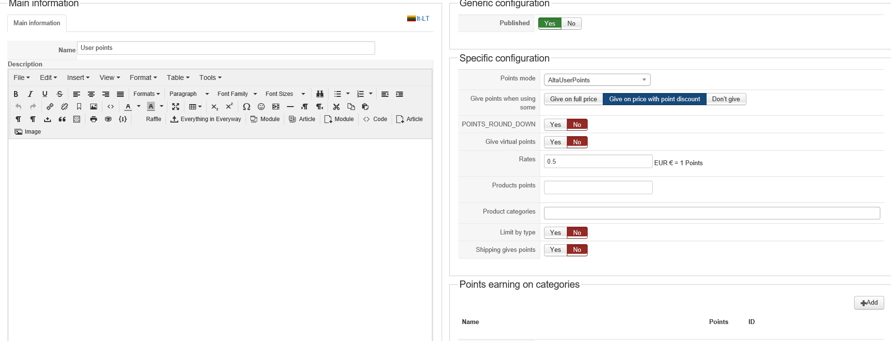

You guys recommended your point system “Nicolas" to be precise.

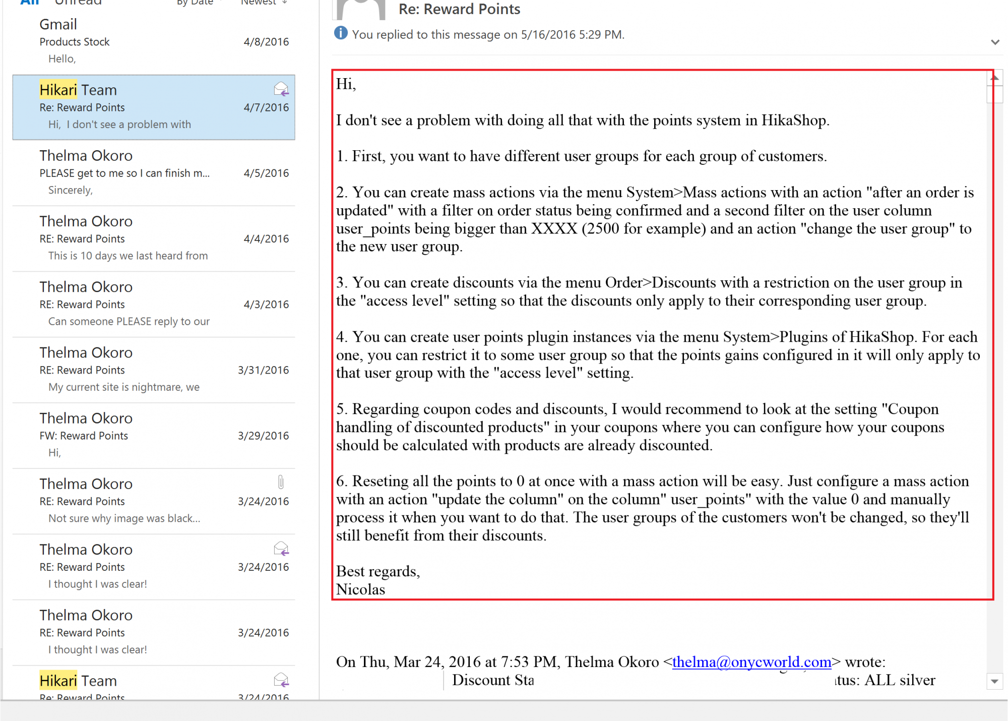

2) We implemented it and it was NOT working and I contacted you. I have at LEAST over 20 emails I sent to you SO MANY times and NO response which is why I posted on forum.
3) Now after asking my question on forum, I was told your point system cannot perform my need “image “2” BUT via email I was told it will as you can see in my communication with you guys. ALL I NEED is a substitute for current system that can give points to customers on orders. This is by far the MOST frustrating and conflicting response I have gotten.

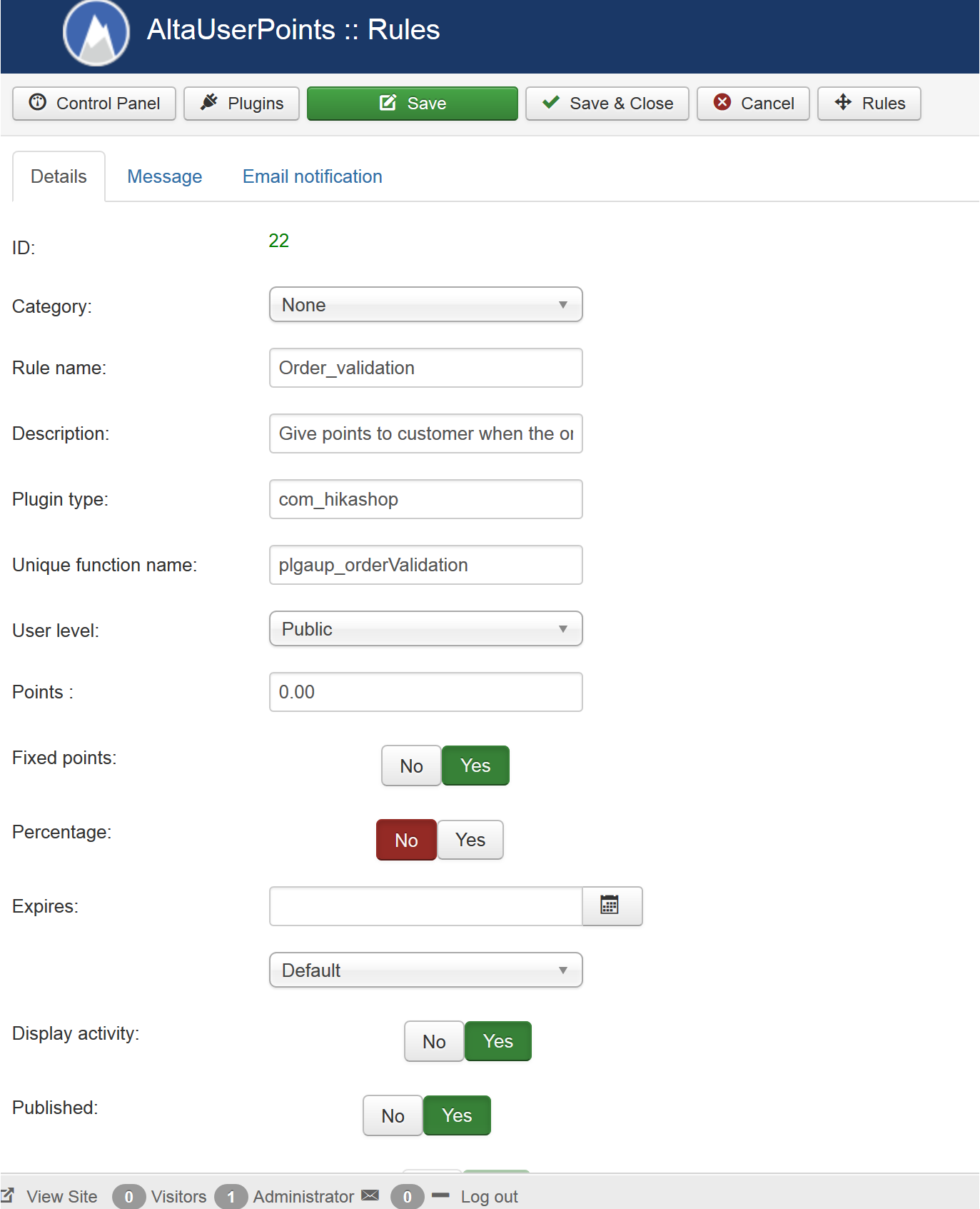

4) I then asked you for solution and was recommended to use “ALTA User Points” “image 3” I was told it will work and there is support for me.
5) I followed the guide and NOT working, the guy from “Alta User Point” said I should contact you? Please read my communications…
6) Now you are asking me to use your point system again??? I do not mind using it but we were stuck and I BEGGED you many times to give you login and you declined and I was told it won’t fit my NEED. Please explain what is really going on here?
Have sympathy and check this and provide me reliable and accurate solution, I am FED UP . I have paid for support and I feel like I am not getting support, we have both wasted too much time and this is costing me a lot because my current site is HORRIBLE.

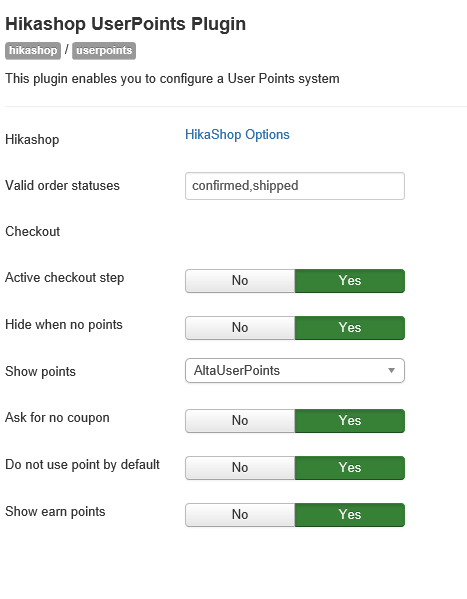

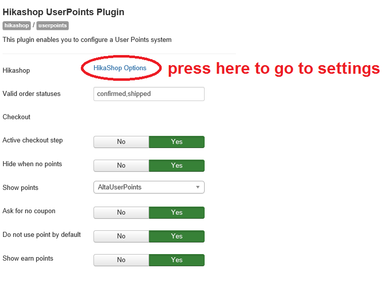

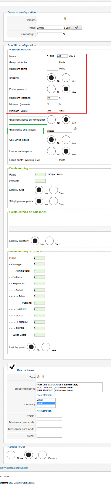

1. After reading and following this topic I can say that @Onyc you should clearly ask questions. As I understand the problem is this:
1) The order validation is not working. I need points given on shipped order and deducted on returned order.
2) I also need customers to be able to order using points.
2. You gave your live site which is using alphauserpoints screenshots and test site which is using altauserpoints screenshots. And hika devs thought you are using old alphauserpoints....So next time you should clearly write you question and what you adding as screenshots...
3. I am using alteruserpoints my self and everything is working fine. Customers can pay with points(altauserpoints) if they have some.
Please take a look at screenshots attached. This is my configuration....The tricky part is that in hikashop user points payment plugin you should still set to alphauserpoints for unknown reason or it wont work...
Hope that helps.

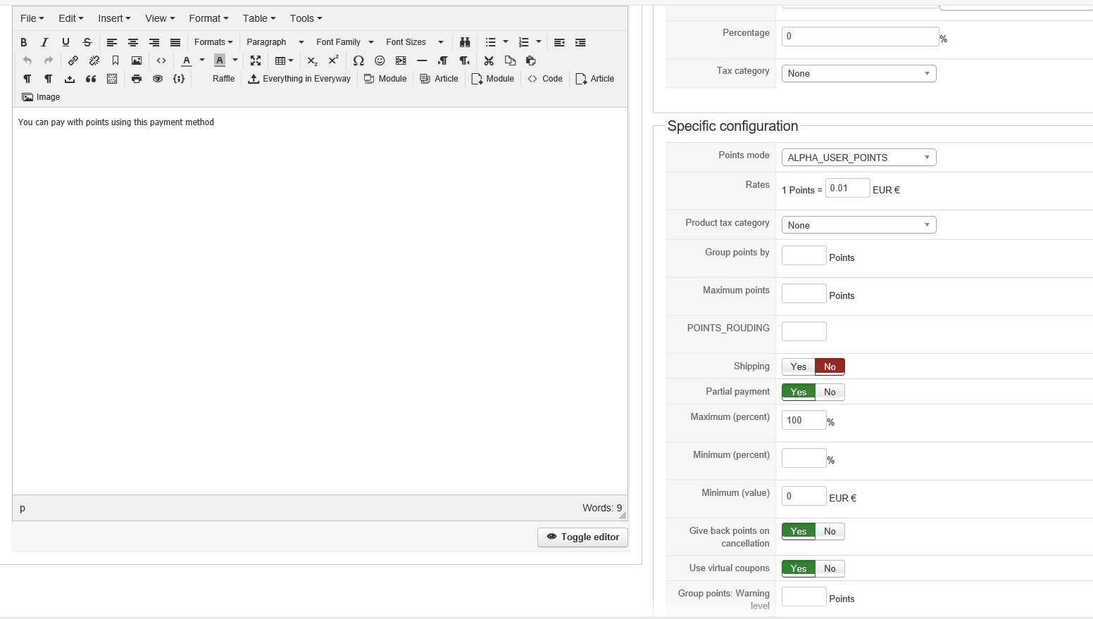

2) For hikashop user points payment plugin: Can you help me with this plugin so my developer can install? Because what I have is different so maybe that’s why not working. There no option to “set to alphauserpoints”
3) User points: I cannot find this on my site?
4) We have both "Hikashop Altauserpoints Payment Plugin" and "Hikashop Alphauserpoints Payment Plugin" enabled. Which one should we use?

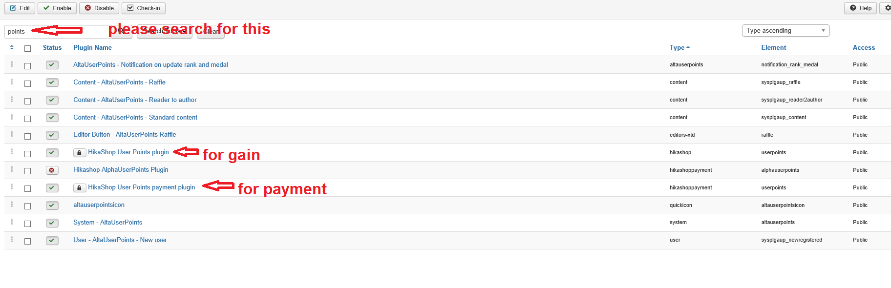

1.It means "Order" in my language I have written it because user can see for what they have received points in alta user points menu in user account....
2. This should be preinstalled with hikashop itself.
3. Same. should be preinstalled with hikashop.
4. I do not have hikashop altauserpoints payment plugin only alphauserpoints payment plugin( it is unpublished and I do not use it). As I said I use 2 plugins. "HikaShop User Points plugin", "HikaShop User Points payment plugin".
Please go to joomla plugin manager and search for "points" You should see these 2 plugins I use... Screenshot attached.

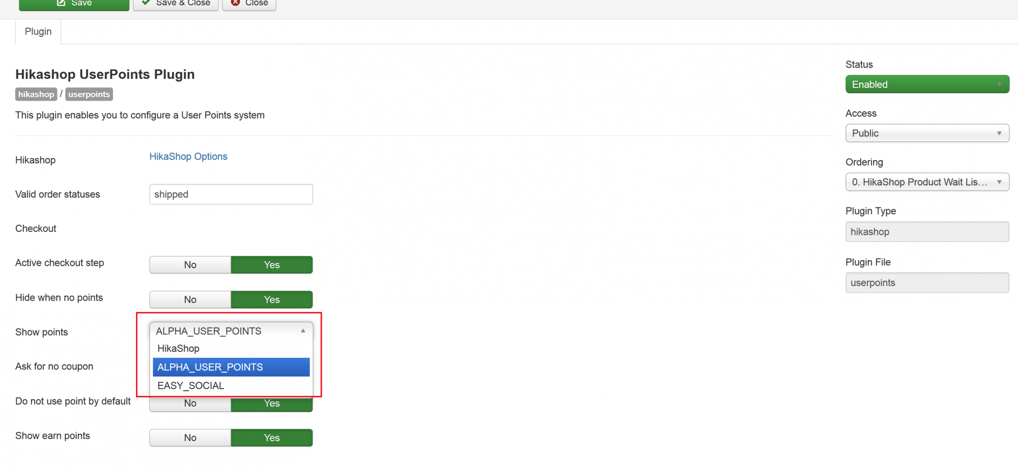

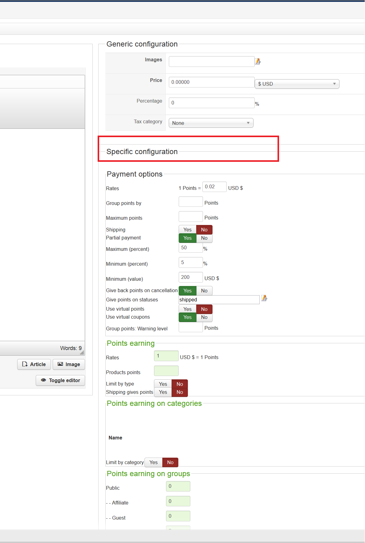

  • Posts: 101
9 years 11 months ago #247821
Hello, after proper review, I noticed:
1) Hikashop UserPoints Plugin: I am not sure why it is saying “alpha user points” and not “altauser points” like yours even though we have installed “alta user points” Not giving me that option either… Not sure if developer installed correctly?
2) About your second screenshot: When I follow your guide “press here to go to setting” I get “UserPoints Plugin setting” image. Is this how your setting is?
3) For hikashop user points payment plugin: This is located on system> payment method. Like I told you
Ours is missing “specific configuration” Not like yours I have contacted a guy that charged me and he set this up referencing my life site but not working and he is not replying so I have asked him for a refund.

9 years 11 months ago #247829
I am not sure but it looks like you have old hikashop user points plugin which used alphauserpoints. I have extracted my plugin and attached it here, please download and install it. Or you should reinstall your hikashop version to get latest plugins...I HOPE you are doing these all modifications on your TEST site as I don't want to be responsible for any damage!
Attachment removed by a moderator.
do not share plugins or elements coming from commercial edition of HikaShop ; that is again the terms & conditions.
Hope this will fix your problem.
