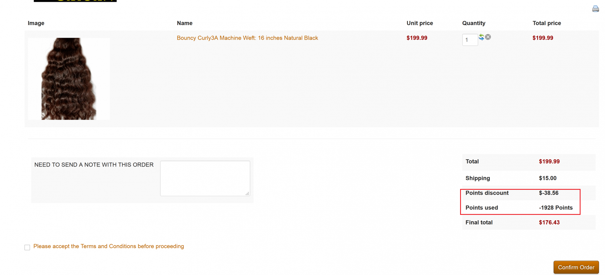

But now I have a concern regarding using points to partially pay for order. On my current site on attached, we have where point credit loads automatically. It is not loading on test site :( How do we achieve this?
FYI: there is enough point on the account I am using to test it!

9 years 11 months ago #248059
When you edit the HikaShop user points plugin via the Joomla plugins manager, you can see this option:
take.ms/5HI7j
It it probably configured differently between the two websites.

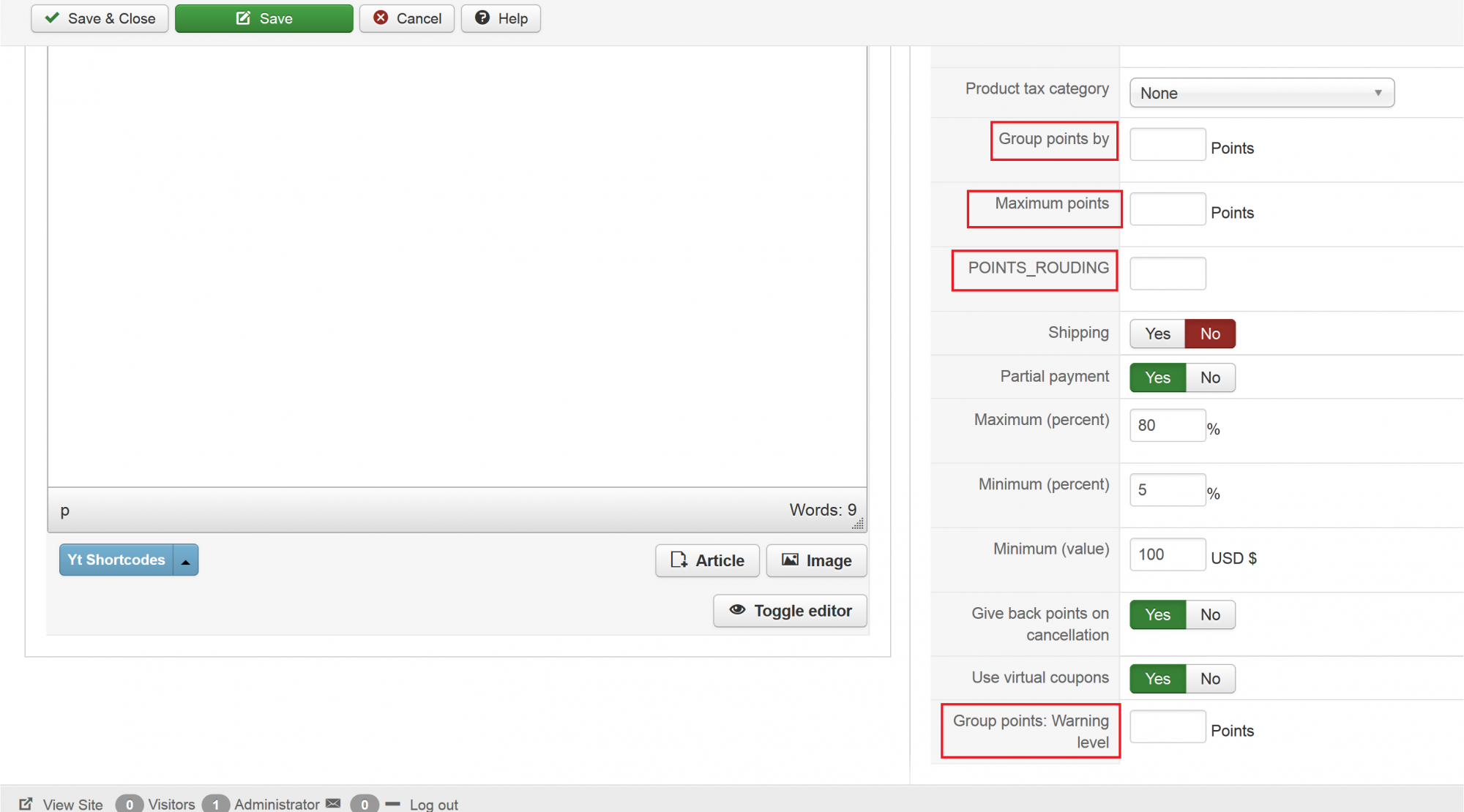

Hmmm, this is a big headache:( The Alta user point people are not quick in replying to me and I am Launching my site on Friday so I have only a few days for plan B.
1) Please view image “payment with points” Can you explain to me what the options in red really means, might help me to figure out something...?
i) Group points by?
ii) Maximum points?
iii) POINTS_ROUDING?
iv) Group points: Warning level?
2)Also, on this payment setting, is there how we can set a minimum point reach so they can only use points over that? For instance, the gold member which must reach 2500 points but they can only use points over 25000 so if someone has 2600 instance, they can only use 100 which means 2500 is only to maintain their account! I think this option can hep me so i allocate free points to existing members that do not have enough point currently...
Sorry but I am figuring plan B and need HELP, any help will be highly appreciated:)!!

9 years 11 months ago #248349
@onyc
1 - Please see the different settings in the according documentation page :
www.hikashop.com/support/documentation/i...thod.html#additional
If you have problem to understand the description of a setting ; let the team know.
2 - The goal of the plugin is to convert the user points into a discount.
There is nothing in the plugin to not use a part of the points ; or do such kind of specific task like you want to do.
I'm not saying that it's impossible, but that is not something provided by the HikaShop plugin and it would require some custom development in order to create such kind of specific feature.
