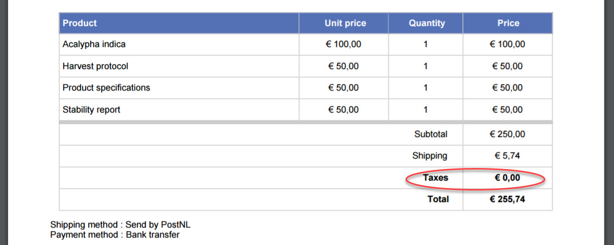

I want to have the name of the tax rate shown instead of 'taxes'.

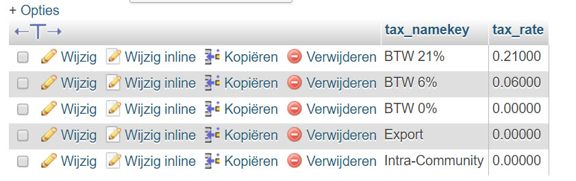

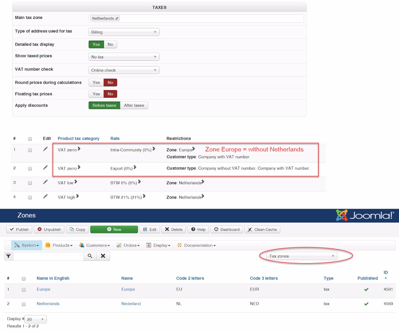

I have two tax rates with different names (for EU- and non EU-Customers) both set to 0%.

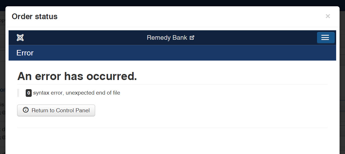

If I do what Nicolas described I get this error:
I hope you can help me with this issue. Since this is mandatory in the Netherlands and Belgium and maybe more EU countries to indicate special text on the invoice to explain that the 0%TAX ar based on Intra-Community Delivery VAT inside the EU or export VAT if it is for customers outside the EU.

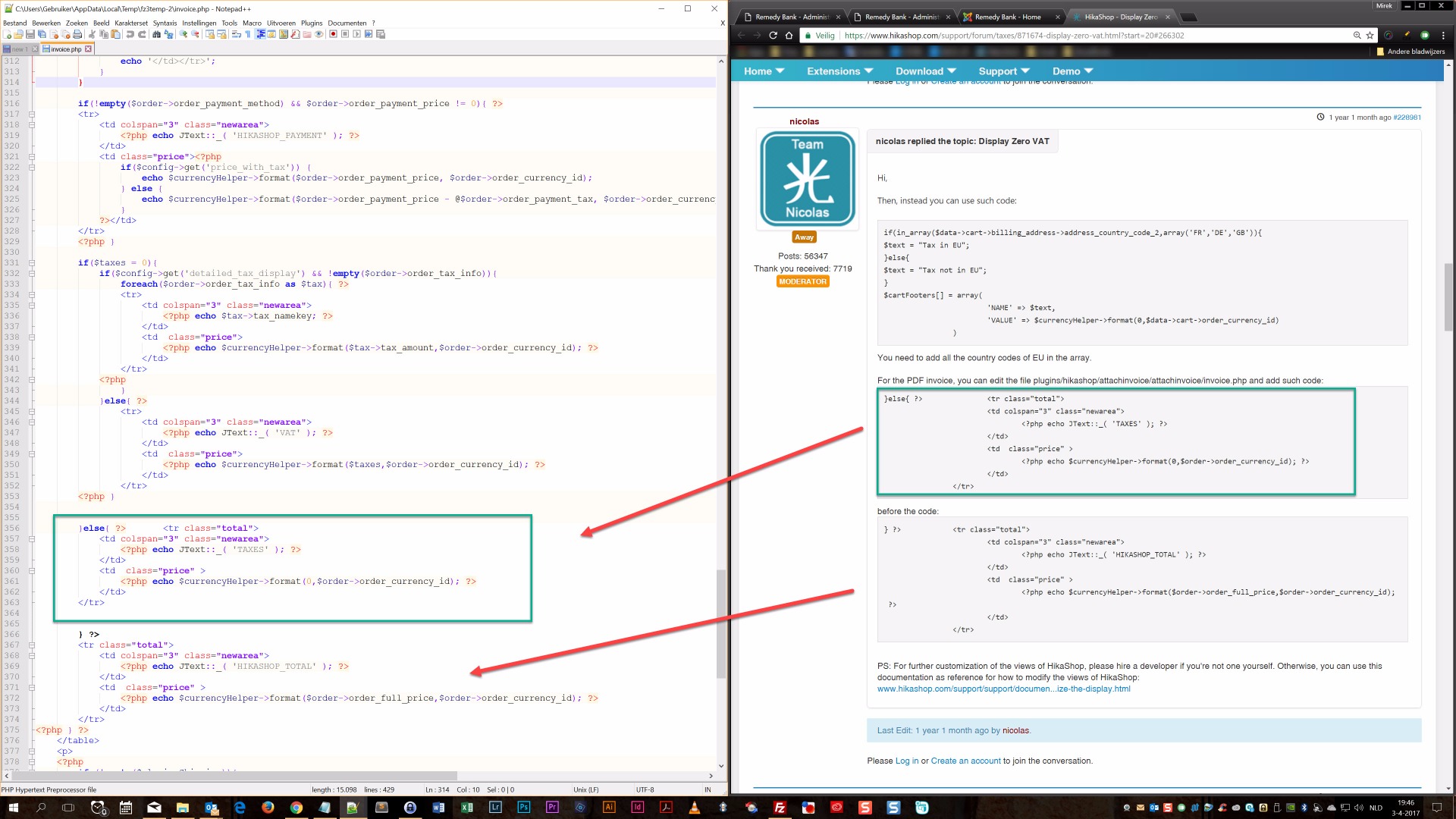

This is what I changed in the code, but as I wrote this give a error.

Yes, the PHP code in your PDF invoice view is incorrect.
And regarding the Nicolas' message, it looks like he copy/paste a part of the code without removing some extra elements.
Please remove the extra
just before the content you pasted.
And please add an extra
<?php
After the code you pasted.

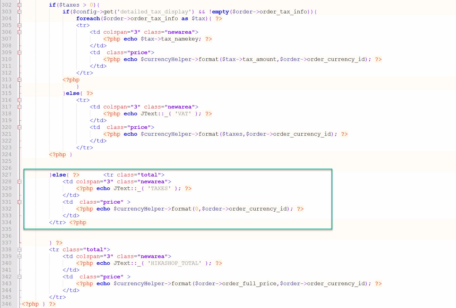

Thanks, I only had to add the <?php after the code
So it's working now. See screenshot:
But I want to have the name of the tax rate shown instead of 'taxes'.
Nicolas provide this code to show the right tax namekey on the invoice but I don't see one of them.
As you can see the code looks like this now (file: plugins/hikashop/attachinvoice/attachinvoice/invoice.php)

If you take a look at the code just above, you will see what you'll need.
Now you can see to just change the condition of the if to always process the code within.

Sorry but I did make a mistake in the configuration of Hikashop.
So the solution is to changing this code from: file: plugins/hikashop/attachinvoice/attachinvoice/invoice.php
if($taxes > 0){
to
if($taxes >= 0){
Now I have a PDF invoice with the right Tax Namekey when it is VAT 0%.
For outside the EU I changed the language override file to "Export - VAT 0%"
So everything is working fine now.
