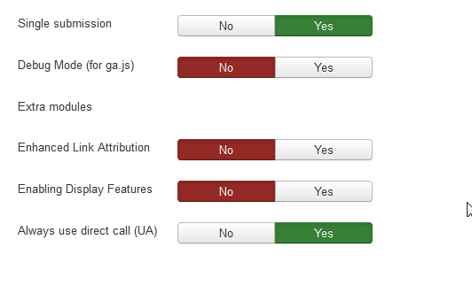

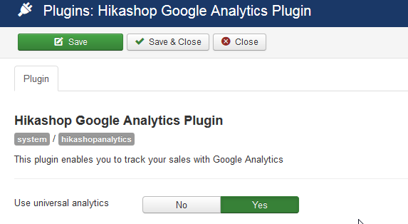

Attached are the settings for the plugin:
What is your suggestion in this case?
