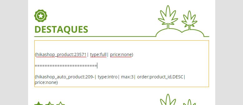

I use the integration with acymailing to create auto newsletters and i've a few problems:
- custom template don't works, i checked and i've the correct hikashop_product.php file but the newsletter show the standard template;

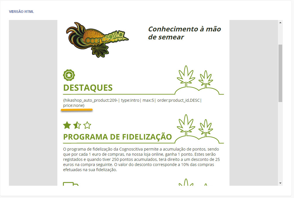

- the tag generator don't works correctly because for example i use the tag {hikashop_auto_product:209-| type:intro| min:1| max:5| order:product_id,DESC| filter:modify| price:none} and the newsletter created show the price.

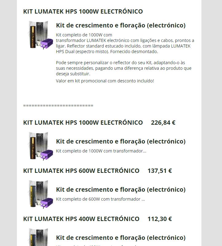

Thanks for you help. The name of the file created by the system is not the correct. The system created a file named hikashopproduct.php
After changed to the correct, now works.

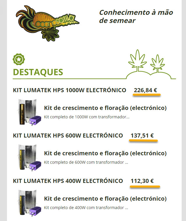

And the second question: why even setting to not show the price in the plugin, the price is showed? As you can see in the print screen, in the tag the "price:none" but after in the newsletter the price is showed.

8 years 6 months ago #288839
In custom template, if i remove the {finalPrice} tag the price is not shown.
Yes, i'm using auto tags for smart newsletters - is very useful in my case.
With normal tags, if is a product tag with price set to none works fine. If is a category tag (for example to put some product of same category) the price set to none don't works (the price is shown). So, the problem is with category tags.
