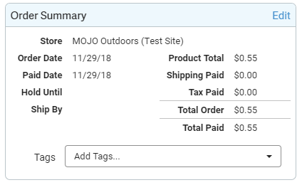

I successfully setup the ShipStation plugin with our shipstation account. However, after a few test orders, i noticed that shipstation isn't showing the tax, but rather the order totals. Is there any way to split this out when they show up in ShipStation?
For this test case, the product was $0.50 and tax is 9.99%, so order total is $0.55. In shipstation it shows $0.00 for tax and $0.00 for product total.

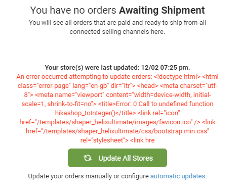

7 years 9 months ago #301145
That broke the integration between hikashop and shipstation. Shipstation not updating now.

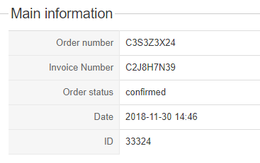

7 years 9 months ago #301148

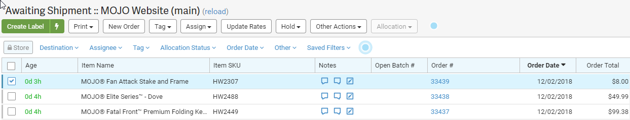

Also, I wanted to report that the "order number" that is reported inside ShipStation does not match the order number in Hikashop and is very confusing. Is there any way to fix that as well?
I believe it is importing the "Order_id" instead of order number. Maybe this should be an option inside the plugin?
Last edit: 7 years 9 months ago by mojooutdoors-holden. Reason: added additional screenshot and explanation
7 years 9 months ago #301194
With this message, you will find the same update version but with some correction inside the XML, I had made a little mistake.
I tested myself this version and it seems that it work but I waiting news from you.
Second step, unfortunately I won't be able to satisfy your request, to explain you why, it's because we switch order id and order number.
<Order>
<OrderID>' . $order->order_number . '</OrderID>
<OrderNumber>' . (int)$order->order_id . '</OrderNumber>
because when Shipstation update your order on your website, the notification will only contain the OrderNumber
And HikaShop works for security question with the order id.
Sorry for this return.

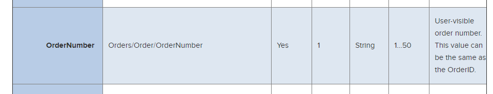

According to their Custom Store config page, it seems you can use Order_number or Order_ID?
https://help.shipstation.com/hc/en-us/articles/205928478-ShipStation-Custom-Store-Development-Guide

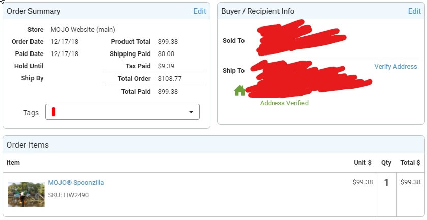

Tax import into shipstation is still broken. Currently, it shows the correct tax, but the unit price = unit price + tax (see screenshot).
In that screenshot, the unit price should be $89.99 and tax is 10.44% or $9.39 in this case.
Therefore product total should be $89.99, tax should be $9.39 and Total Order/Total Paid should be $99.39.

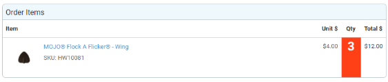

There still seems to be an issue with the Tax and ShipStation. Currently, it sends the tax to shipstation on a per unit basis. For example, if i have 3 x the same item, it only shows tax for one of the items.
Screenshot of what I'm talking about:
Let me know if I need to elaborate more.

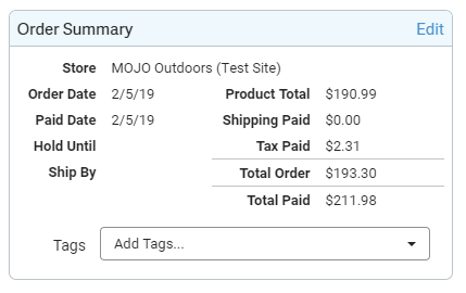

Now it is only calculating the total tax for one product. I have 3 units of one product and resulting tax is $2.31 (correct) but it doesn't show the tax of the other item in the order.
I would've thought there would be a simple call to the total tax within hikashop? For example, the order page on hikashop backend shows the total tax for an order?
