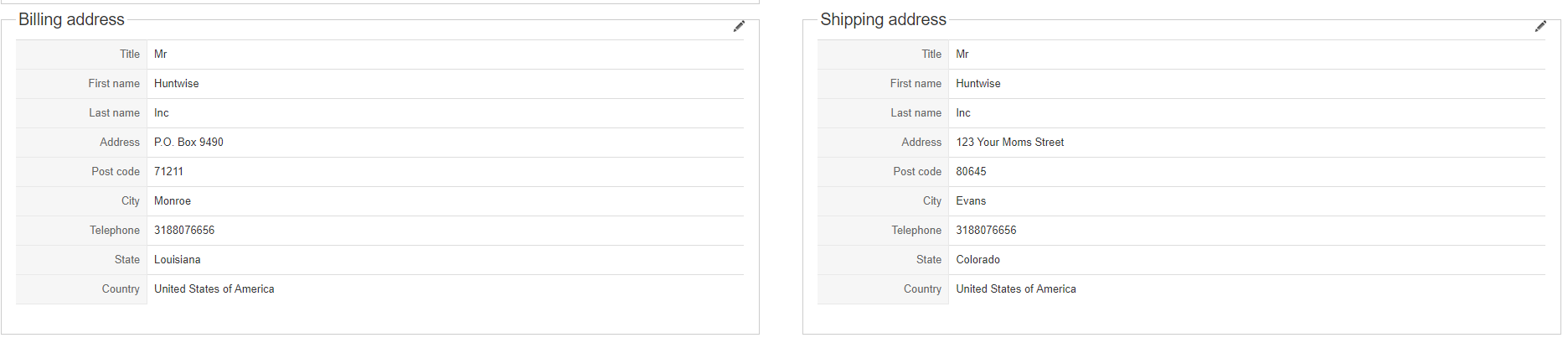

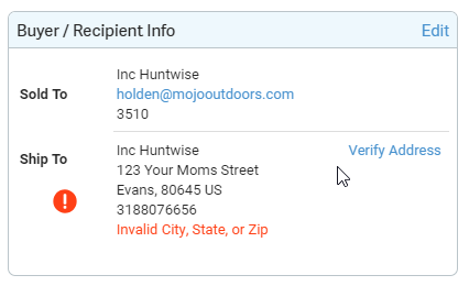

See the attached screenshots for a test order I made to import into ShipStation. Some of the states don't import properly and sometimes the city doesn't get carried over either?
Order details in Hikashop:
Order imported to ShipStation:
Any thoughts on this? I checked the zones config for Colorado and I noticed it didn't have a two letter code (which most states don't). I added it hoping it would resolve this issue. Sadly, it did not.
Orders display properly in HIkashop order details but don't seem to always transmit the correct info?

7 years 9 months ago #301211
Also, seems to be importing the name as "Last Name" "First Name".
It messes up the display for most everything. Should be "First Name" "Last Name"
