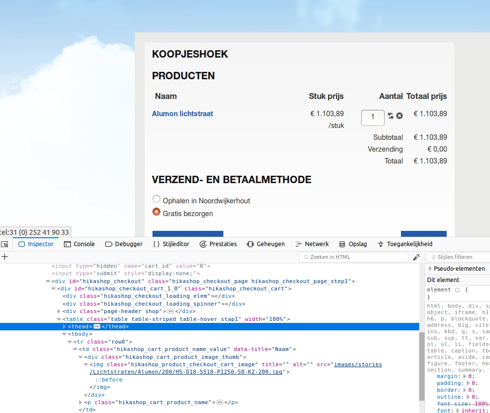

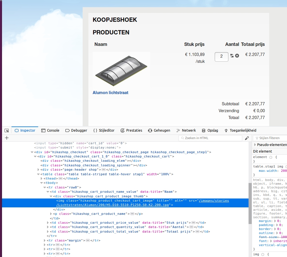

  • Posts: 9
7 years 8 months ago #301988
The img tag is still there. The only difference in the HTML aera is the code
::before
See enclosed screenshots.
Best regards,
AdK
  • Posts: 86183
7 years 8 months ago #301991
Since the HTML is there, it means that there is some CSS code hiding it. Check the CSS of the HTML img tag with the browser inspector or maybe its parent, or its parent, etc until you find which one is being hidden by the CSS.
