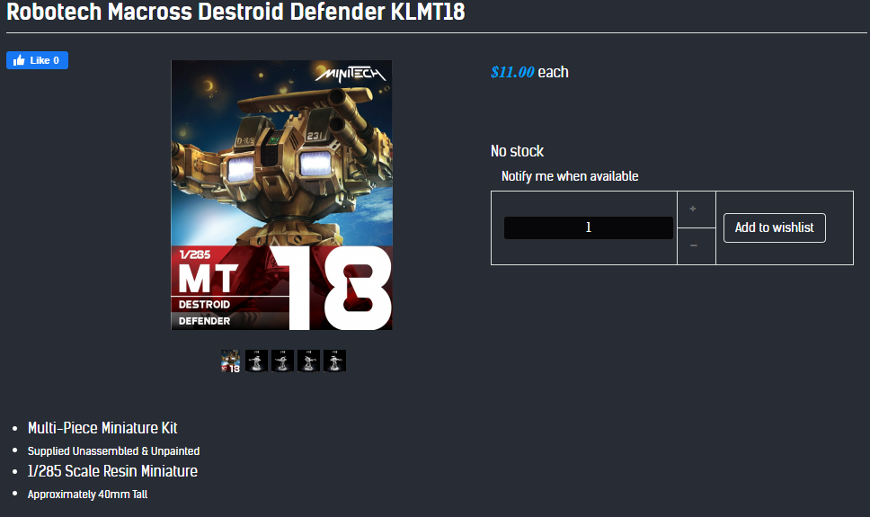

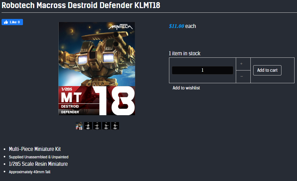

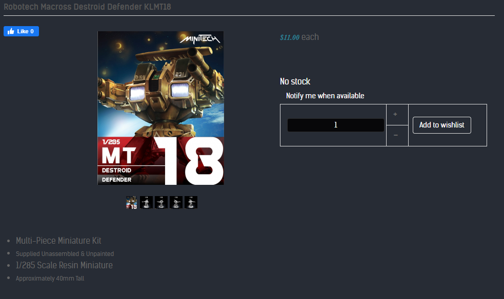

Need a little help with the Pre-Order Extension from Obsidev.
I purchased the extension, and tried to update everything...it "works" but does not display properly.
  • No matter the amount of items I set for the pre-order stock (except 0 quantity)...it shows as if I actually have stock.
  • When there is a pre-order stock filled in, my add to cart button shows up, NOT pre-order button
I've shut off the custom CSS I had running, made sure legacy cart & checkout were set to no, and it still didn't work. So I tried the default css, and none for css, and also my custom css setups and it doesn't work. I've tried turning on legacy cart & check out, still doesn't work. I need this working ASAP.
Please see the screen shots as listed below:
  1. 1 Item for Pre-Order Stock - Custom CSS
  2. 1 Item for Pre-Order Stock - Default CSS
  3. 0 Item for Pre-Order Stock - Custom CSS
  4. 0 Item for Pre-Order Stock - Default CSS

This means that you must have some view overrides in your template.
Rename temporarily the folder templates/YOUR_TEMPLATE/html/com_hikashop via FTP and that will deactivate all the view overrides in your template. The text on the button should then change properly indicating that the problem comes from onew of the view override files in that folder. So you can rename back the folder and then rename each file in it one by one in order to identify the culprit.
