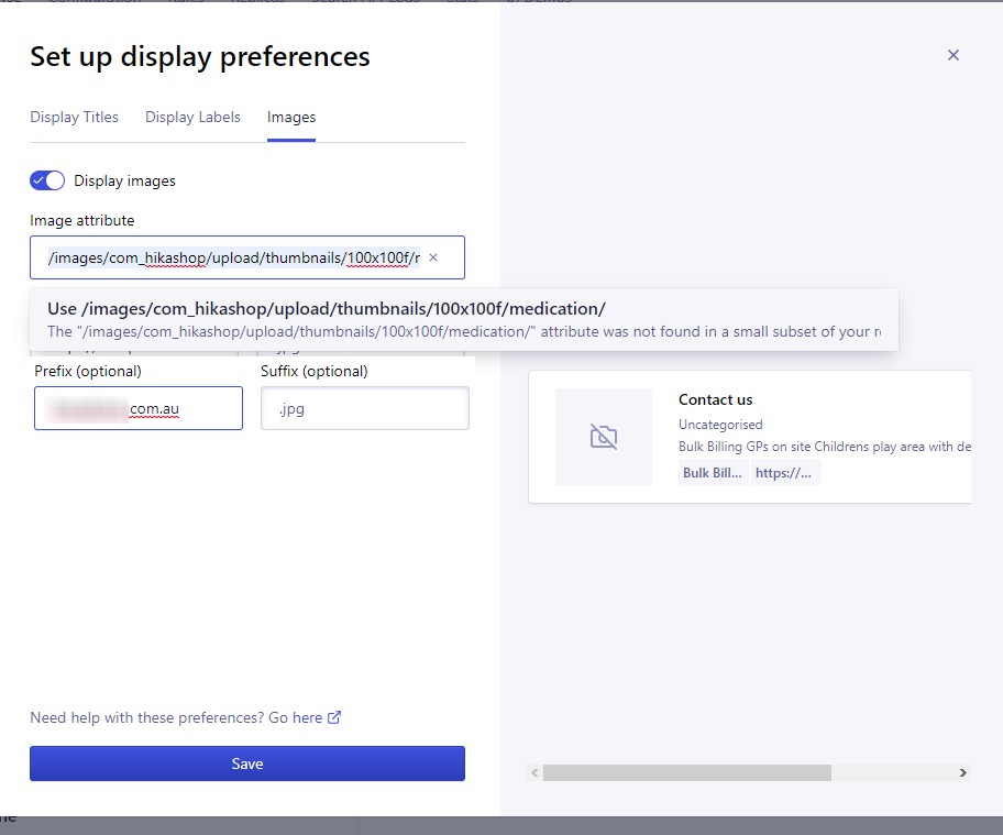

we installed the listed search integration (XT Search for Algolia) to get images in the search suggestions but can figure out how to tell algolia what the image field is. Attached are some pictures of their set-up. Hopefully you can tell us what to enter for the field information. It's quite expensive, so we don't want to keep it if images can't be displayed and they bounce you back to your own tech support for problems (which is me)..

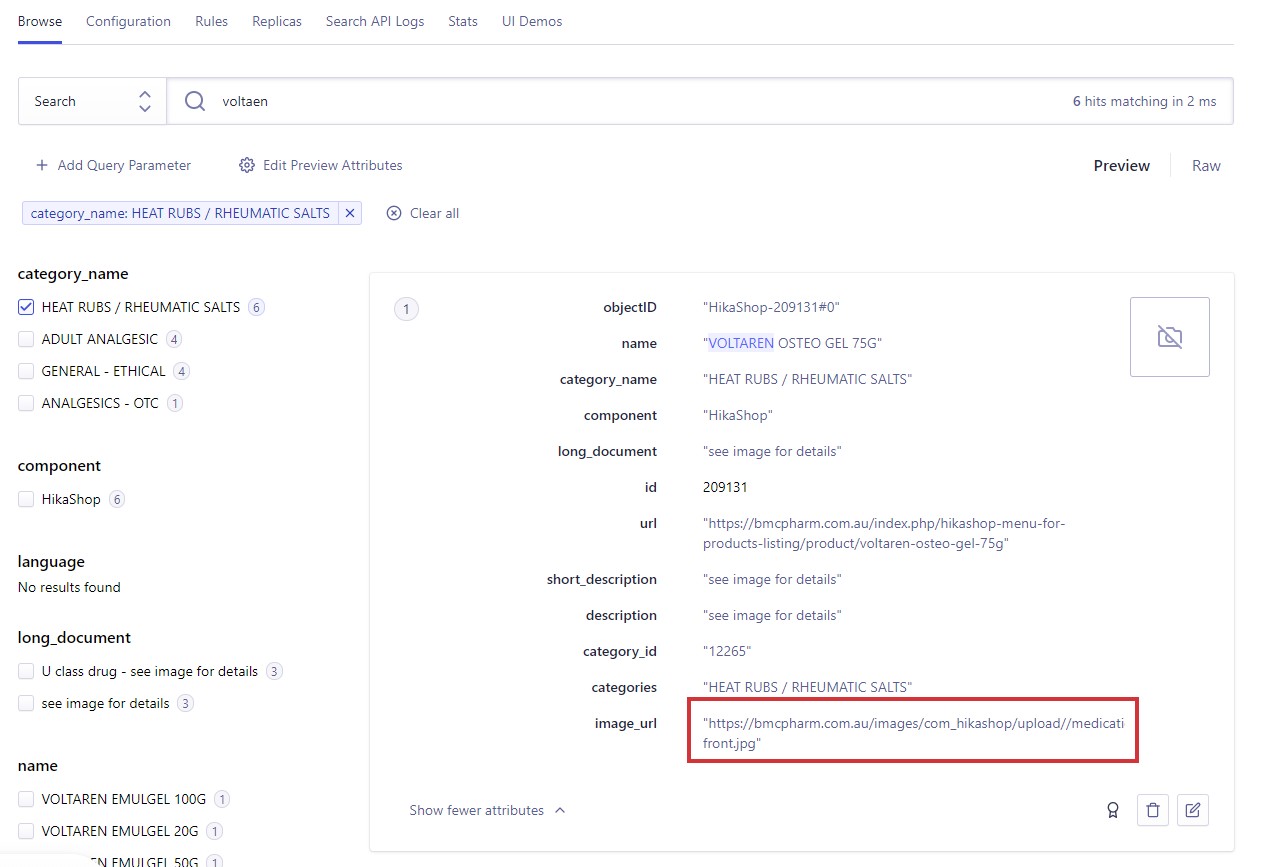

edit: Algolia seems to find the information but can't use it. There's and extra slash in the image url. Here's the record data;
"component": "HikaShop",
"id": 209130,
"url": " nameremoved.com.au/index.php/hikashop-me...steo-gel-12hour-150g ",
"name": "VOLTAREN OSTEO GEL 12HOUR 150G",
"short_description": "see image for details",
"description": "see image for details",
"category_id": "12265",
"category_name": "HEAT RUBS / RHEUMATIC SALTS",
"categories": "HEAT RUBS / RHEUMATIC SALTS",
"image_url": " nameremoved.com.au/images/com_hikashop/u...0130317284-front.jpg ",
"update_date": "3349-09-20 16:00:49",
"update_date_timestamp": 43539782449,
"long_document": "see image for details",
"objectID": "HikaShop-209130#0"

Note that the issue is not the extra slash. If I remove that extra slash, the URL is still invalid.

it started working when I used their default field entry value ('image-url' ) in the module. I thought that I needed to provide a field value for hikashop images.
