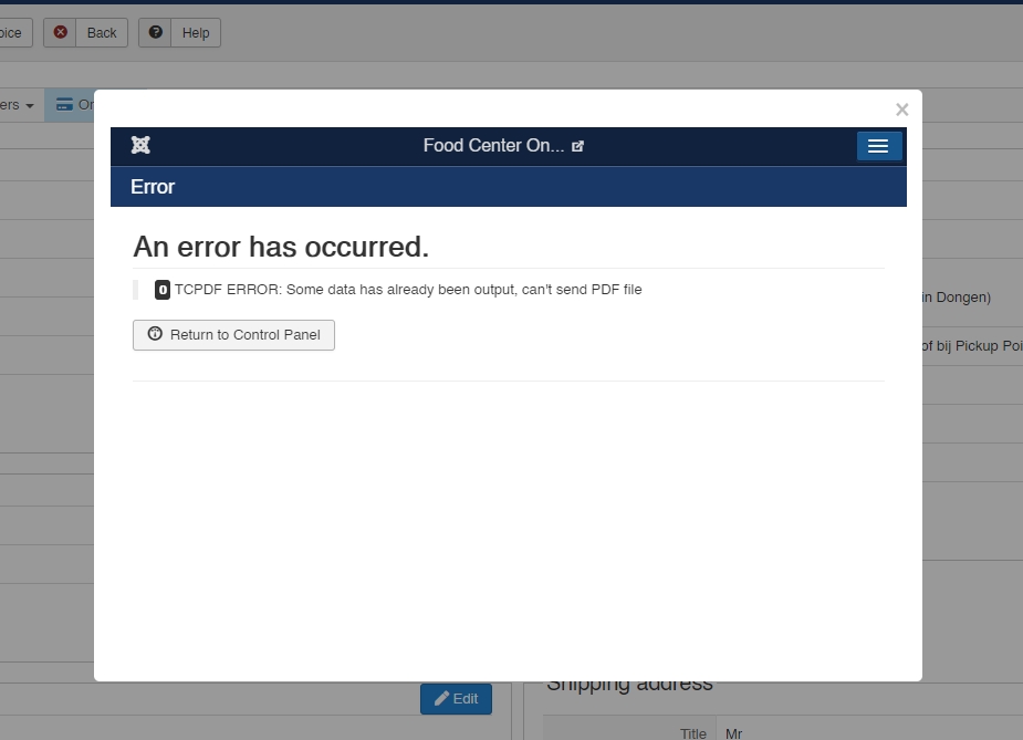

I installed the Attach Invoice plugin, but when I click "Invoice" or "Shipping Invoice" in the order I get an error: TCPDF ERROR: Some data has already been output, can't send PDF file
Also on all the other locations where the PDF invoice can be generated, I get the same error.
Hope you can help me with this problem!

This means that a notice or warning has already been sent to the browser before the plugin generates the PDF.
If you turn off the "error reporting" setting in the Joomla configuration is should prevent the problem.
Now the question is where is this notice/warning.
And that's hard to say as the notice/warning is not displayed because of the error from the TCPDF library.
The notice/warning should be logged in the error log of your PHP. So the best would be to monitor that log while you reproduce the problem.
What you can try is to add the code:
ob_clean();
before the line:
$html2pdf->Output($fileName.'.pdf','D');
in the file plugins/hikashop/attachinvoice/attachinvoice.php
That should remove the notice/warning message from the ouput buffer which should prevent TCPDF from stopping and displaying that error.
