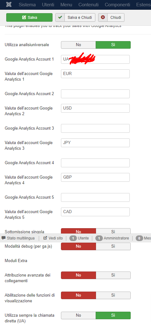

5 years 8 months ago #328557
by Jokingmind
Replied by Jokingmind on topic GA4 integration
Attached the plugin configuration.
The Id is changed and now it links to the stream measurement ID.
If I put the Account ID (that isn't prefixed with UA anymore) I'm still not able to fire the event.
The event I'm trying to fire is the add_to_cart
As said, I'm using Google Tag Manager to create events and triggers.
Here a link to GTM guide (maybe it helps)
developers.google.com/tag-manager/ecommerce-ga4
Thanx
Davide
Thanx
Davide

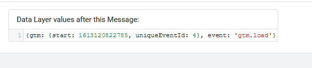

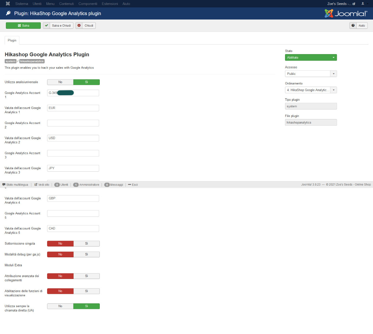

5 years 7 months ago #329500
by Jokingmind
Hi again.
I'm try to implement your plugin. What I've done
- Activated a UA property wit standard e-commerce enabled
- Created a Tag with GTM that fires when user reach confirm page
Question: is the confirm page the page where the plugin send the Data Layer to GA?
Below the plugin config and the data layer shown by GTM
Thanx
Davide
Thanx
Davide
